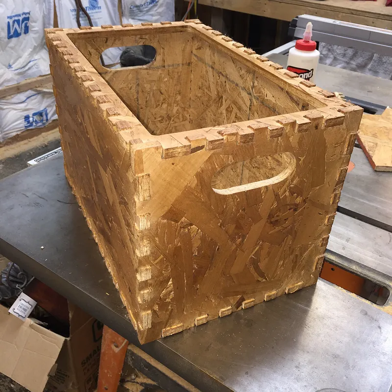

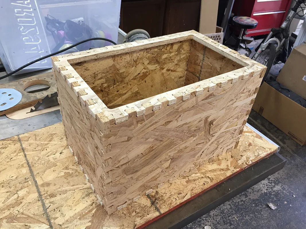

This is a 10" x 16" box designed to cut in one piece of 7/16" material on a 1 square meter X-carve. The example was cut in 7/16" OSB. Stained a bit with Briwax (this might work better if done before assembly). The bottom is split into two pieces to optimize material usage and to fit in 800x800mm.

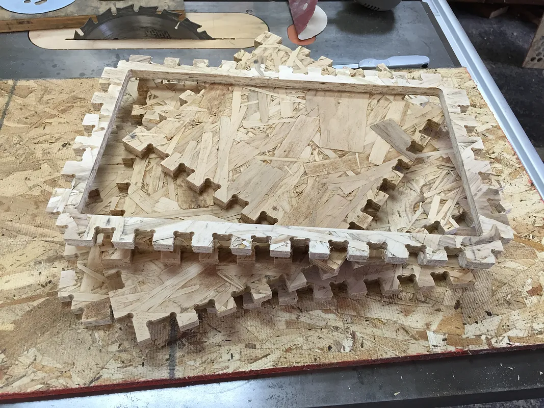

Feed your X-Carve an 32"x28" piece of 7/16" stock.
Fit a 1/8" bit (down cut if you have one).
Cut it out.
Clean up the tabs.
Glue it together. A brad nailer makes glue-up easier.
