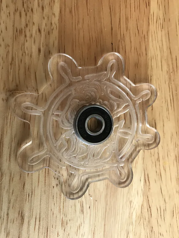

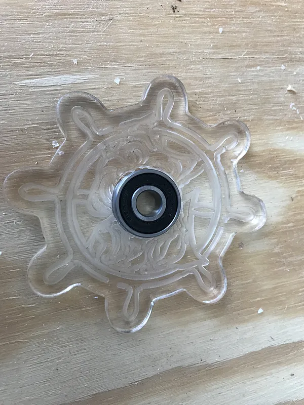

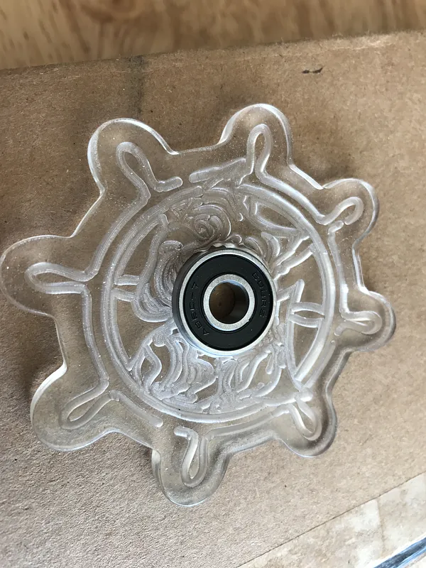

I used a 1mm bit but set the bit for Easel to carve as 1/64". I was also adjusting to smaller numbers (1/75, 1/100) to gain additional detail. If you want to reduce the outer size, adjust with the apps/utilities/offsetter function and reduce the size inward.
Cast Acrylic
