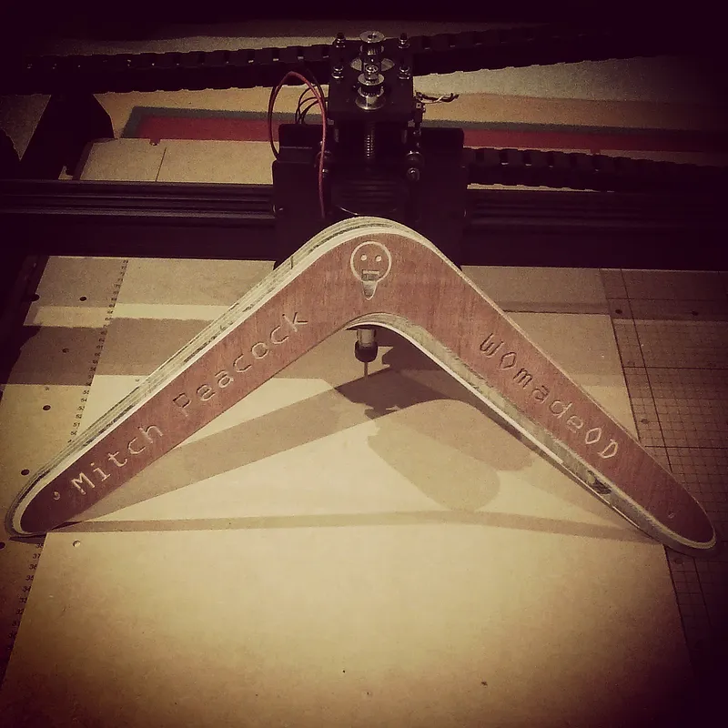

Secure the ply to the waste board (you can add a sacrificial wasteboard to save damaging the main one, since through holes will be bored), avoiding tool paths.
Carve the 'Top' side (http://easel.inventables.com/projects/E9_B6qXc9qOYPxGpKFK82g).
Remove the ply and turn it over.
Insert 6mm dowels (or similar pins) into the two alignment holes that were bored into the wasteboard.
Align the flipped ply, using the dowels, and secure it.
Carve the 'Back' side (http://easel.inventables.com/projects/yWDbkEVnXPXk2ReA8kyrOw).
Optional: Make copies of the easel files and add text and/or logos to a depth of <1mm. Delete the boomerang paths, and then carve your designs on the boomerang.
