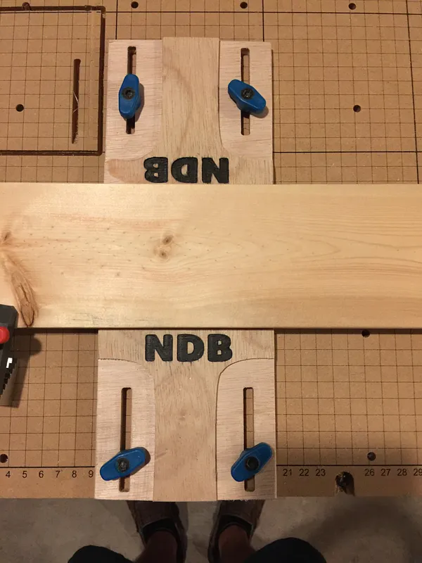

Side clamps that don't require pressure from the top, leaving the whole work surface open for carving. Spans 2 holes in width, works great xcarve green clamp screws. Not tall enough for 2 holes front and back, may have to extend if projects aren't fitting between a set.

I made a set of these about 6 months ago. I used a Bamboo cutting board from dollar tree to make them. Super hard and durable. These clamps have been indispensable! Nice job!

Thanks... Adjusted the holes for 2 inch spacing. Nice clamp.
