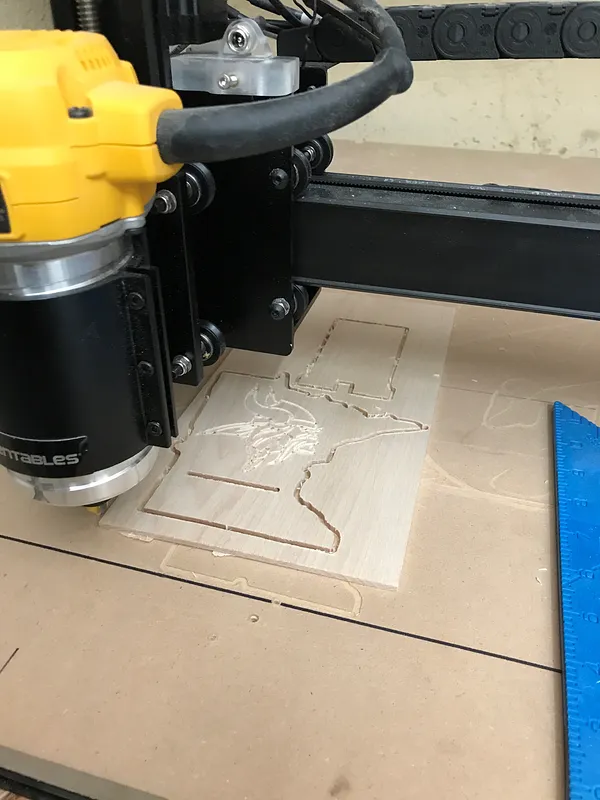

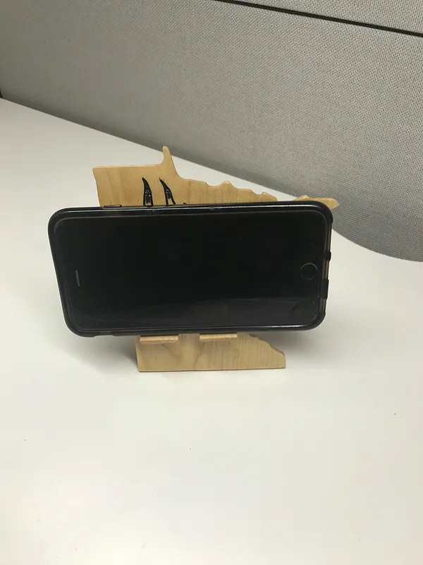

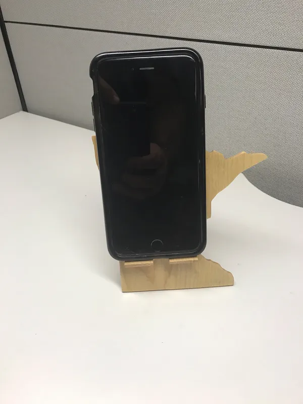

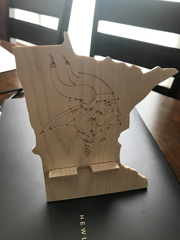

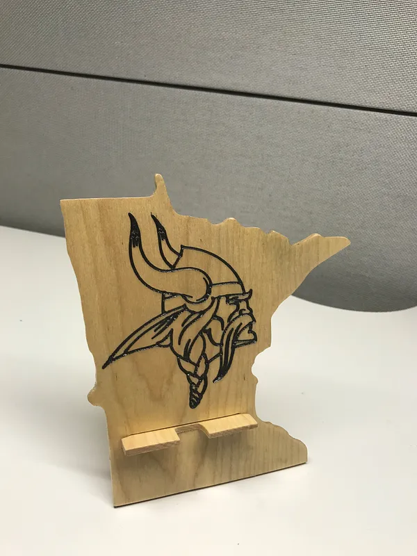

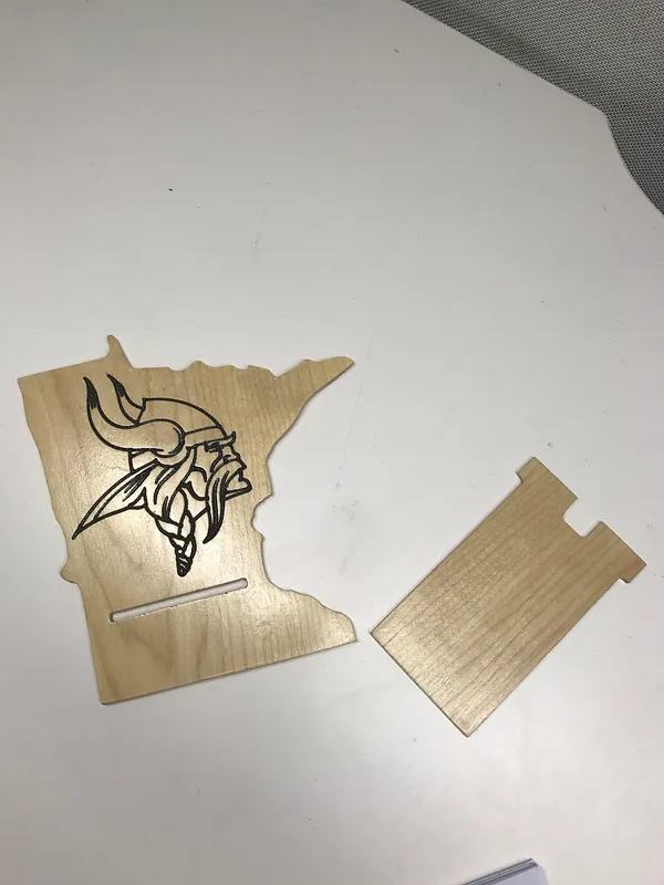

Cellphone stand, made as a gift for a coworker. My Coworker is a huge Minnesota Vikings Fan hence the Viking cut using Easel's new V bit Carving feature. This is a simple design that works great and can be modified to an shape you desire.
Nice Douglas. Can you tell me how you painted the cut path without the paint bleeding across the edges? Do you use a thicker acrylic paint and sand after?
Randy Estes · December 12, 2017
Hi Randy. I put a couple coats of semigloss minwax spray polyurethane and let it dry to seal the edges, then I sprayed two coats of standard black spray paint and sanded. It worked great.
