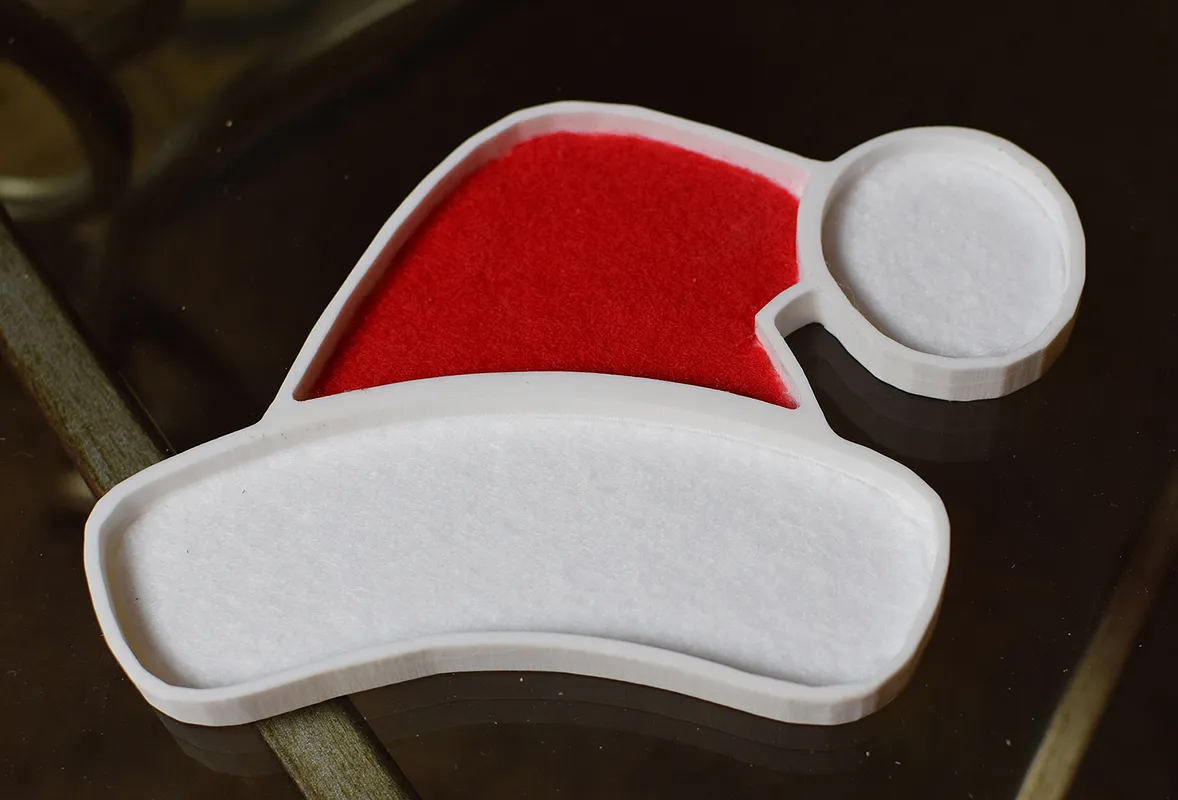

I used the following settings for Easel. 1/8" Solid Carbide 2 Flute Straight End Mill .06 depth per pass 30 imp
Set your zero and press carve!!!!! I used red and white adhesive backed felt from the local craft store to line the pockets.
