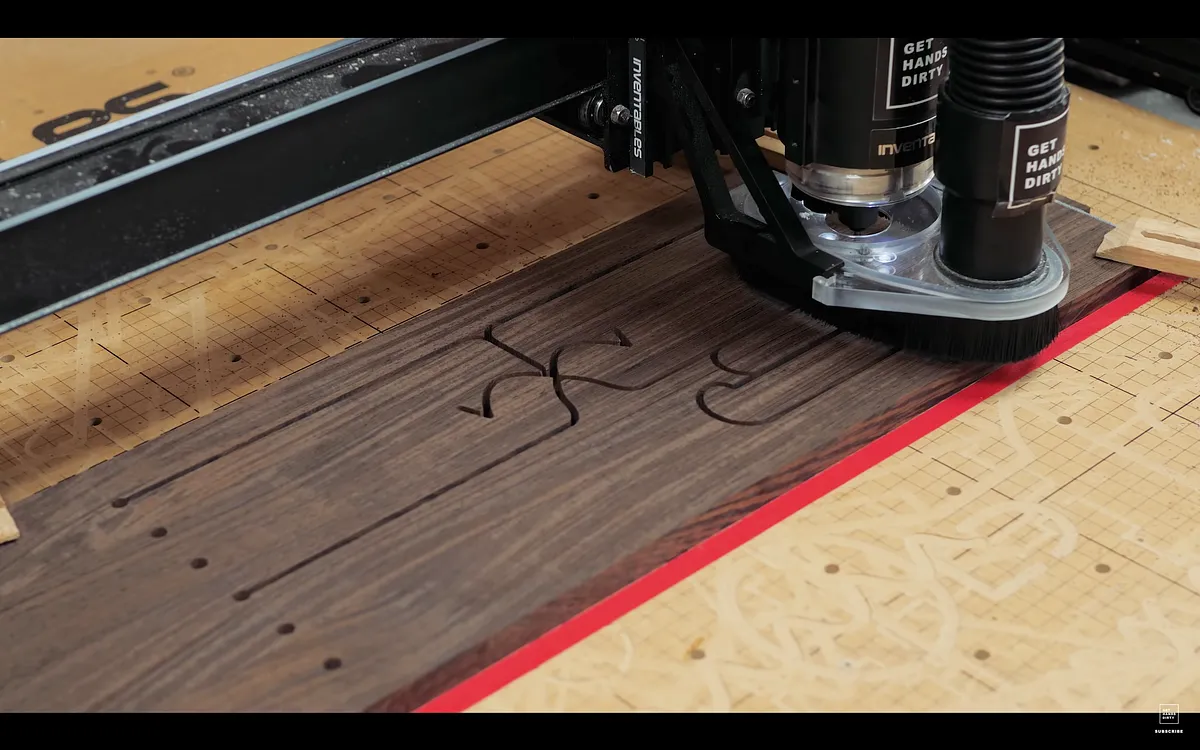

Easel shows it being 10 by 4. What is the actual size?
garrett effley · December 04, 2019
Hi Garrett, the top is 59 x 20 cm. You can set Easel to show MM instead of IN if you prefer.

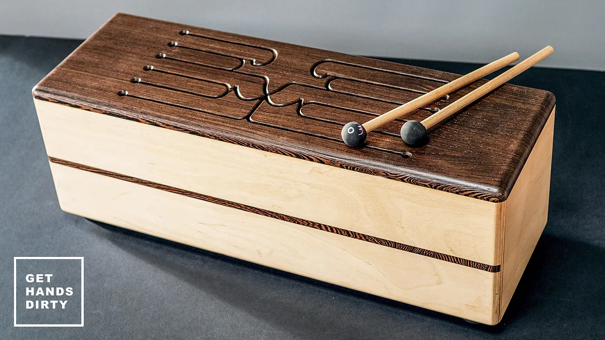

This is beuatiful! Really High quality craftsmanship! I want to make one and love the size in the video. Can you tell us the overall dimensions? (L x W x H).

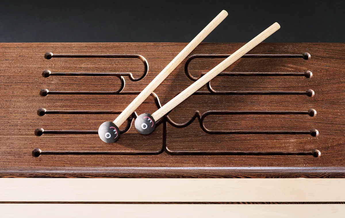

I've noticed that there are only ten tongues. Do you know of a version that has twelve tongues (full chromatic scale in major or minor key) or an alternative . Thanks. BTW It sounds great. Love to hear it with a Fishmans piezo pickup stuck inside. WcW

what is the height of the box? and is there a sound hole? if so what diameter would that be? i assume all of those factors would effect the tone
