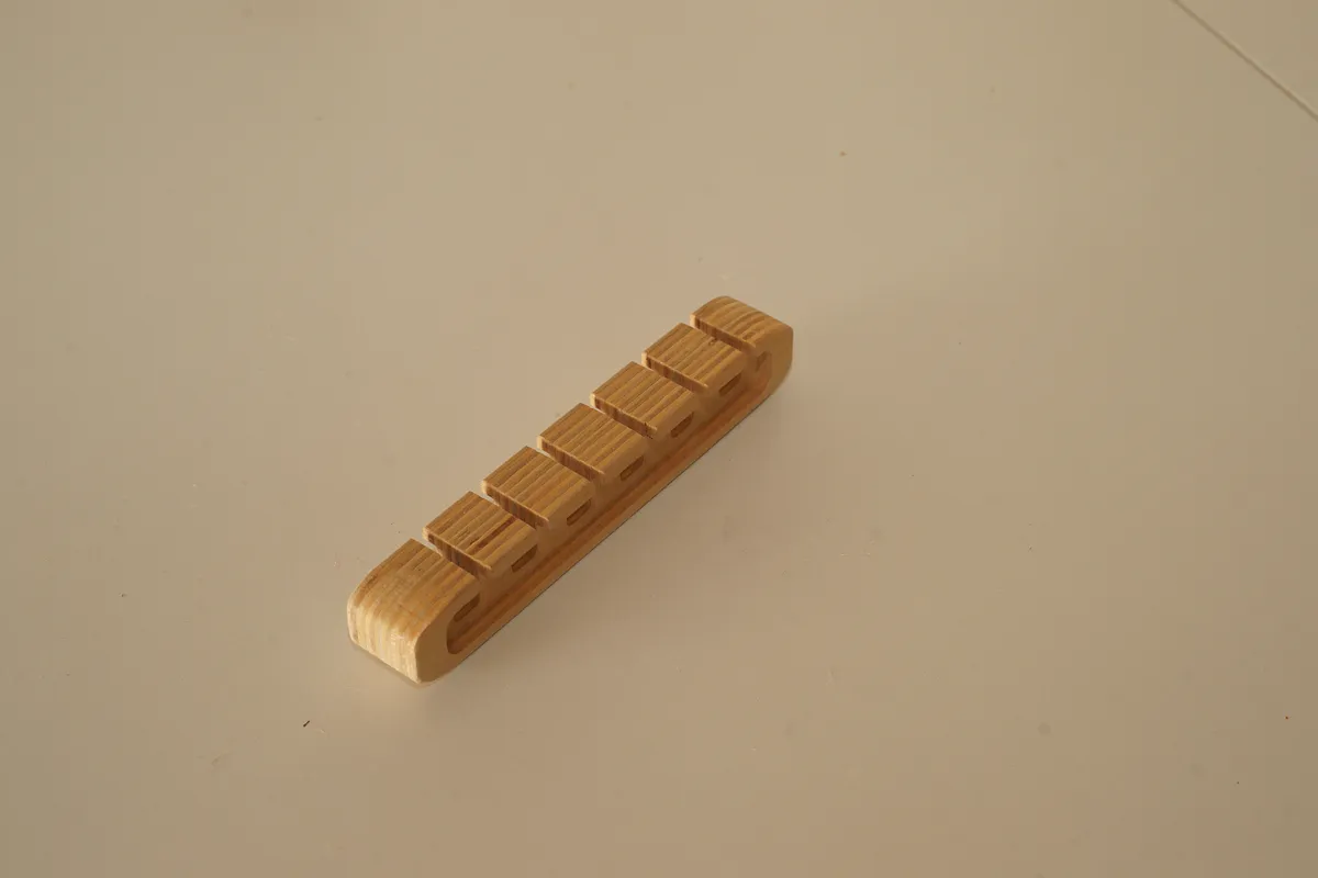

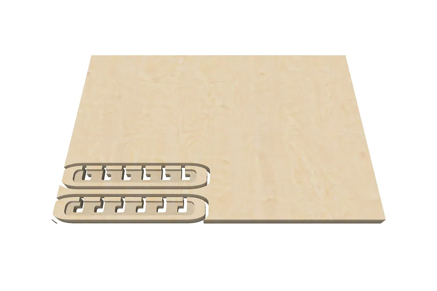

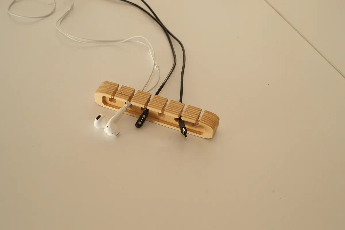

This desktop cable organizer has two mirrored parts cut from 10-12mm plywood; thickness isn't critical. Making two faces gives a finished look on both sides. I drew 3 slightly different profiles and made my favorite. For finishing, use matte clear spray and double-sided tape to attach it.

This is really cool. Did you do this as a two sided carve or did you carve out each piece and glue it together?
Zach KaplanPro · January 15, 2026

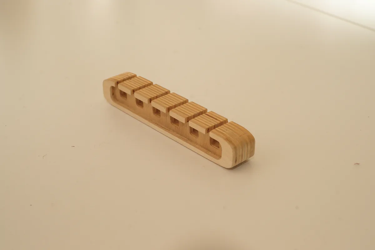

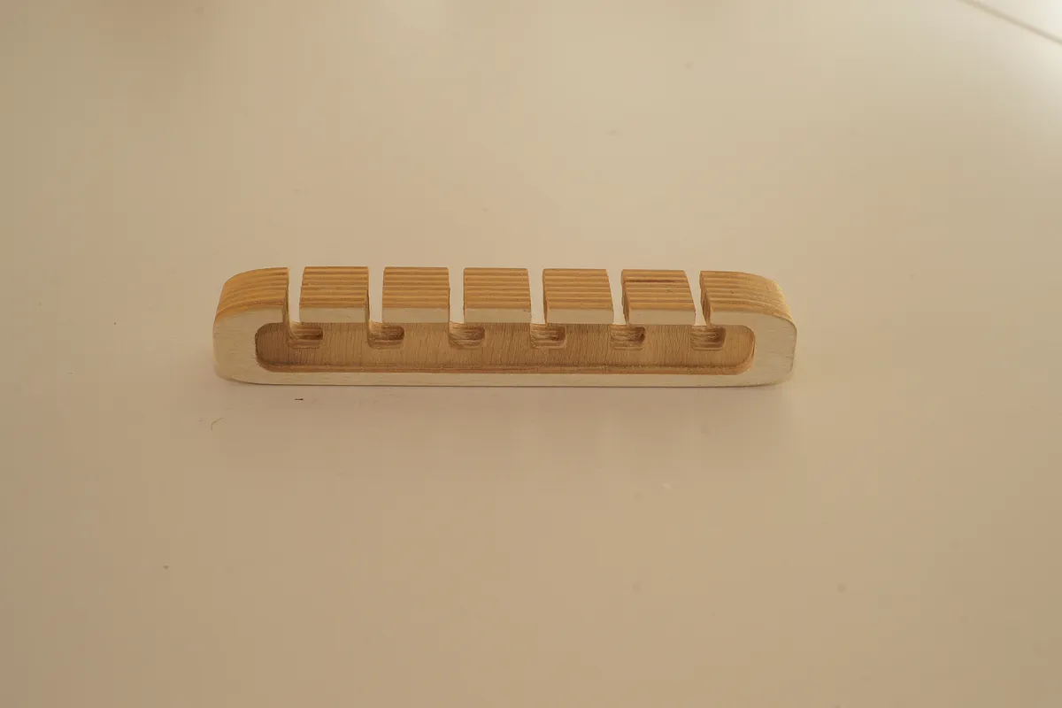

Hi, thank you, it's a pleasure to share an idea with others. They are two halves, glued together; this way I can have both sides finished, without going too crazy! Actually, it would be useful to add a photo of the back side as well to understand better. See you soon
