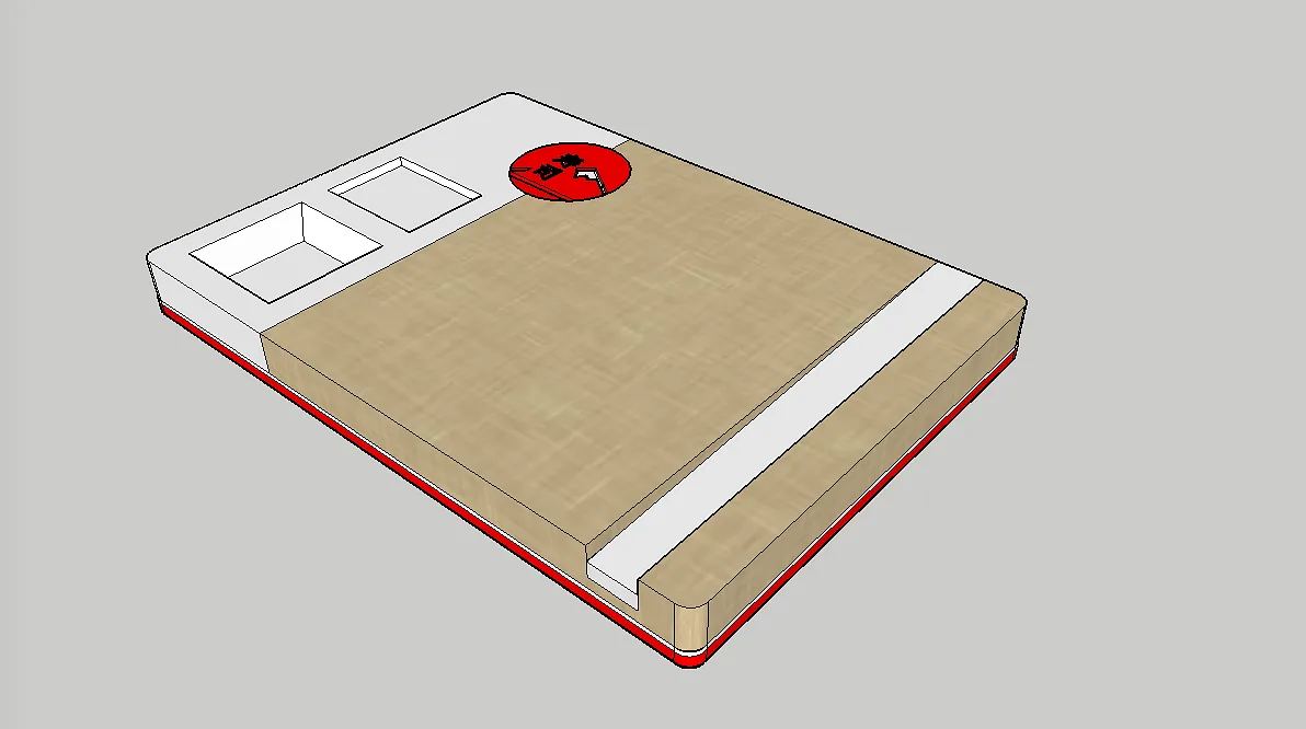

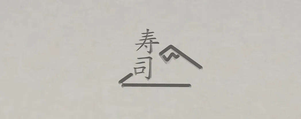

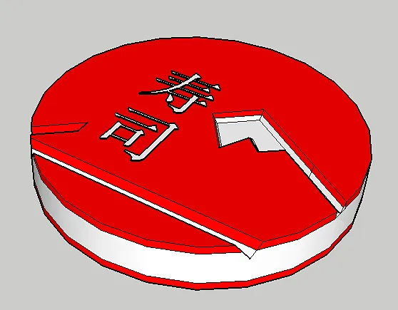

In creating this project the choice and combination of colors, materials, and functionality were important to me. The design of the project was to be relatively simple and modern. I wanted the sushi board to appear vibrant and light, but to also keep its Japanese character. To achieve this design, I chose a light colored wood as well as white Corian, and I added a red circle with Two-Color HDPE (red on white) to give the appearance of the Japanese flag. The red circle is engraved in a way in which the white Corian shines through allowing a Japanese sushi symbol and a simple symbol of Mount Fuji to be seen. There are two carved out spaces in the Corian on the left side of the sushi board which are designed to hold the soy sauce, ginger, and wasabi paste. On the right side of the sushi board, there is a space for a strip of Corian to be attached to serve as a place to lay down chopsticks. The base will be created using Two-color HDPE (White on Red) so to not only function as a stable base for attaching the project’s elements, but to compliment the visual integrity of the project as a whole.

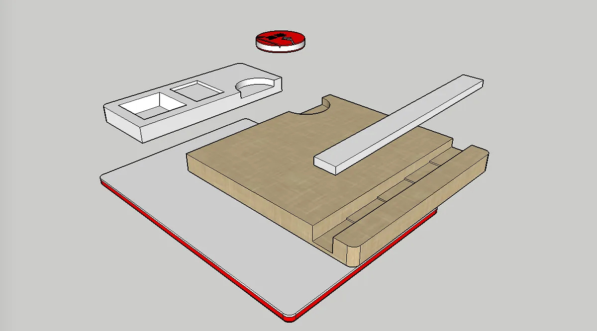

Assembly description

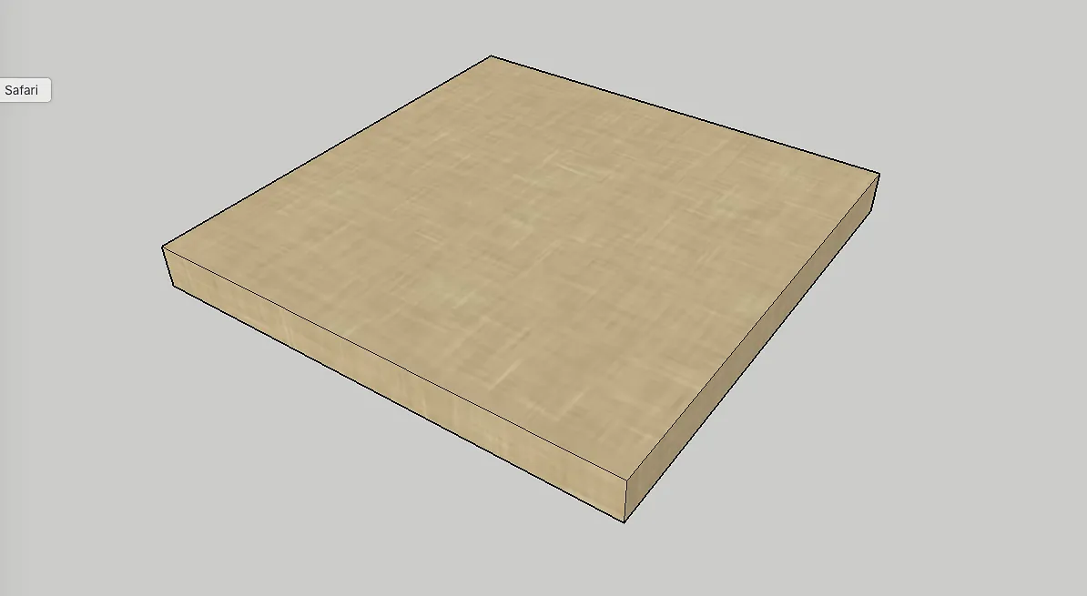

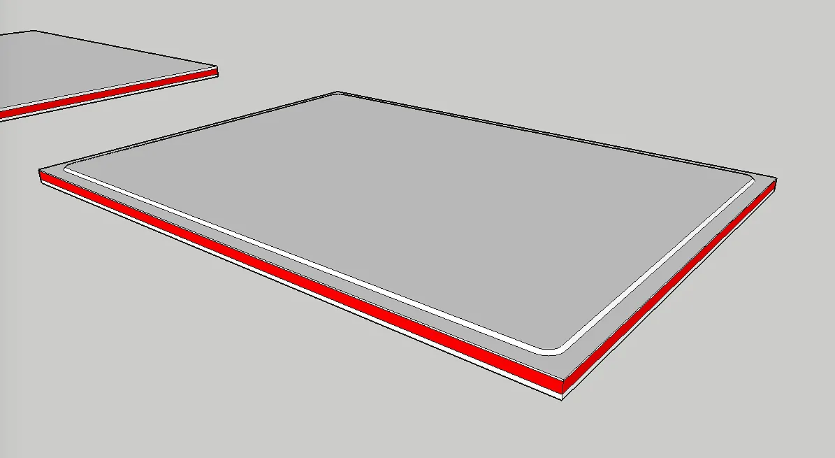

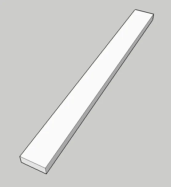

After cutting the X-carve elements, the cut joints should be cut off and any imperfections sanded. The groove made in the wooden element where the Corian strip will adhere should be aligned and adjusted so that the Corian inlay fits easily yet snug. This groove can simply be sanded, if needed, by using a piece of sandpaper wrapped on a wooden block. The left and right elements should be glued to the base. Once these elements are dry, the Corian strip and red circle should also be glue down. If there are any protruding Corian corners or any imperfections noted, these should be sanded with sandpaper. The wooded element should be wiped down and protected with mineral oil (Mineral Oil- food safe).

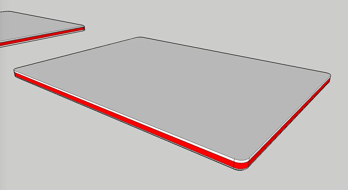

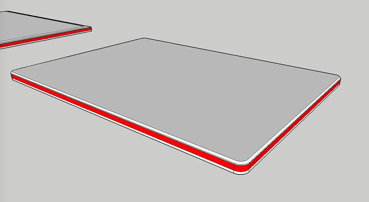

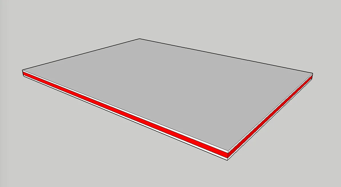

Base
Base - steps

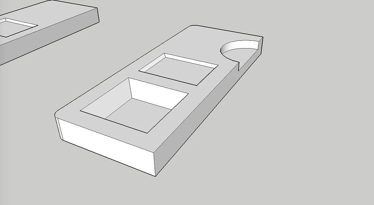

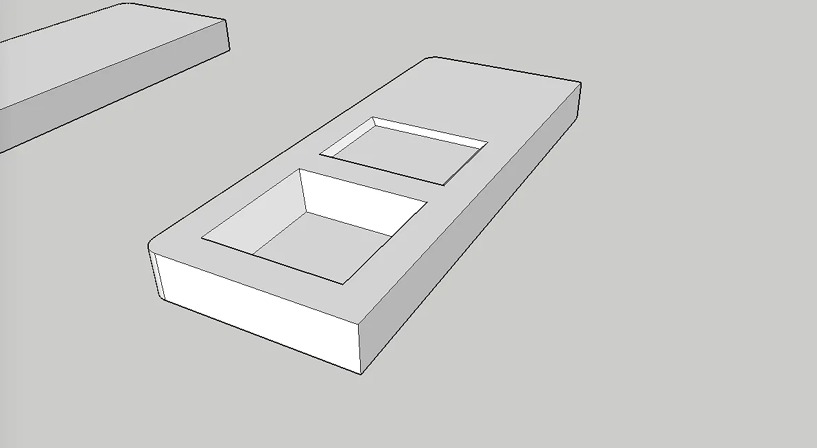

Left part
Left part - steps

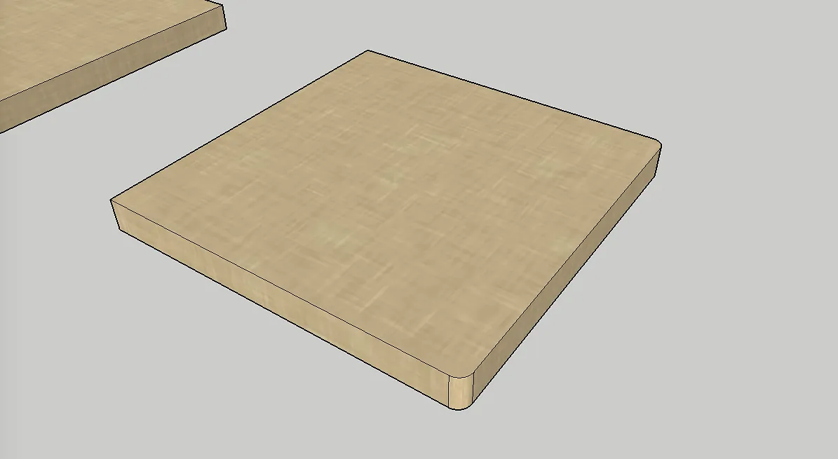

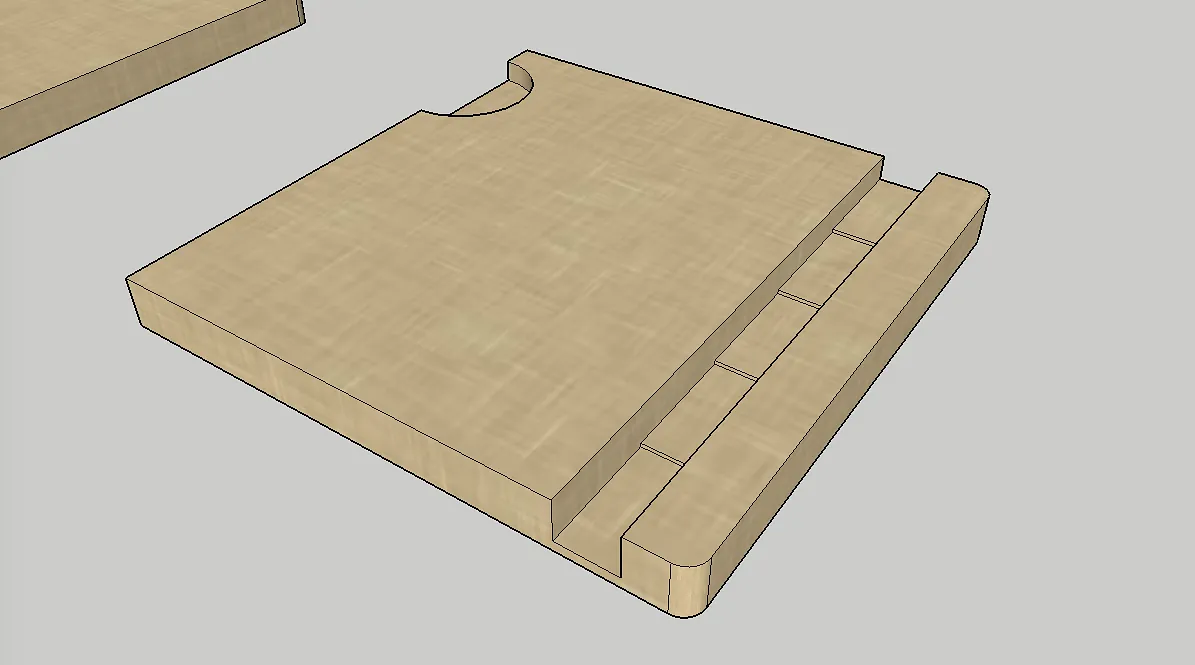

Right part
Right part - steps

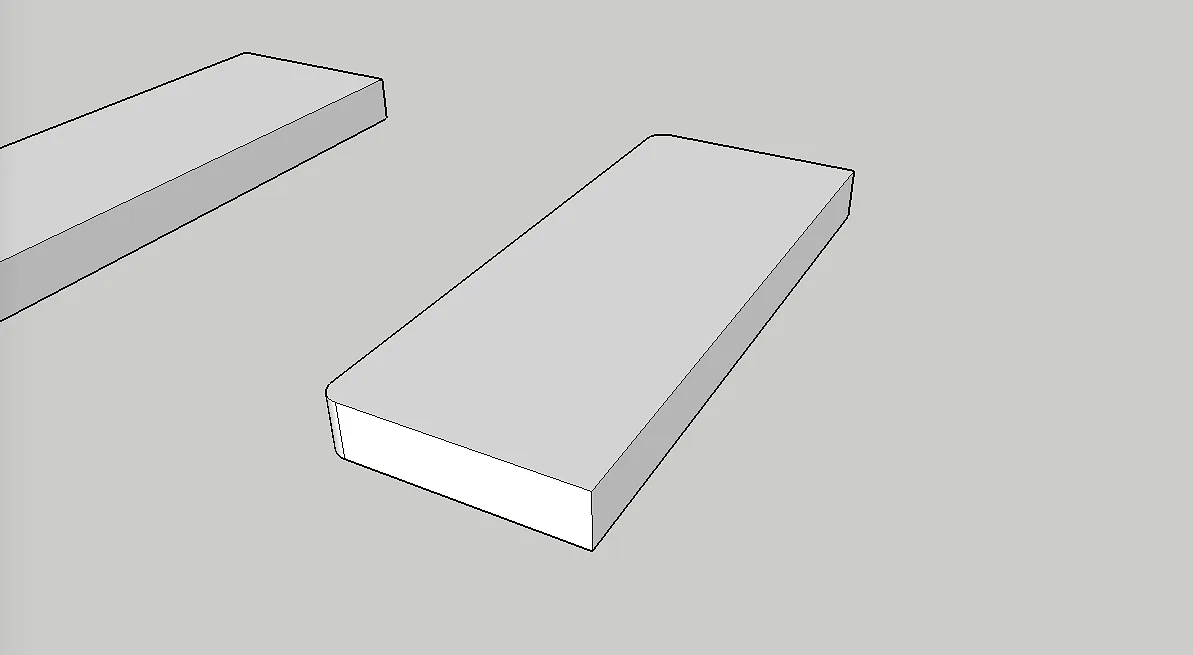

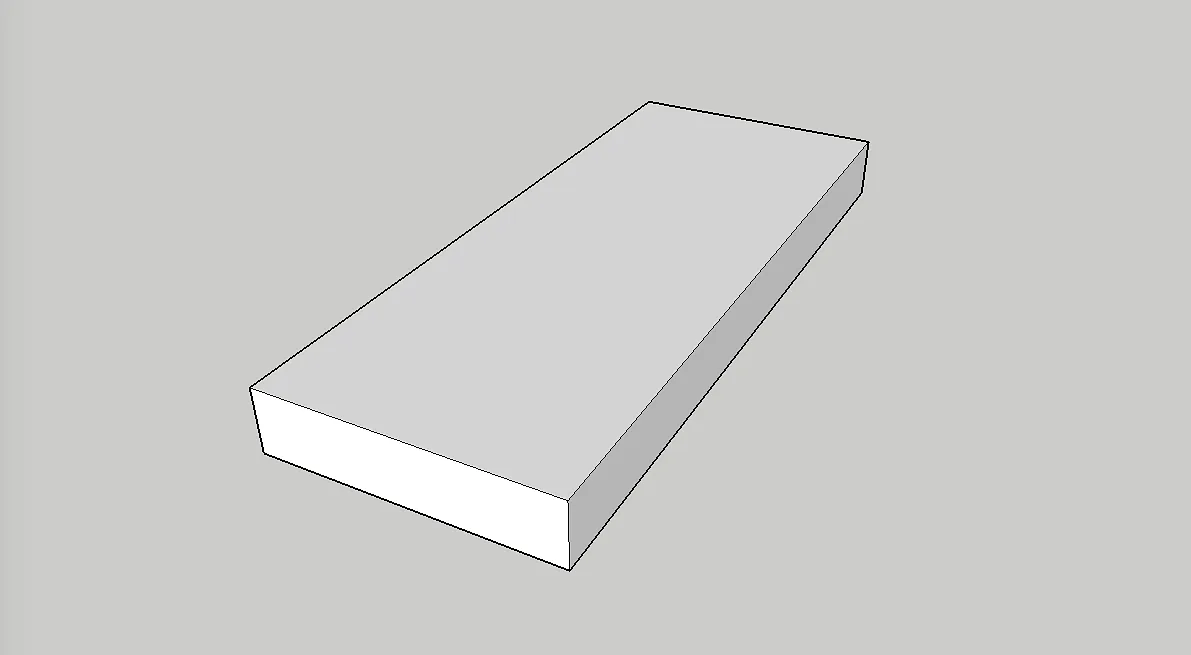

Circle and Corian strip
