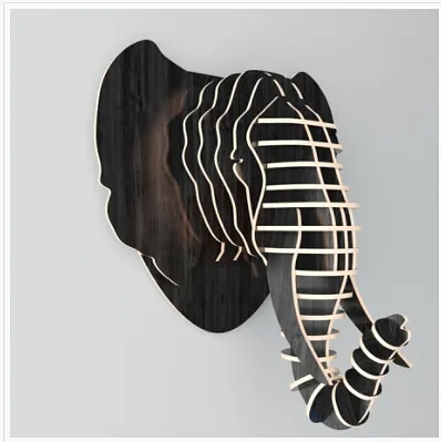

Is there an easy way to change this file to match .475" material?
Lance Fenner · August 09, 2020
Lance -> you can scale up the project by taking the thickness you want the project to be lets call that T divided by the current thickness lets call the CT and time that by the current width lets call that CW.
Andrew Petzold · August 10, 2020
this will get you the new width to scale the project too. T / CT * CW = new width 8/10/2020
Thanks Andrew! I tried to increese the scale factor by two to make the slot thickness .475" but it made the ear sections so large that it would no longer fit my CNC. :( I'll keep playing with it. Thanks for the help and the cool file!!!!
