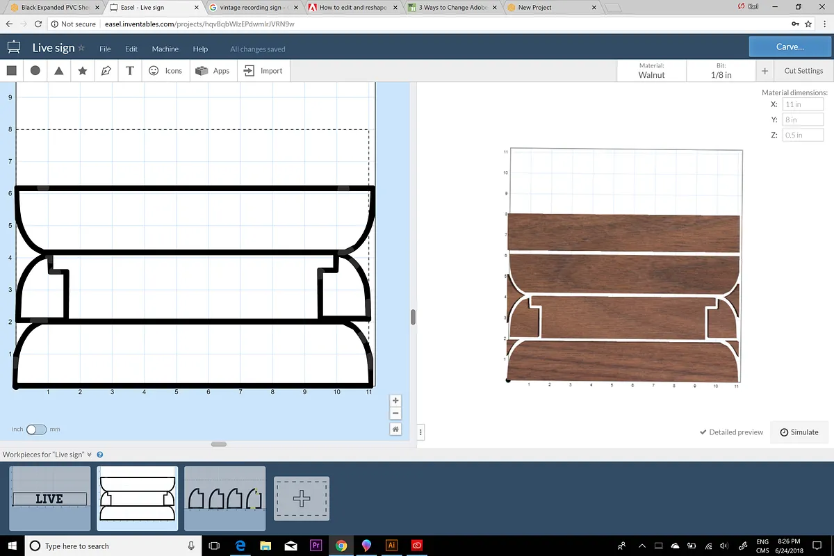

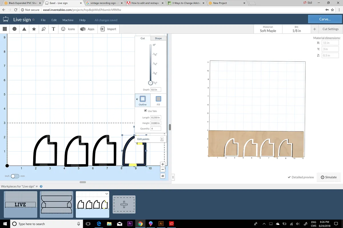

Carve
carve all the required pieces.
Estimated time: 60 minutes

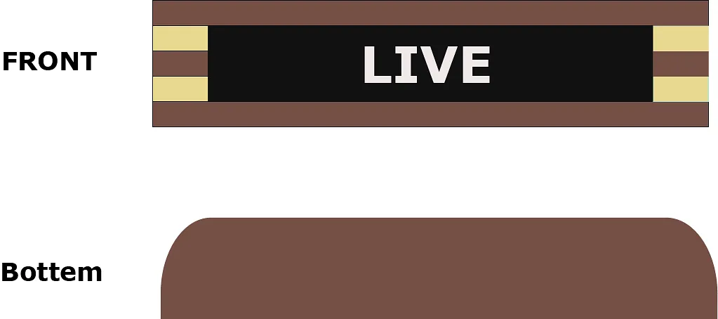

glue up
with all the pieces carved out start gluing the wood pieces together starting with the long walnut piece. on either side align the smaller wood pieces alternating between the walnut and maple lastly add the other long piece and secure with clamps

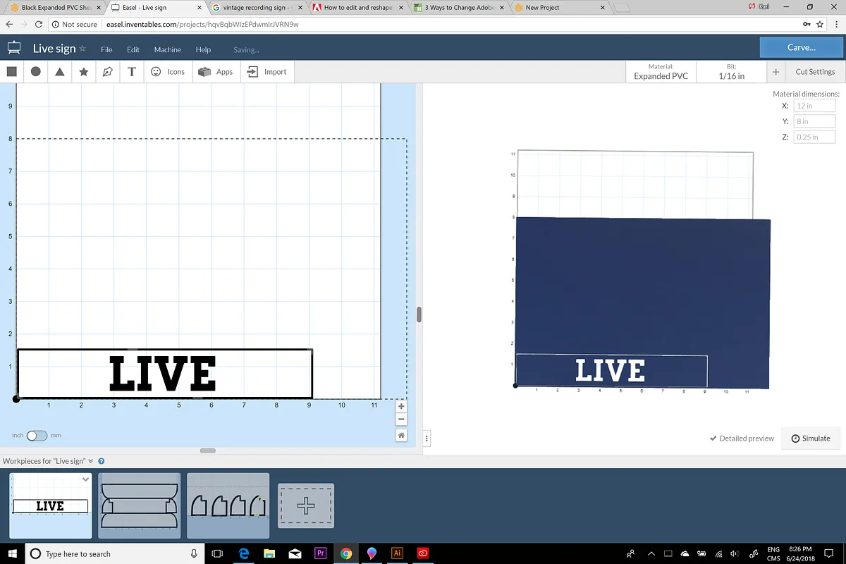

sign
place the cut out pvc in the recessed area. use either glue r screws to secure it to the wood
