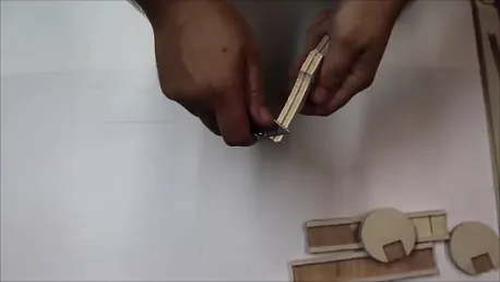

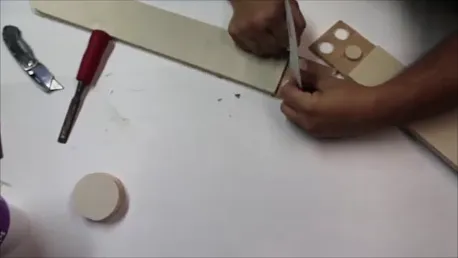

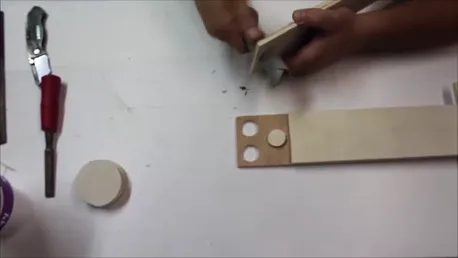

Parting out Sanding
Part out all of your pieces form the wast. Use a hobby knife to trim off the tabs and give everything a good sanding.

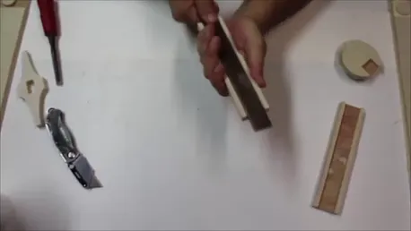

Sanding joint
This is going to be a tight fitting joint. Use a file and sandpaper to clean the inside of all the joints. Be careful not to remove to much material or it will cause the joint to not fit together properly.

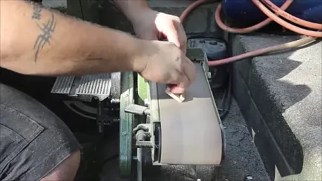

Smooth the outside of the handle
use sandpaper or file to smooth the outside of the handle. Make it fit nicely in your hand. i used my bench top belt sander. got to love power tools :)

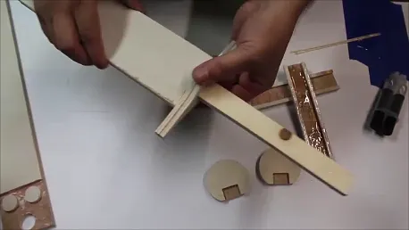

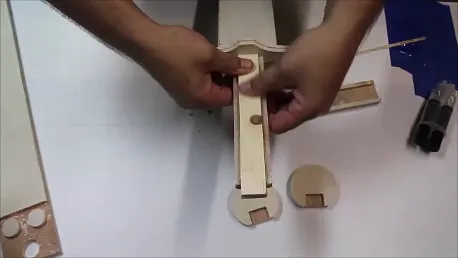

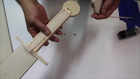

Assembly handle

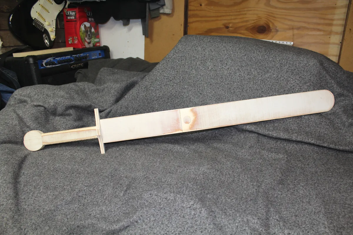

time to start gluing everything together. Start by gluing the guard in place then attache the handle. lastly glues the pommel to the bottom if needed use clamps to hold everything together till it is all dry.

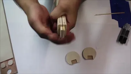

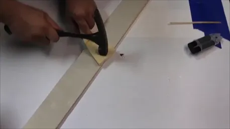

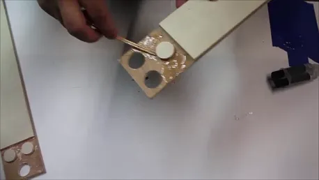

glue scarf joint
after the handle has dried its time to glue the scarf joint together. This is not somewhere you want to conserve glue. Make sure every surface that is going to touch one another is covered. use a hammer and scrap of wood to make sure the joint is completely seated. Use clamps to hold together if necessary till glue sets.

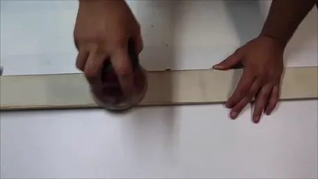

finishing
After all the glue has cured give the sword a good final sanding. Make sure that you smooth out any unevenness at the scarf joint. Finish the sword as you see fit.
