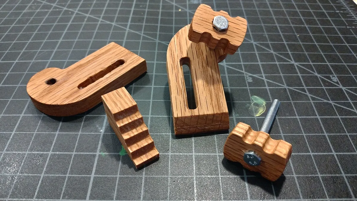

Wood Clamp Set for Beginner

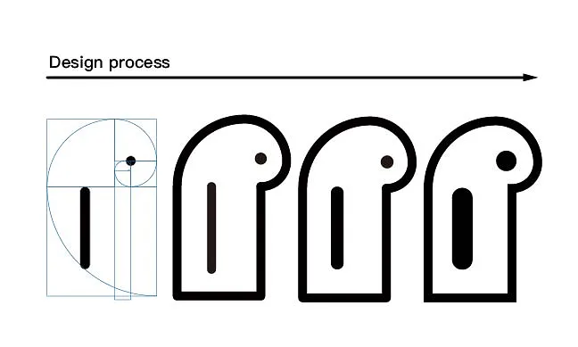

Golden ratio wood clamp set. Materials: 1. Home Depot 0.5" X 3.5" X 36" Oakwood1 2. Cap Screw M5-0.8 X 50 mm Metric2 3. M5 washer2 4. M5 nut2 5. 220 sandpaper *1 6. Wood oil *1
Total cost: Under $20
