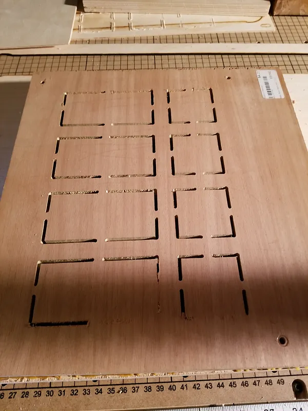

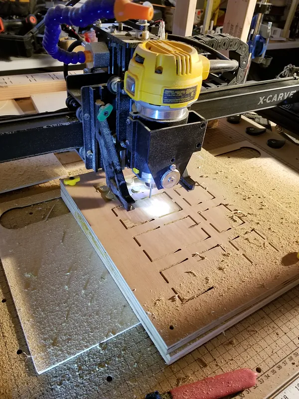

Carve the bottom
Carve the bottom tab of the design using the lower left hole as the origin. You will need a long bit for this as it will need to cut all the way through 38 mm or 1.5" of material.
Estimated time: 360 minutes

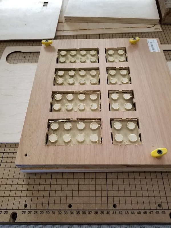

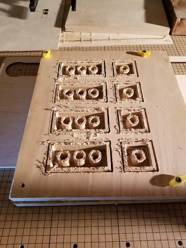

Flip the Board
Flip the board top to bottom and use the alignment holes to make sure the carve will match up. The lower left corner should be origin again.
Carve the bottom
Carve the bottom from the Bottom tab of the design. Again this should line up against cut that has already been made through the design. The tabs on the top part were set to a height of 10mm and we are cutting about 8 mm down so we should be keeping at least 2 mm to keep the pieces attached to the material.
Estimated time: 120 minutes

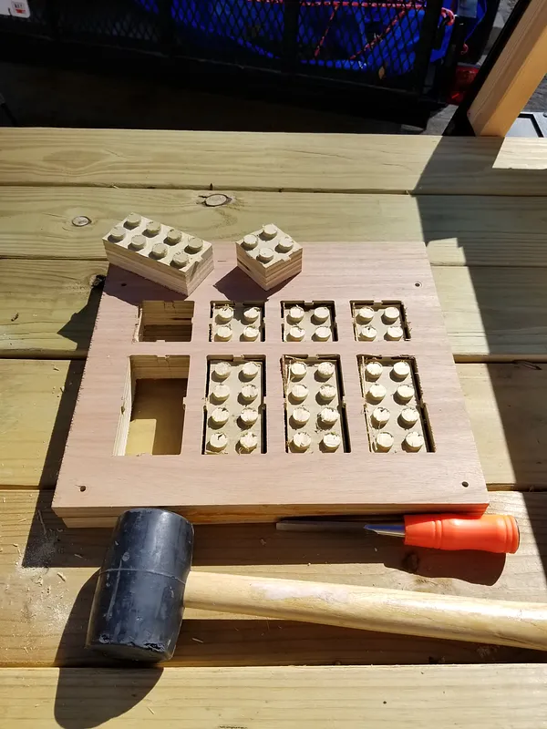

Remove Bricks and Finish
Once the top has been cut, I used a chisel and mallet to knock the 4 tabs off each brick and that worked very well. Once you have the bricks you will have to sand and cut the excess tab material off.
