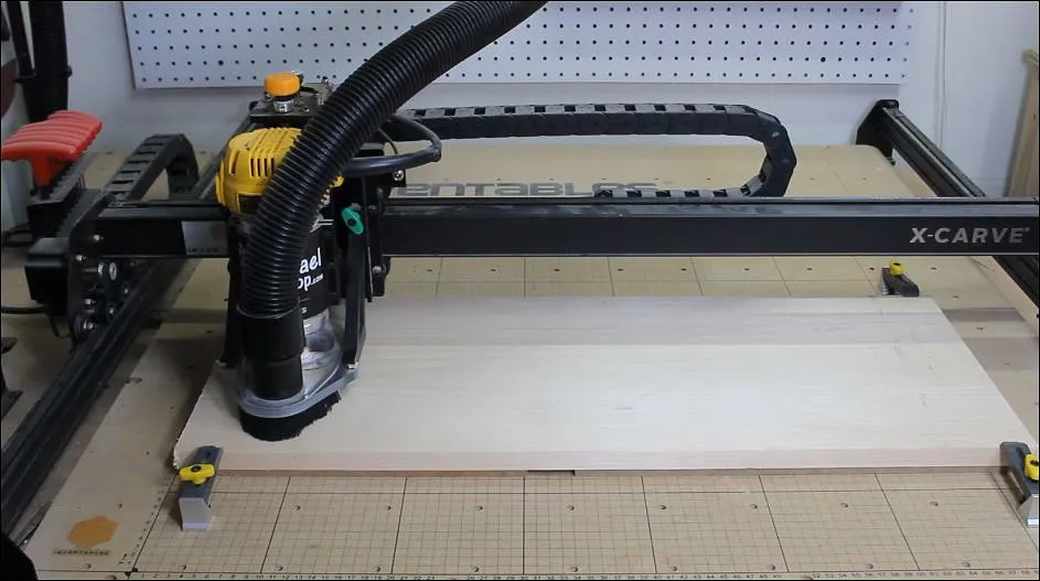

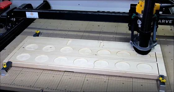

Cut two blanks that are 29" x 11.25" x .75" and mount one on the X-Carve.
Cut the First Set of Parts
Verify the thickness of your wood and adjust settings if necessary.

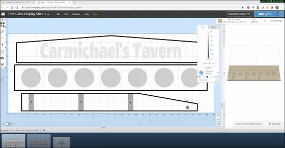

Edit the text as desired to customize the sign for the top of the display rack.
This work piece includes one shelf, the left side, and the sign.

Cut the Second Set of Parts
This work piece includes two shelve and the right side.

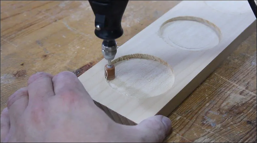

Sand the Parts
Take your time and sand all of the parts smooth. A variety of sanding tools and some good music make sanding a bit more bearable.
Estimated time: 45 minutes

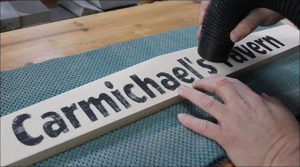

Paint the Sign
Mask off the areas around the text and spray paint the letters with your desired color. When dry, peel off the tape and sand away the paint on the surface. Vacuum the dust out of the letters.

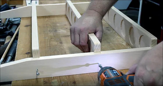

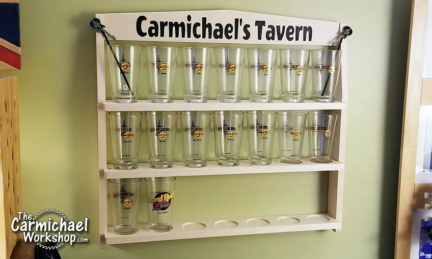

Assemble the Rack
Insert the shelves into the dado grooves on the side pieces, with the circles facing the top.
Drive screws through the sides and into the shelves.
Position the sign so it is straight and flush with the back and top of the rack.
Drive screws through the sides and into the sign.
Estimated time: 20 minutes

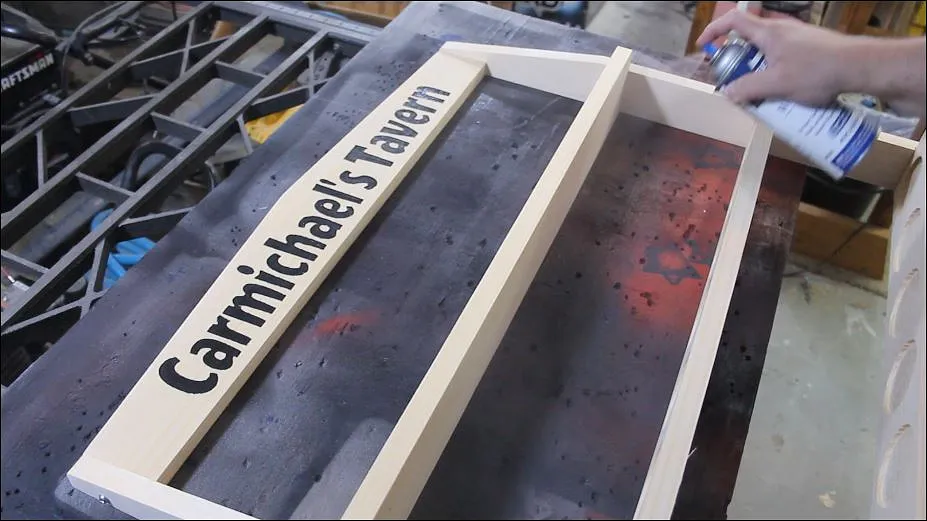

Finish as Desired
I suggest using Deft Clear Wood Finish Spray Lacquer to seal the wood and provide some protection. It dries really fast so you can get the rack mounted and filled with glasses in no time.
