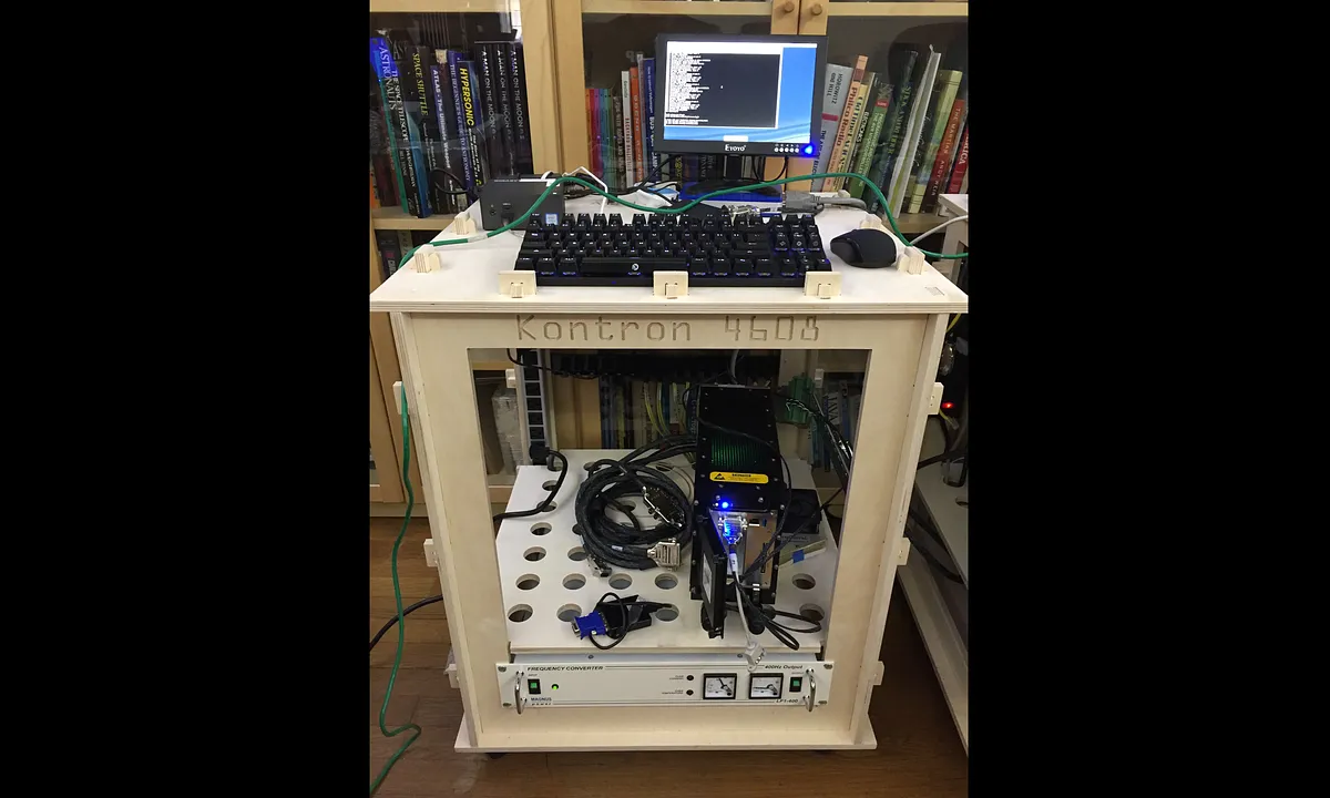

This is a 19" equipment rack. It uses mortise and tenon joinery, no glue required. It can be cut from a single sheet of 5x5' 0.5" baltic birch plywood.
