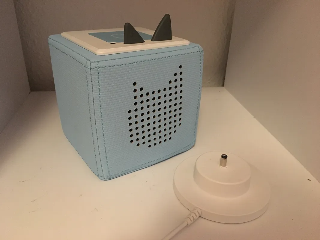

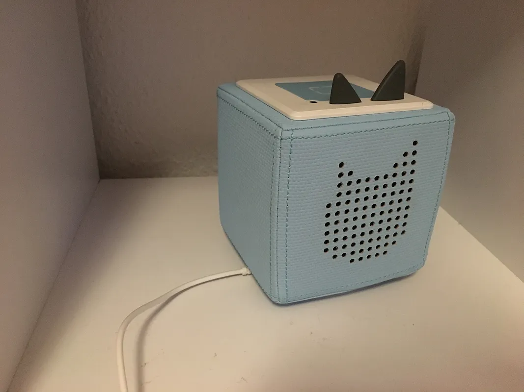

CNC Millling - Backside for Charger Station Cable
- Place the Material on the X-carve and mill the backside first, the slot for the Charger Station Cable
Estimated time: 3 minutes
