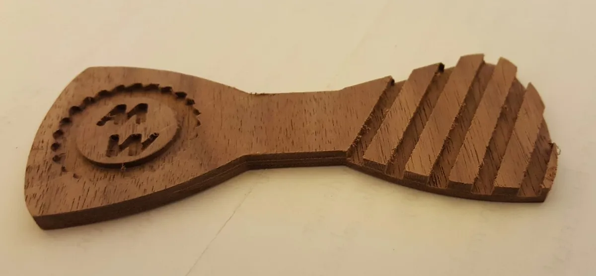

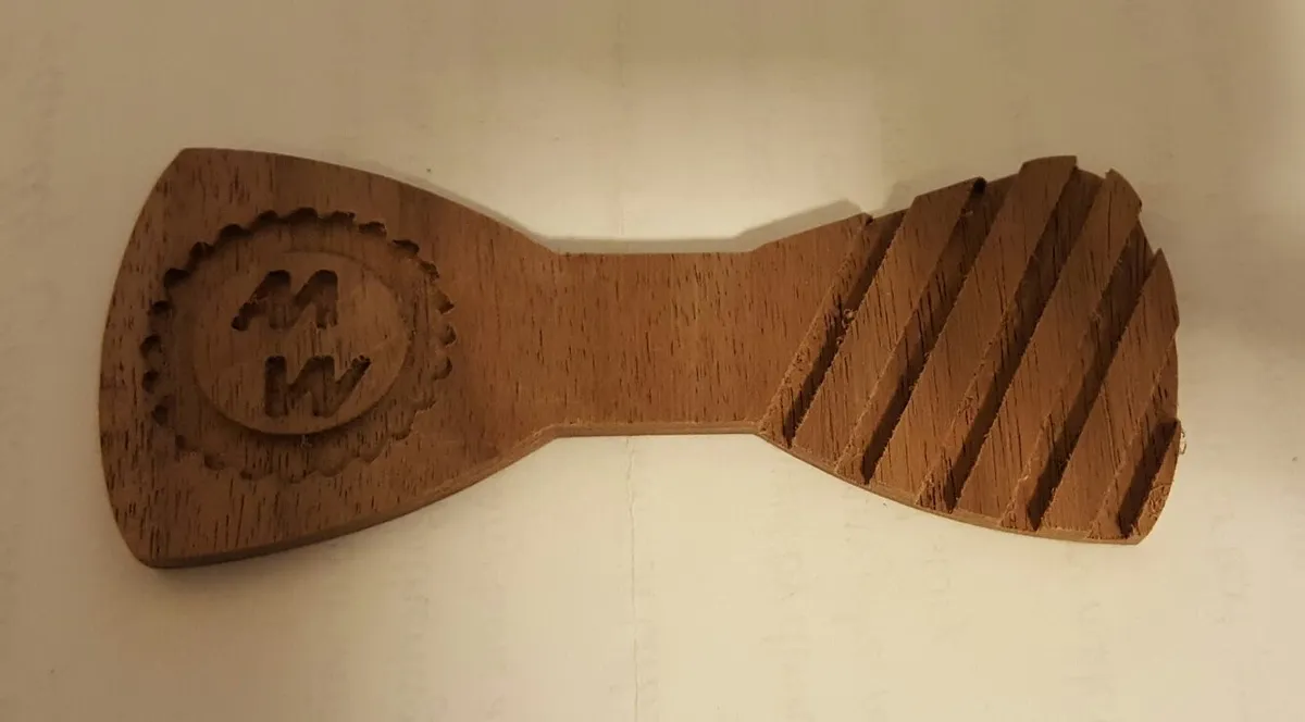

I used a current copy of the logo that I created for my business, converted to SVG files and then imported. I then used the easy-to-use easel app to create the contrasting stripes on the other side.
Estimated time: 10 minutes
Cut
Export the g-code and run on my 1m upgrade SO2/Xcarve
Estimated time: 3 minutes
Sand, Cleanup, and Sand some more
I cut all my pieces to within 1/32 of an inch so I can either pop them out or cut out with a sharp knife. If my projects are larger, is use my 18" drum sander until all the small scraps fall to the floor. Finish it up with a little hand sanding and finished it is! A great easy project with easy software that only took a few minutes to produce!
