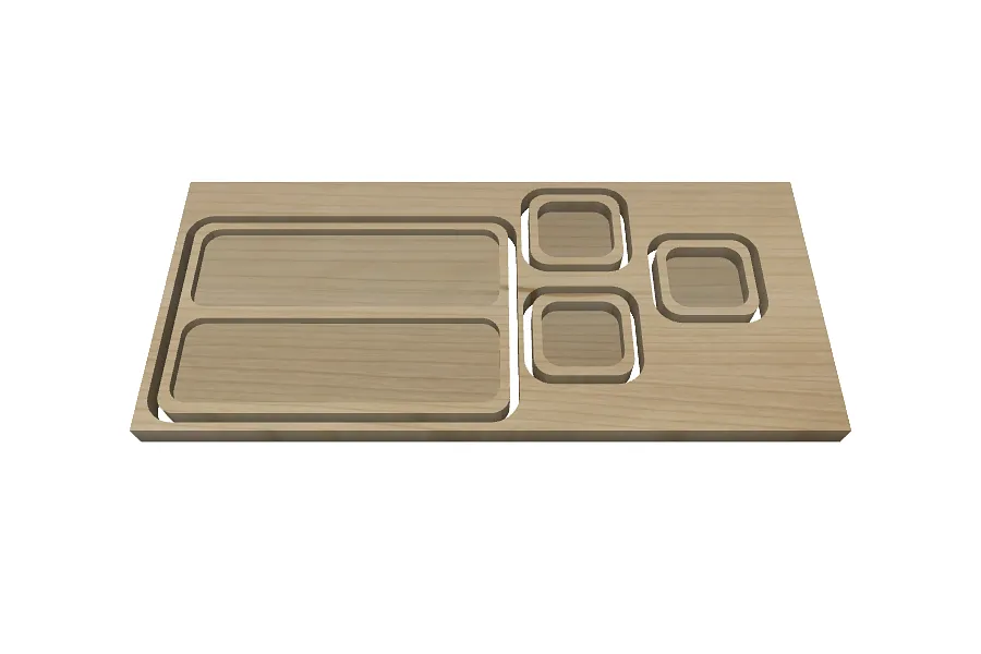

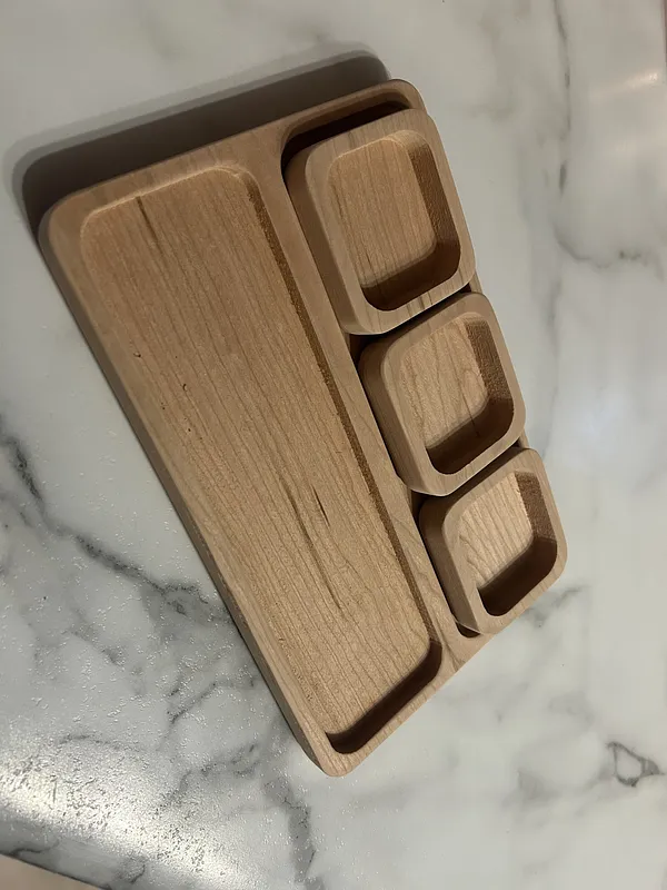

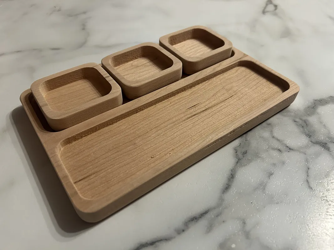

a simple concept for a cocktail bar tray. cut from 3/4" material, it has three garnish 'cups' that will nest in the upper tray which is slightly larger than the lower tray. this leaves a lower tray for tools.
also, the bottom of the tray and cups need a 1/4 roundover, i use a router table.
Notes
you'll want to use 5/4 or 1.25" stock for the cups. i did the original with .75" and wasnt happy with the look
