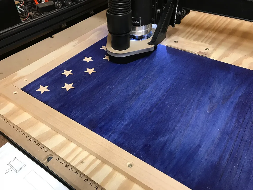

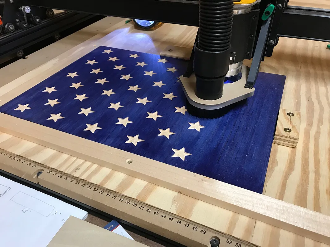

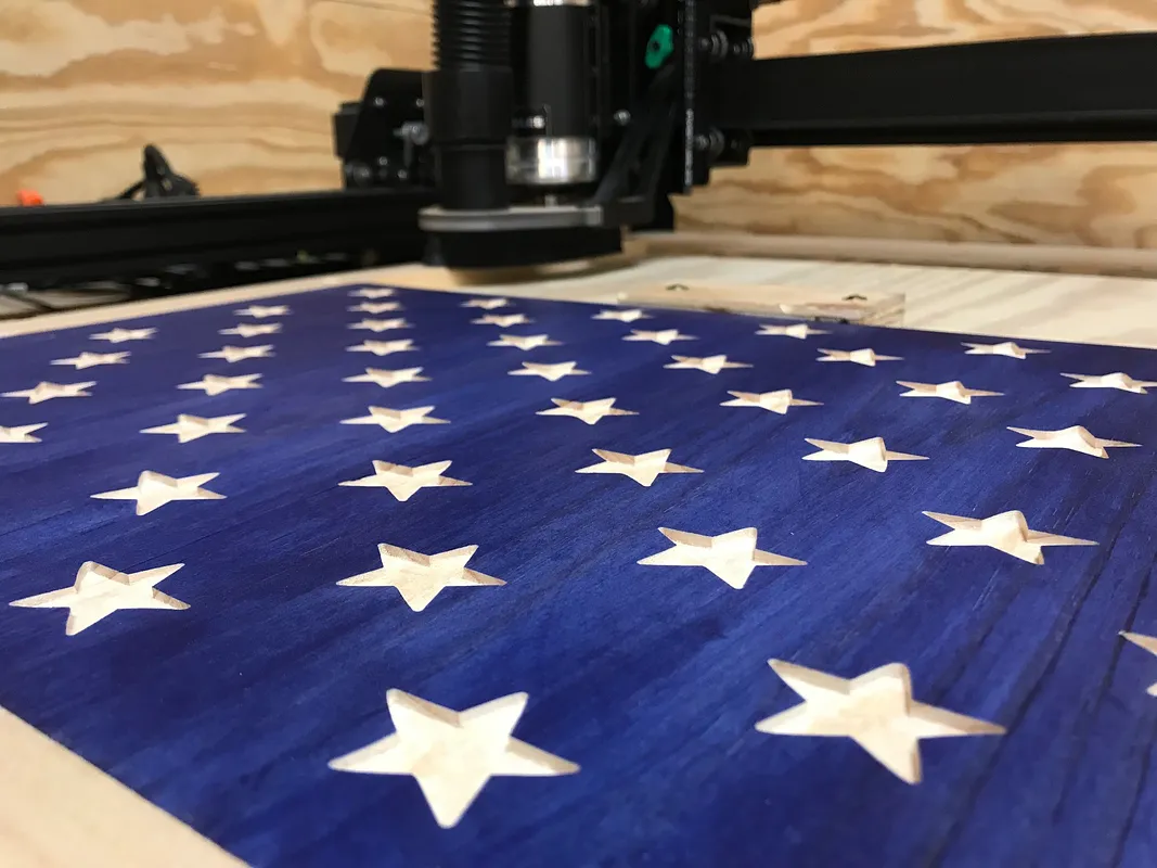

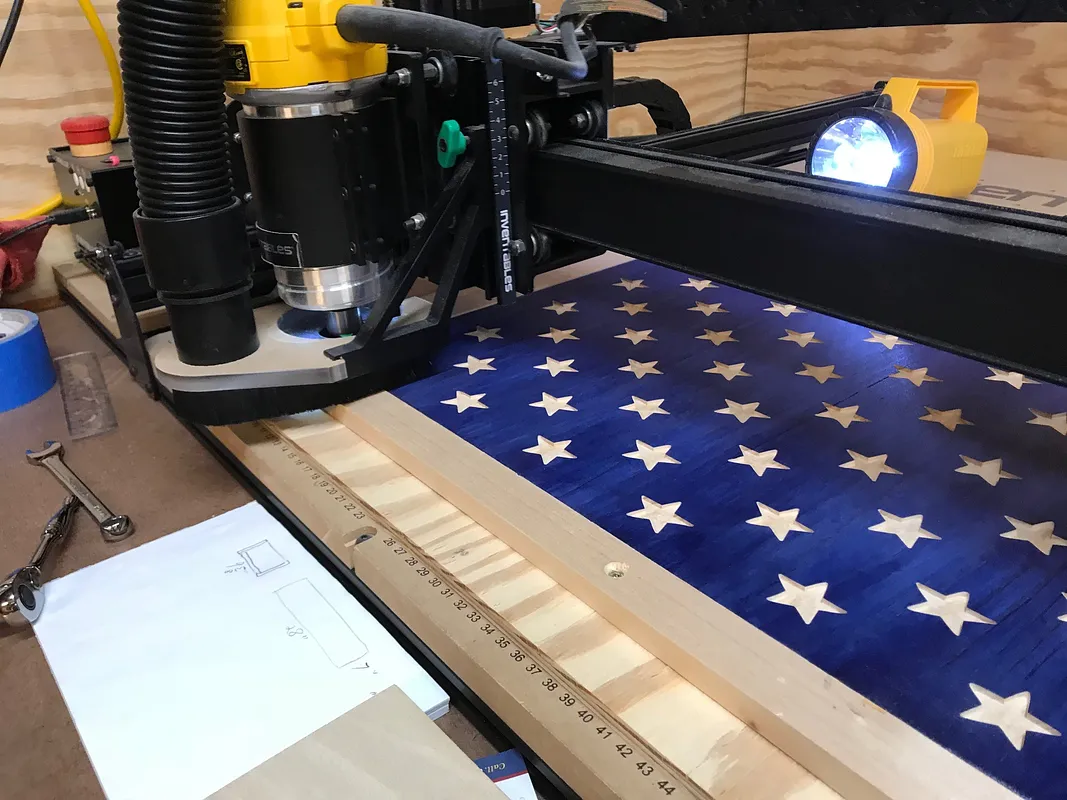

Using my X-Carve to create the "Star Field" on the American Flags I am starting to make. Works great!

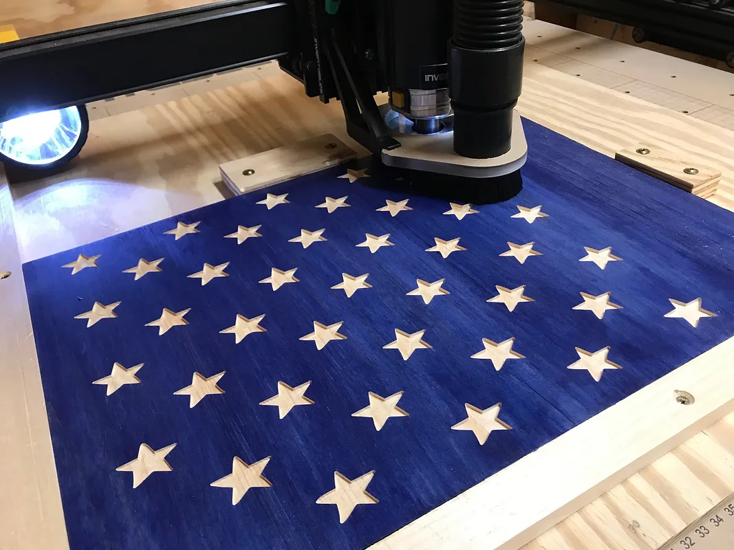

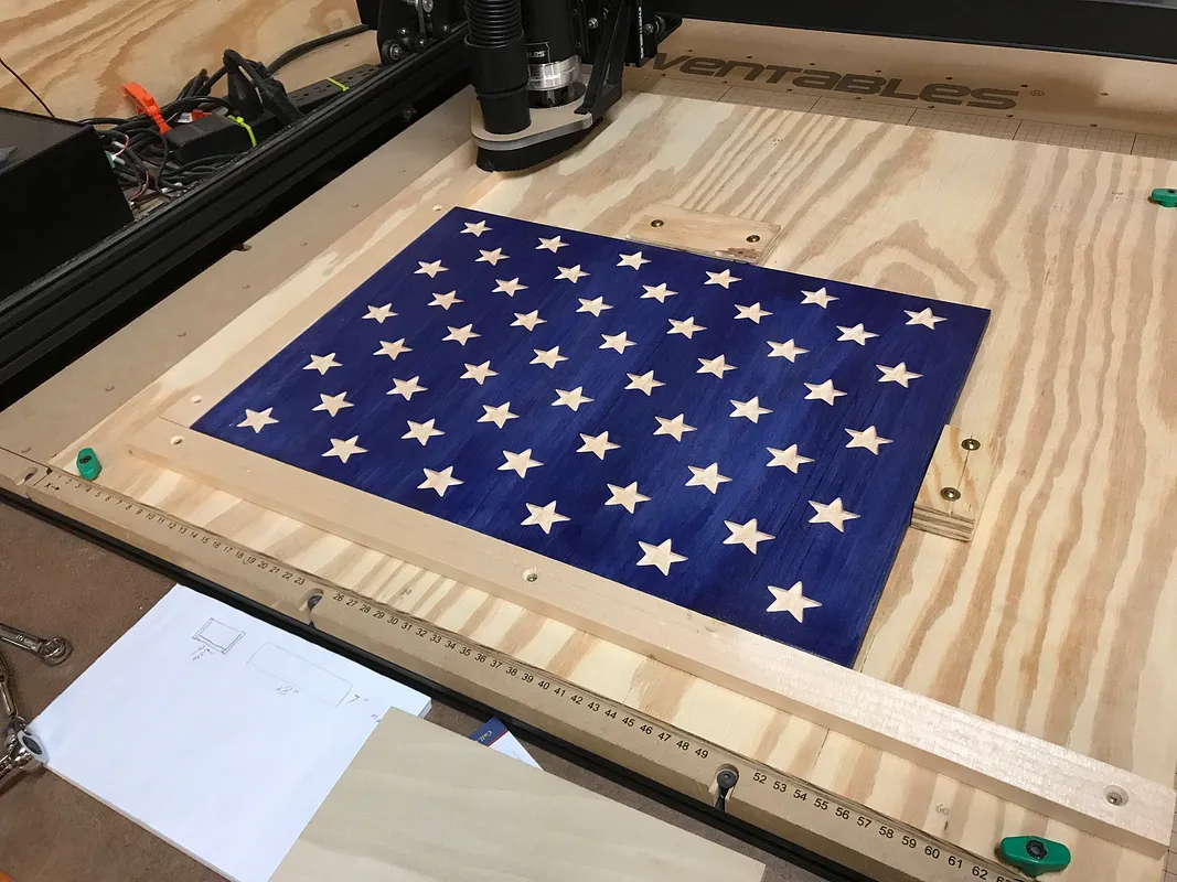

looks great but why are some stars not the same ?

It looks great. I don’t have that much confidence in my dimensions, so I start with wood that is 2” larger than I need. Then trim it after carving.

your stars are all not consistent not sure how you created this design but it needs work
J · July 16, 2019
fyi....if you tried to trace /vectorize a stars image in easel the stars will never all be the same you need to create the star in easel and not trace/vectorize an image
