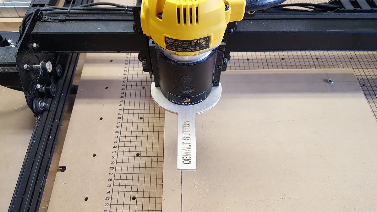

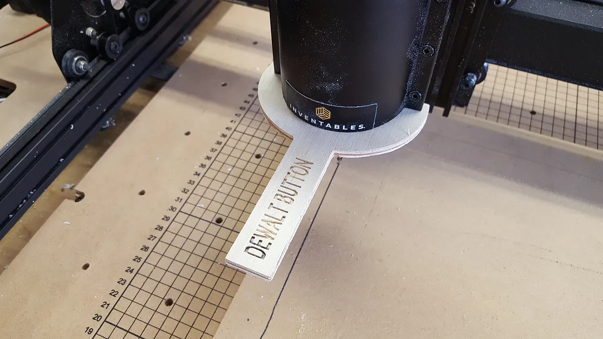

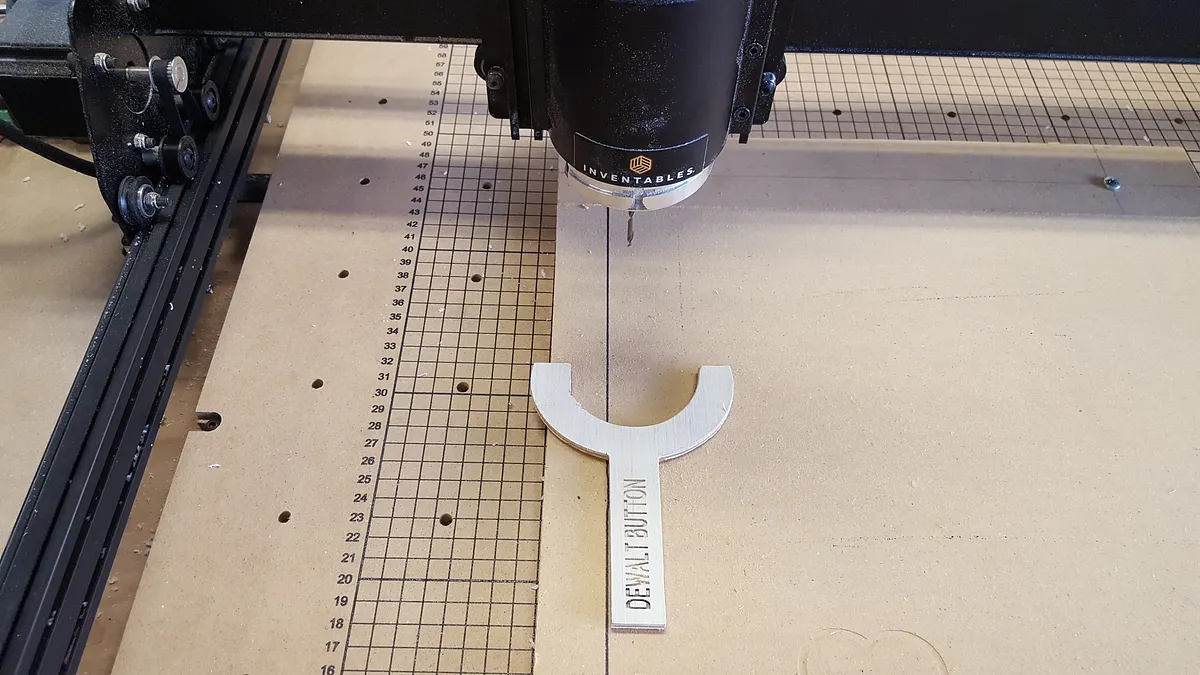

This tool will hold the yellow spindle button in while you tighten or loosen the collet nut. That way there is less chance of moving the X or Y axis by mistake. Key measurements: the inner diameter needs to be 2.700. The width where the flat is needs to be 2.565.

Worked pretty good made mine out of 3/4 oak

made mine out of plywood, works great
