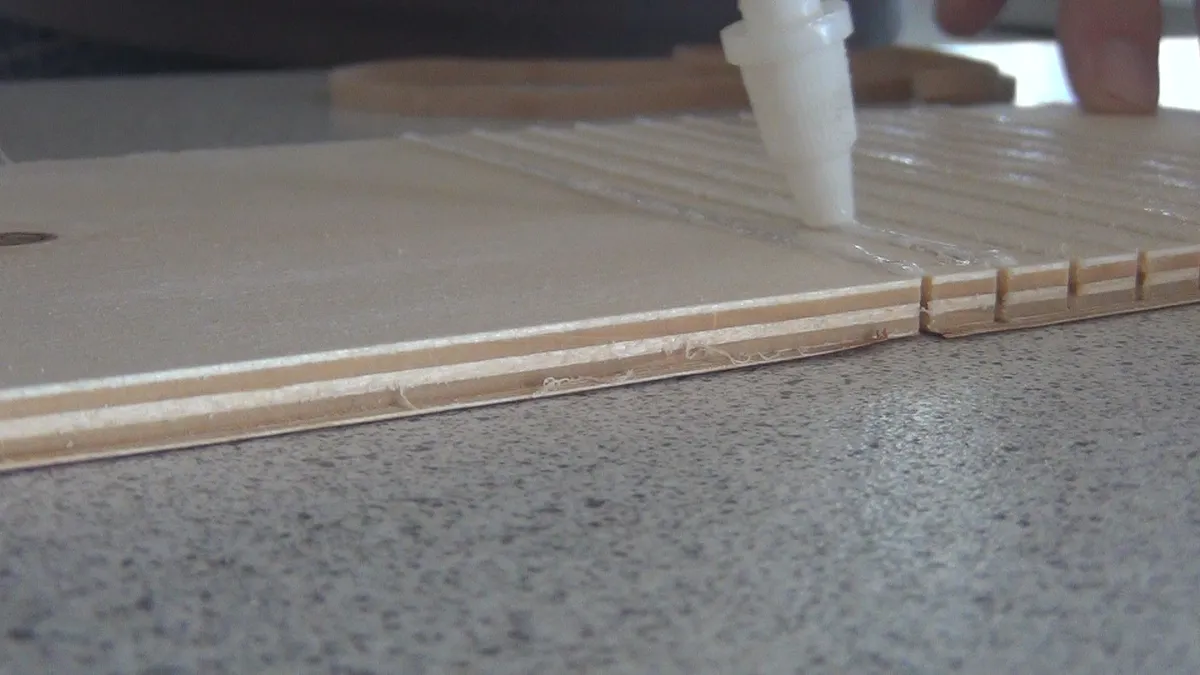

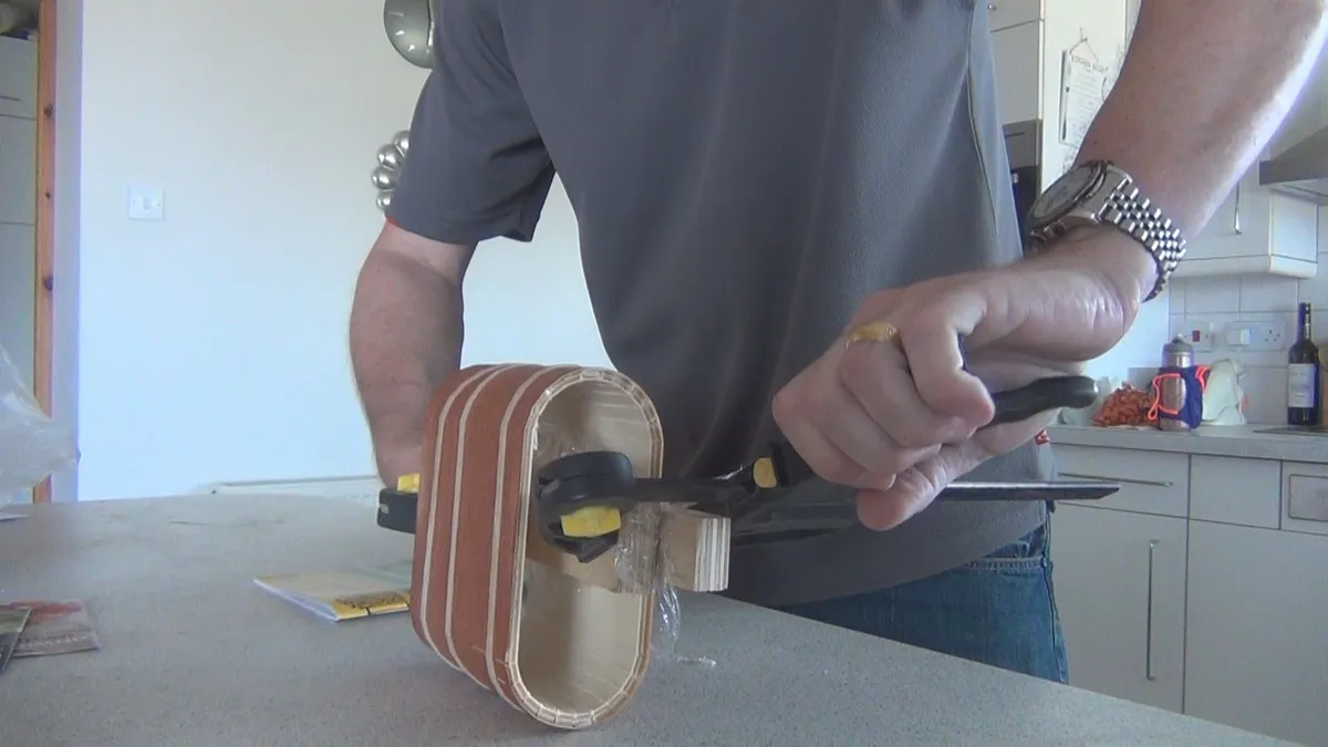

Make Tube

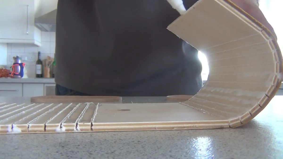

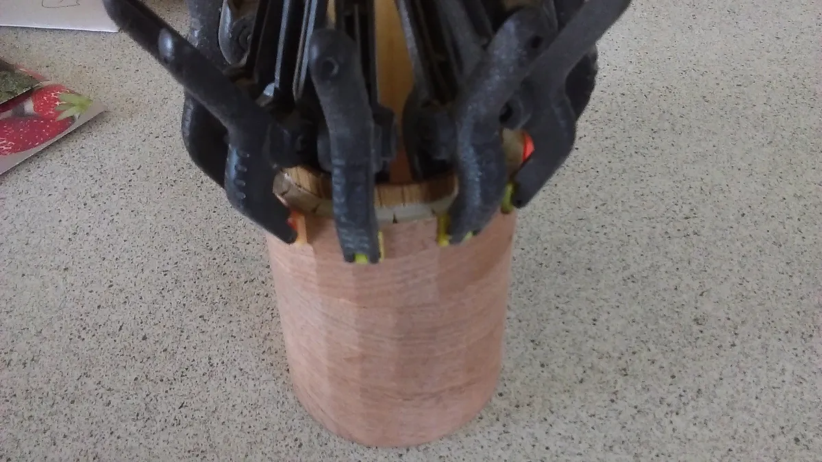

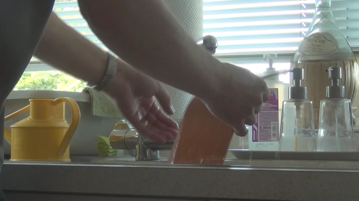

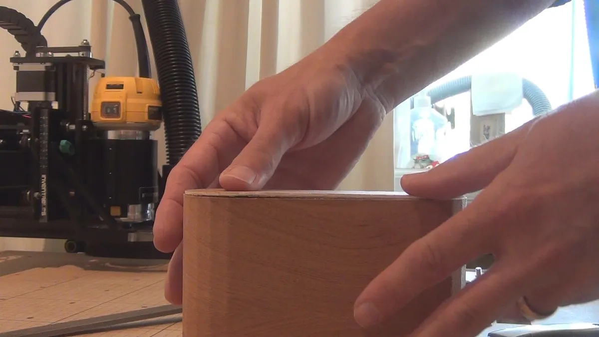

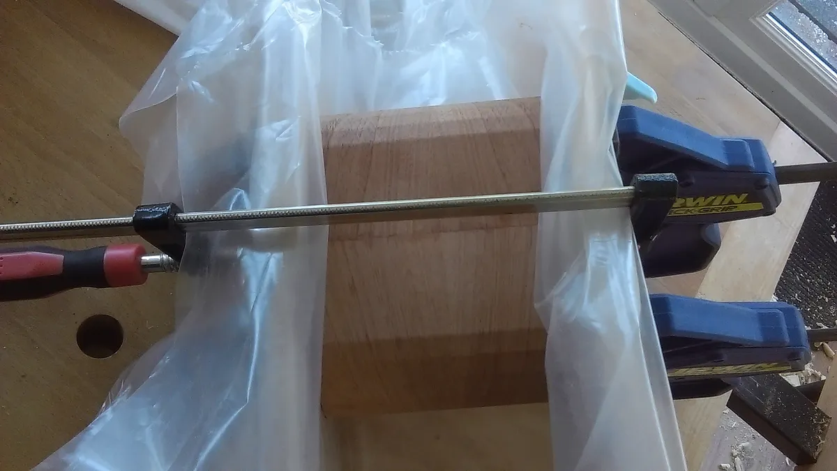

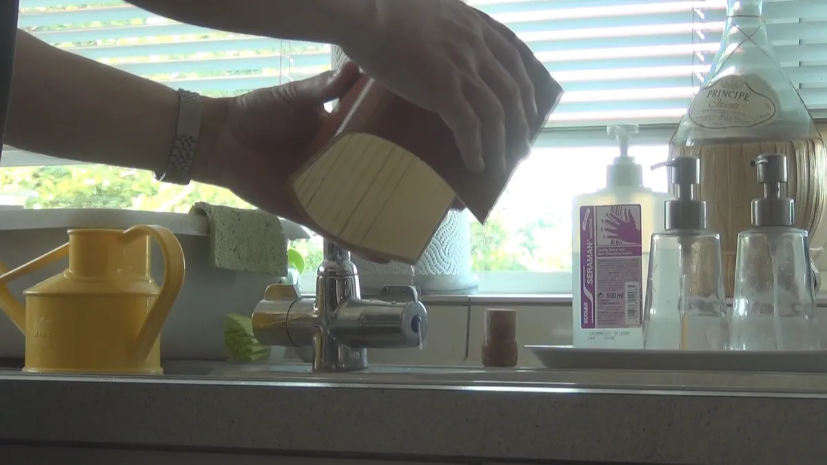

Wet part 1, and carefully flex it round into a tube. Once it will make a tube, lay it flat and apply glue to the grooves and the joining edges. Now form the tube, and hold in place with rubber bands and clamps while it cures.
Estimated time: 10 minutes

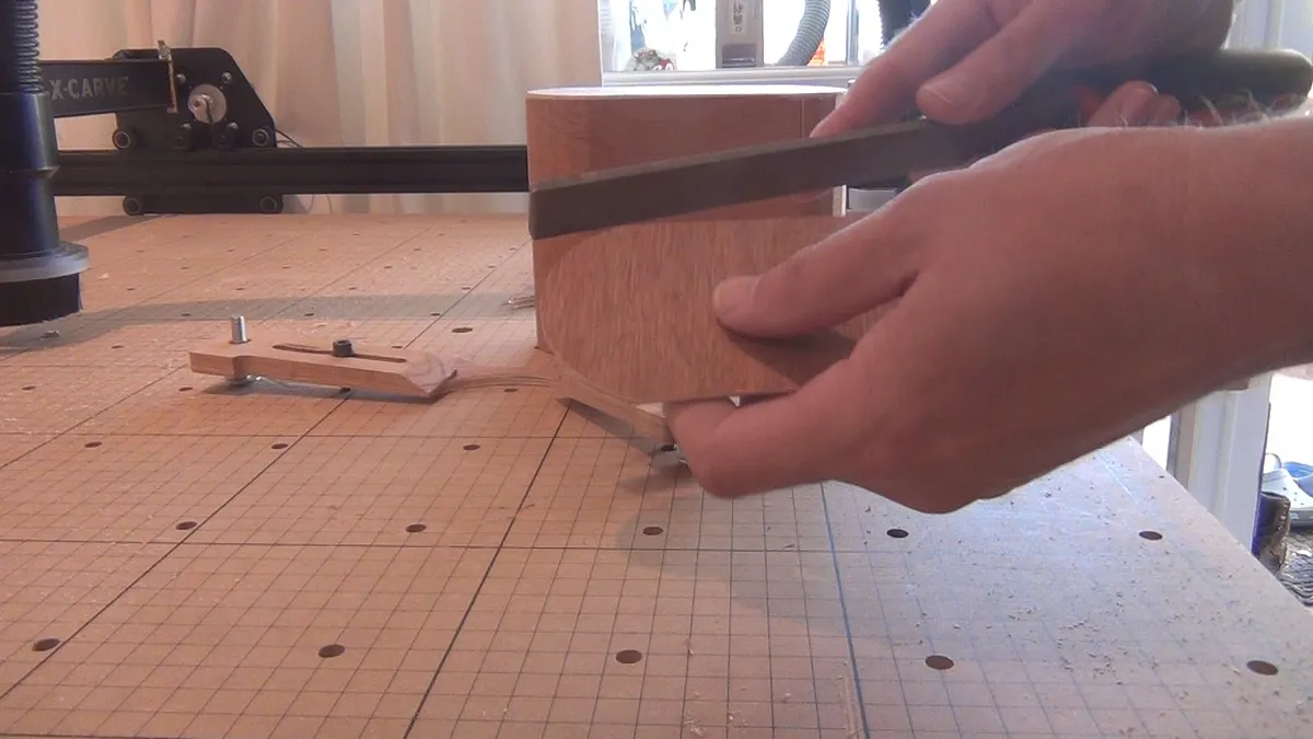

Fit Ends

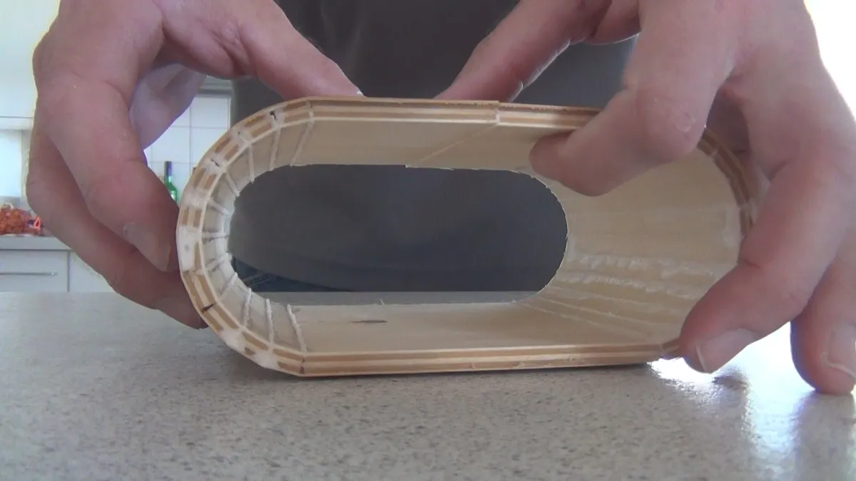

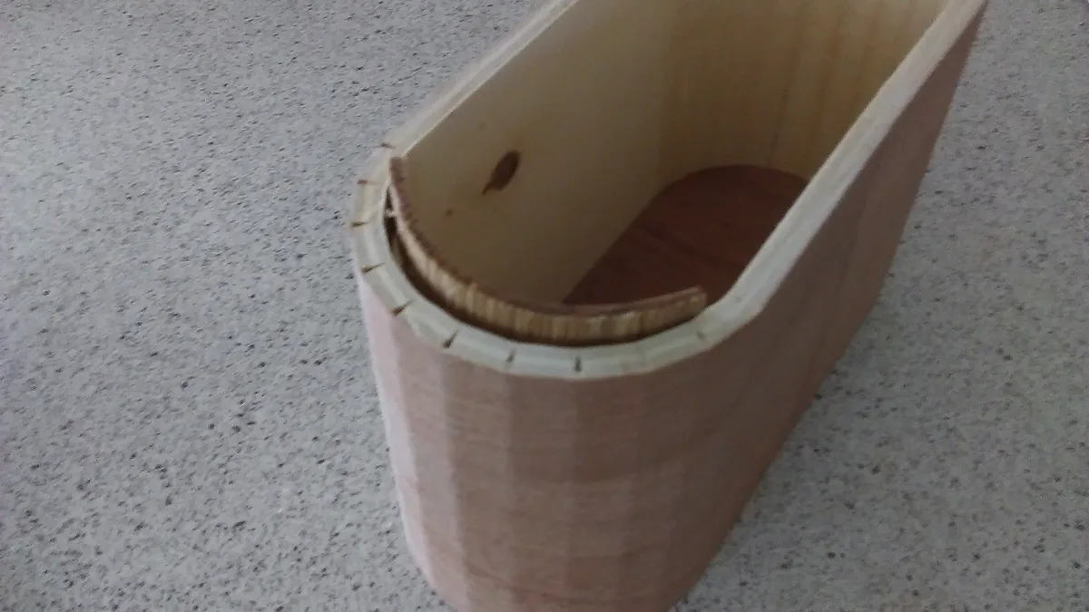

Once the tube is cured, fit the ends. I had to file the ends a little to get a good fit, and perhaps if I had glued the tube up at the same time as gluing in the ends it may have been better.

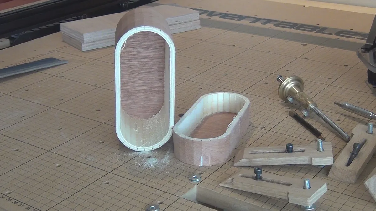

Open Box

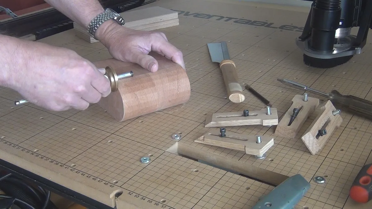

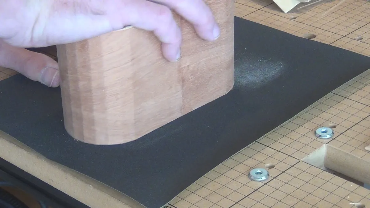

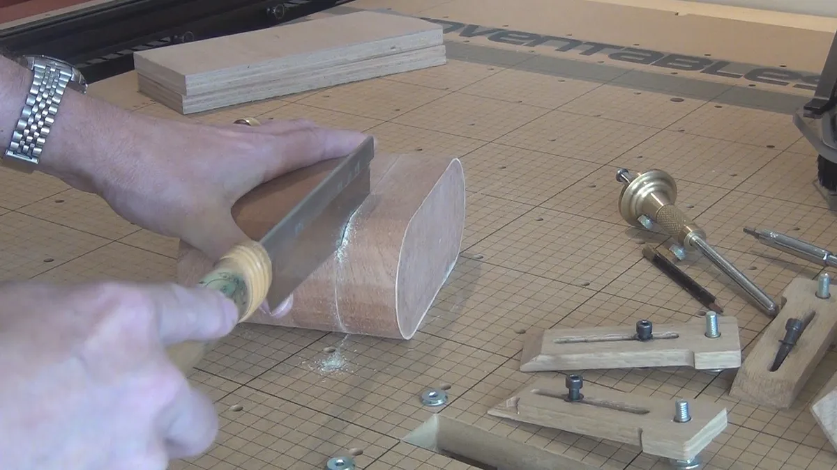

You now have a totally sealed box - not much good like that! So, scribe a line around it to define a top and bottom, and then saw it in half. Sand the sawn edges smooth.
Add Joining Lip

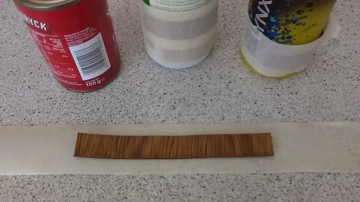

To keep the top and bottom together when the box is closed, I've glued in a hardwood lip. Soaking the thin hardwood strips in boiling water allows them to be formed around a slightly tighter radius than the box requires. Tape them in place and allow to cool. Once released, the bent strips will open a little, but they should easily be pliable enough to glue into place in the top of the box's bottom half. Leave about ¼" (6mm) extending out, for the box lid to fit onto. Clamp and leave to cure.

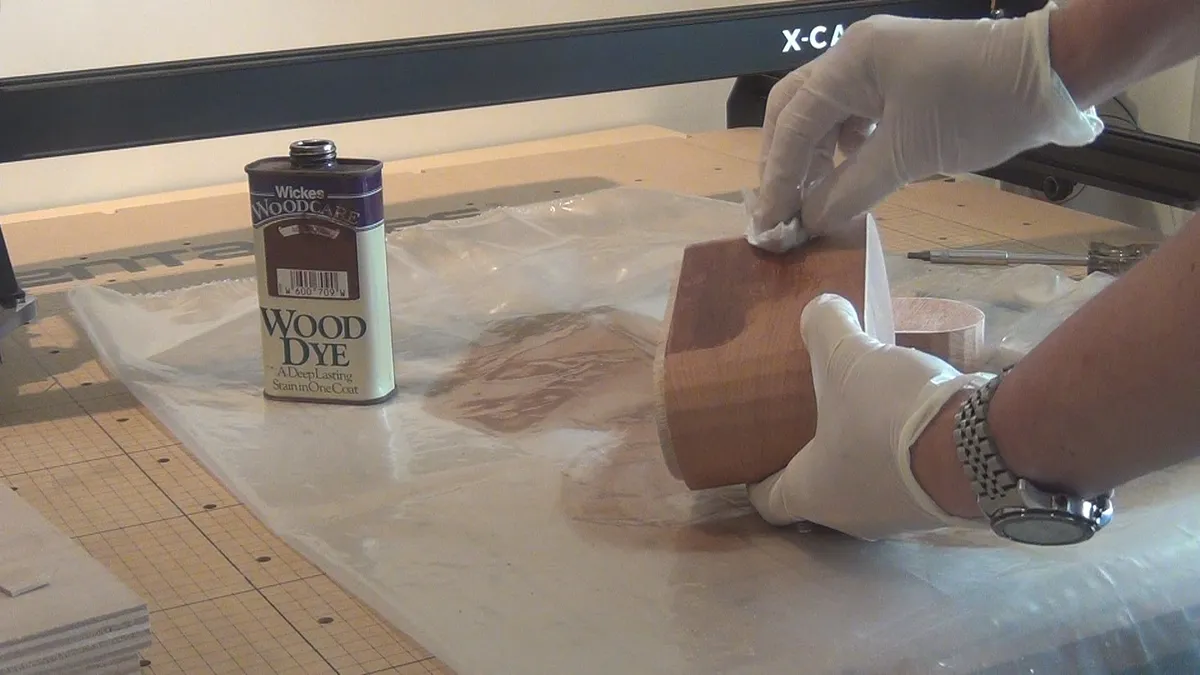

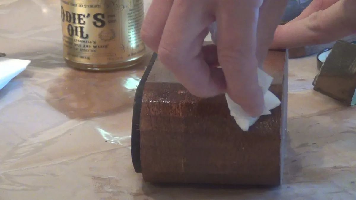

Finish

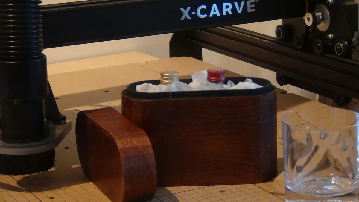

Apply your chosen finish.
I used some stain and an oil based finish, and painted the joining lip with acrylic paint.
