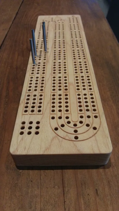

Cribbage board holes are 1/8 inch nominal to fit tapered pegs. While Easel does not support drilling operations, it does support importing g-code.
This workpiece contains g-code that simulates Peck Drilling cycles (G83). Drill bit can get hot so between each set of 15 holes a 10s dwell cooling cycle is used. Do not be alarmed. Your carve has not stopped. Carvey can only handle a Z feed rate of 800mm/min so this workpiece runs the spindle at 8000 rpm instead of 12000 rpm. Do not be alarmed. This is done so your wood does not burn...too much.

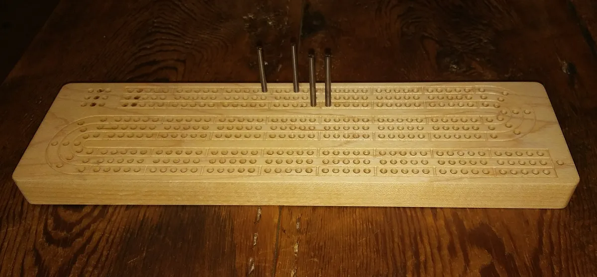

Carve your optional tracks
It is nice to have the visual guides of the tracks that run along the path of the holes. This helps count fives and keep you in your track. This is optional. Sometimes you just want the grain of the wood to show through unfettered by the tracks.
Use a small diameter bit like 1/32 inch.
