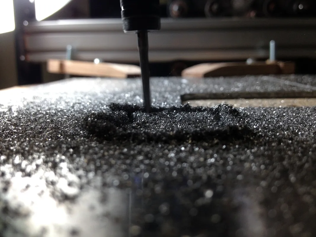

I noticed in step 6 that the aluminum through holes are not very "circular". Is this from the MakerCam G-code or is this an issue with the precision of the machine?
Marc Schaefermeyer · November 14, 2013
Greetings- the holes are a little eccentric because I was running the feedrate too high on those and it was dragging the bit off-axis. If I were to run the job again I'd take those to half the speed for a tight perfect circle.

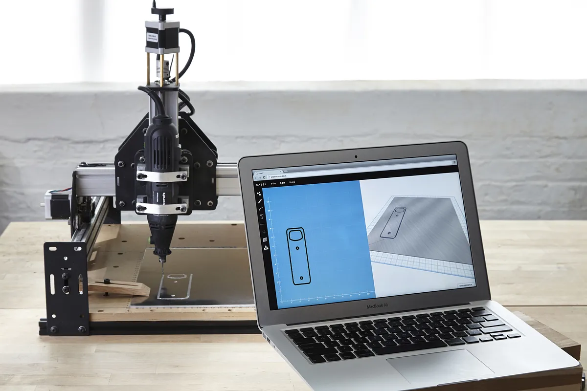

Using basic Easel settings for aluminum it says it will take 9 hours to cut out. So.... that can't be right?
Theo Retos · June 23, 2016
Opening the Easel file, the simulation looks really thin at the sides of the aluminum opening compared to the photos. Like it would be fragile when opening a bottle... Should this really be cut using 1/8" bit with the "On Path" setting? Is the 1/32" upcut bit intended for the design on the walnut?
