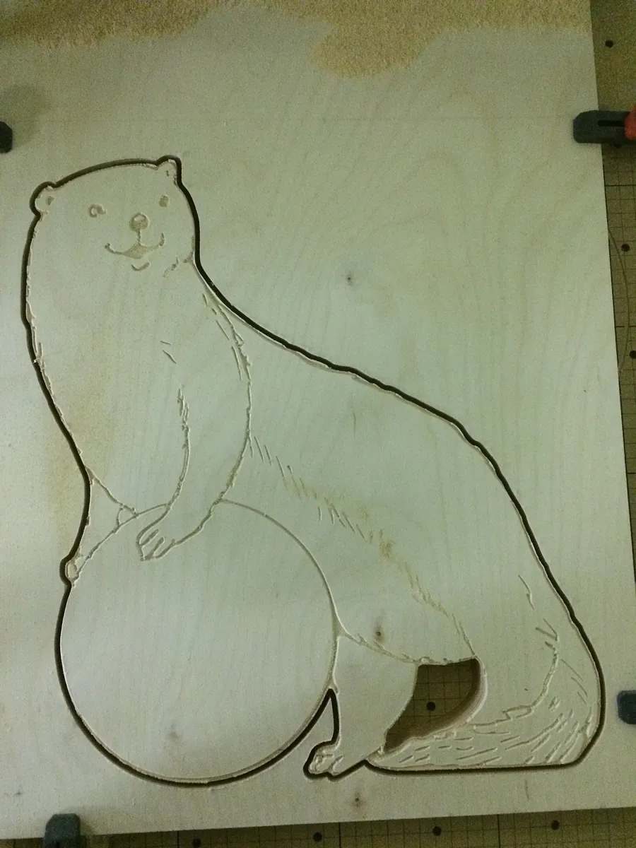

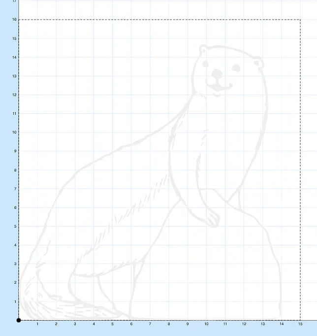

Left Side Texture

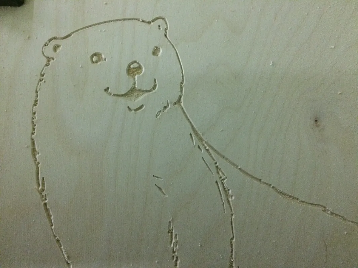

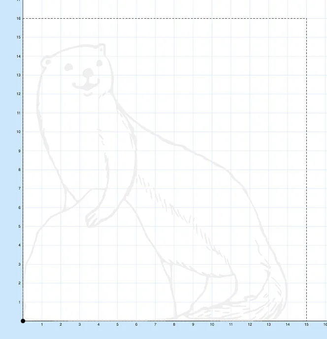

First, cut the left side texture using the v-bit of your choice. Be sure to mark your starting point on the workpiece so that you can position the endmill in the same spot for the next step.

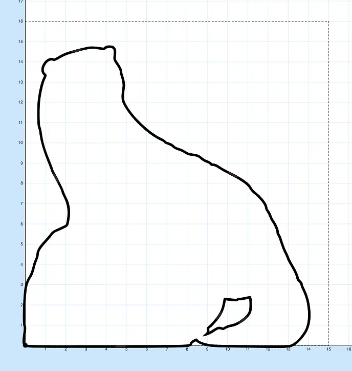

Left Side Outline

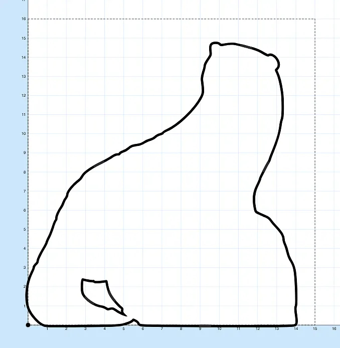

Switch to the endmill of your choice and cut the left side outline.

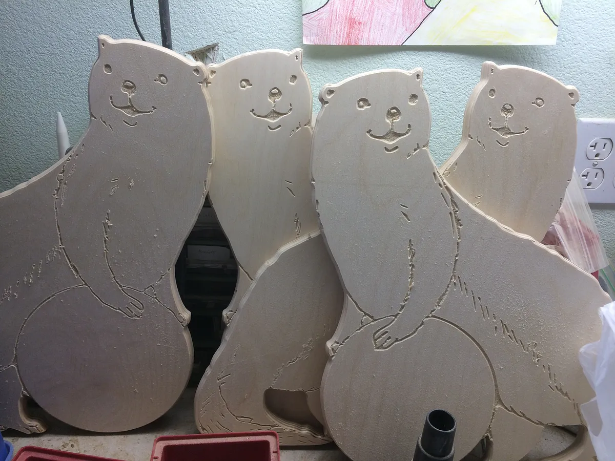

Right side texture and outline

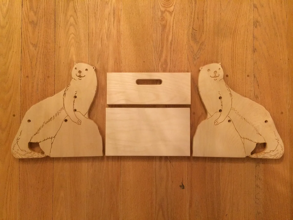

Put a new piece of wood on the X-Carve and cut the right side texture and outline like you did for the left side in steps one and two. Now you'll have both sides prepared, or if you made a mistake like I did and accidentally cut two of the left side, you'll have two of each side so you can build two stools.

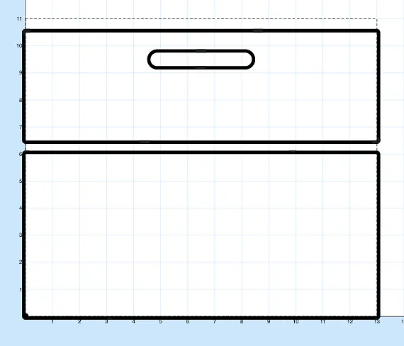

Seat and seatback
Optionally, cut the seat and seatback on the X-Carve. You could also easily cut these on a table saw or miter saw.

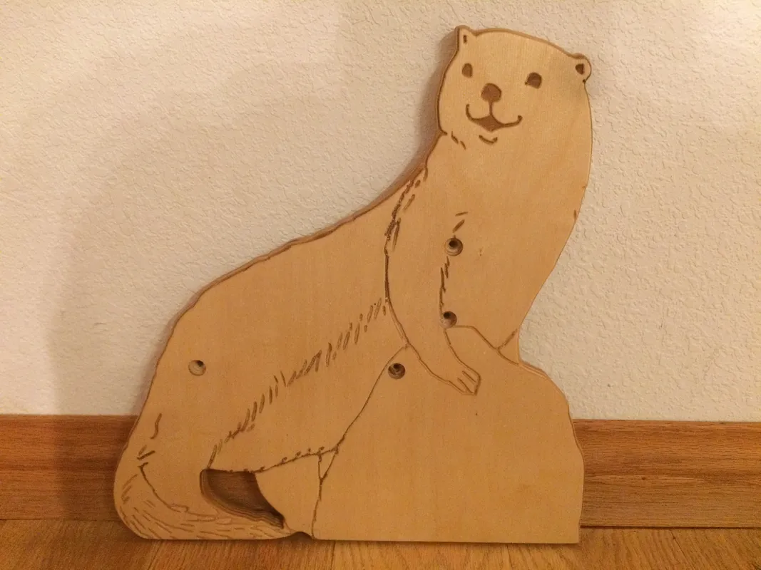

Assembly

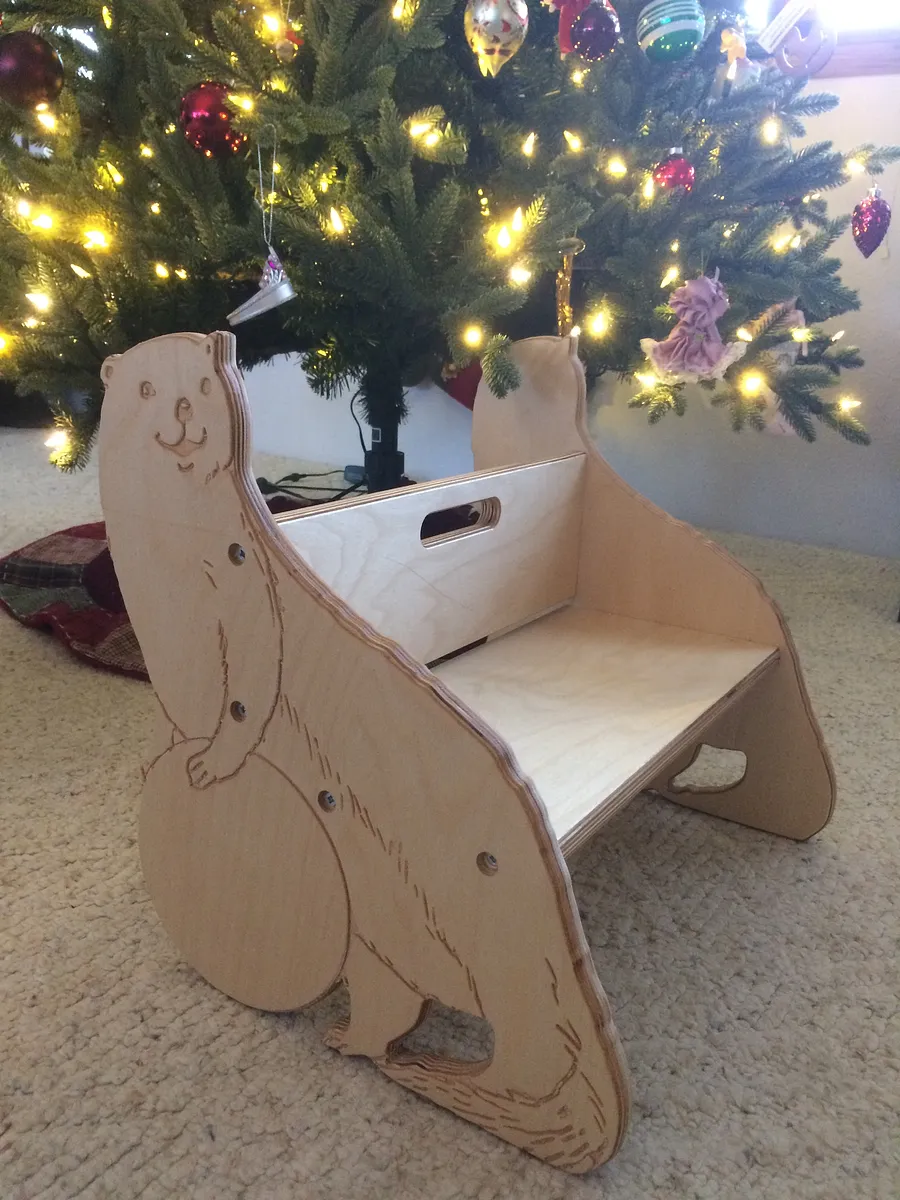

Choose your screw locations, depending on how high you want the seat and how far back you want the back. Drill pilot holes in the sides, seat, and seatback. (Before assembling, I used a hand router with a roundover bit on all of the edges of each of the pieces.) Screw the seat and seat back in place.
Optionally, you can countersink the screws and then cover the holes with wooden buttons. Or, you could choose your own method of attaching the seat and seatback. I'm not the boss of you.
SO CUTE
