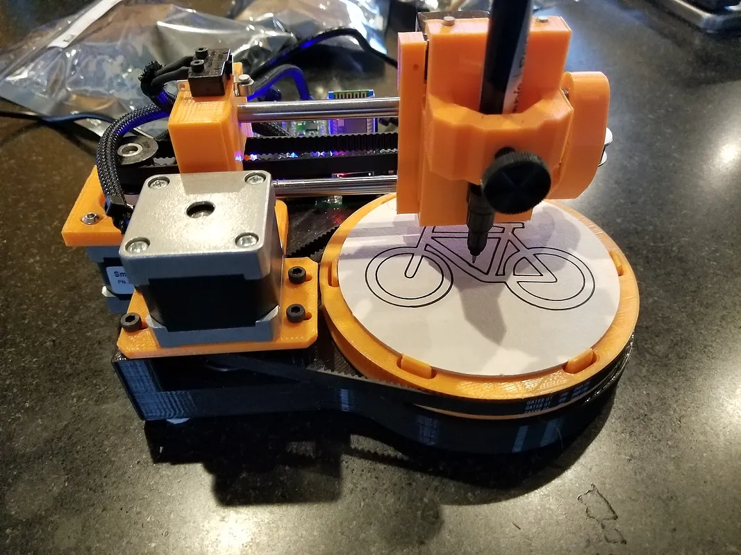

You need to create an artwork inside that circle and do an "Outline" path "on line". Set the cut depth at about 1mm and depth per pass at 1mm (same as cut depth).
Export the gcode in the Machine...Advanced menu. The push that gcode through the PolarPreProcessor python script.
