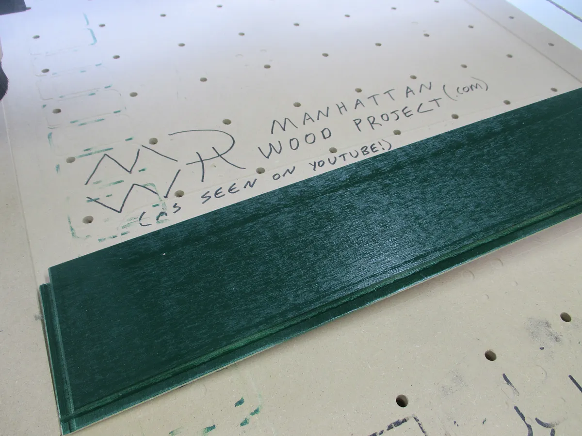

Paint Back of Wood
To keep players from recognizing pieces by the wood pattern, you should consider painting the back of the piece of hardwood flooring. We chose high gloss hunter green.
Be sure to let the paint fully dry for at least a day before setting it on the wasteboard and cutting. Failure to wait could result in a little bit of paint transfer to your wasteboard (and the subsequent dust sticking to the painted pieces). Uncured paint can also gum up your bit and mark up the sides of the pieces, which requires a lot of sanding to get rid of.

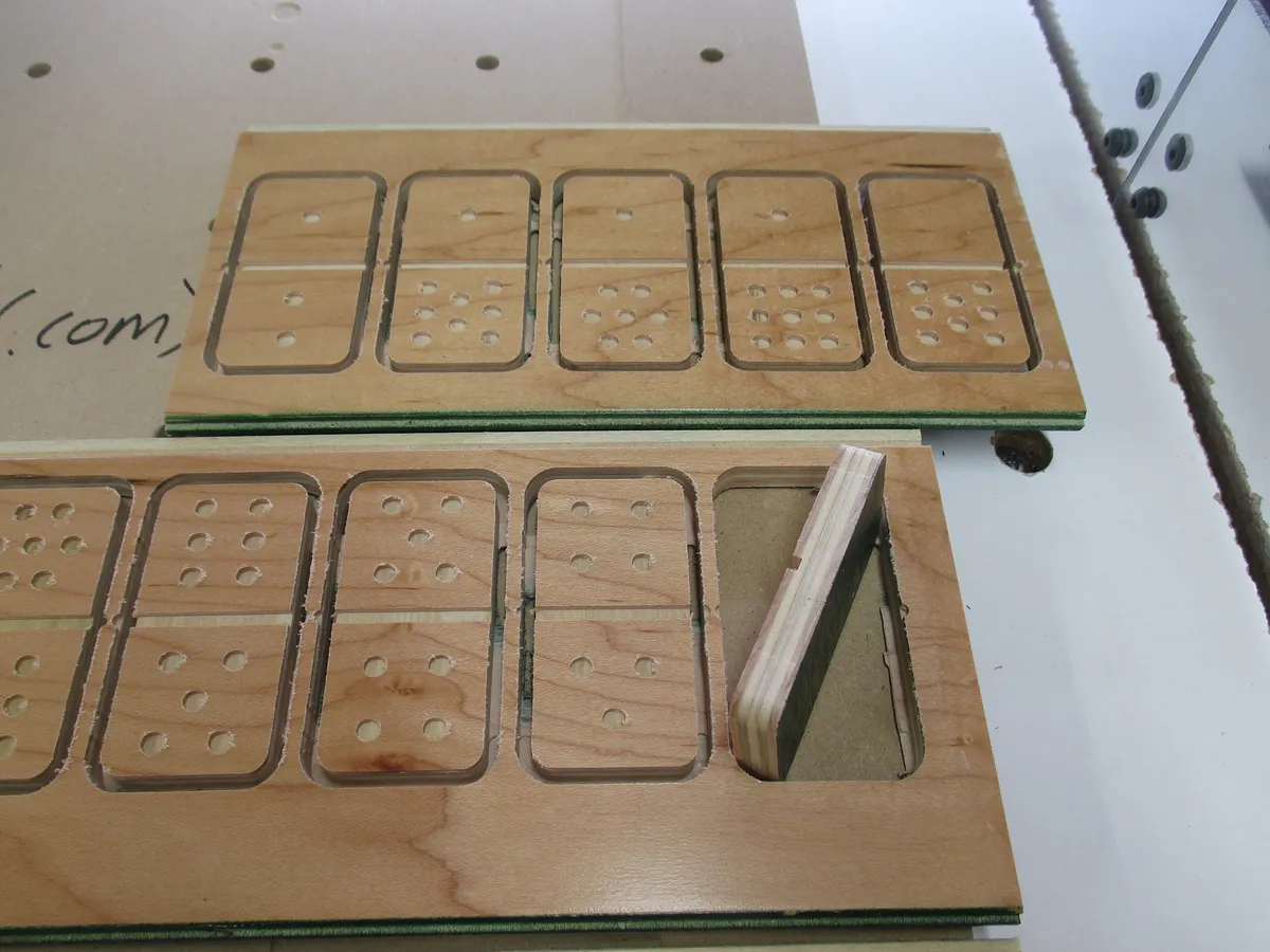

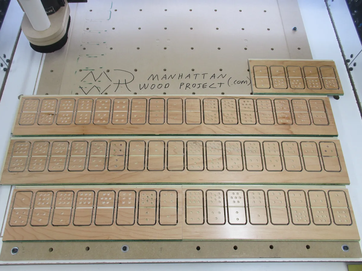

Cut the Dominoes
I have the Dewalt 611, and used these settings:
Bit: 4 flute upcut, flat end Dewalt 611 speed: 2 Depth of cut: .040 inches Feed rate: 80 inches per minute
Arrange the dominoes in the Easel project file as necessary for the size of wood you are using. For dominoes that are not part of the immediate cut, you can do one of the following:
a) Make a copy of the project for each piece of wood, and erase the dominoes that won’t be included
OR
b) Set the cut depth of all other dominoes to 0 inches/mm.
The shapes/figures were all cut 0.075 inches deep so the bit would cut completely through the first ply.
Estimated time: 180 minutes
