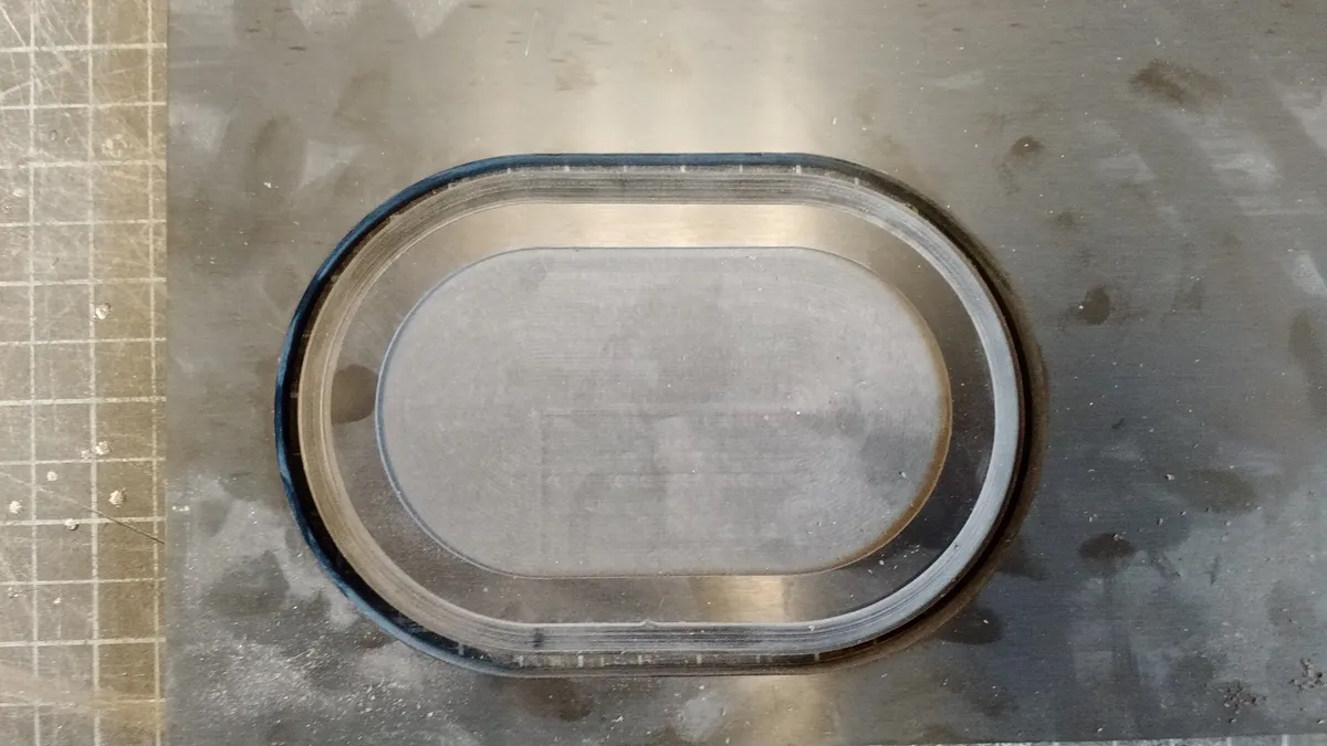

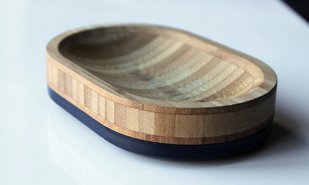

Mill dish interior

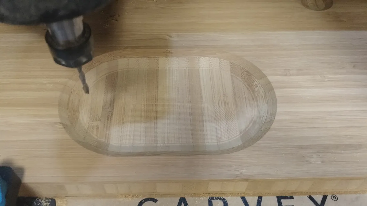

Mill the Dish shape out of 3/4 inch material (Bamboo looks really good!) Use a ball nose bit for the best surface finish.
Use this EASEL "link":http://easel.inventables.com/projects/oIrhkI0glTTxB0YEOj7CYA

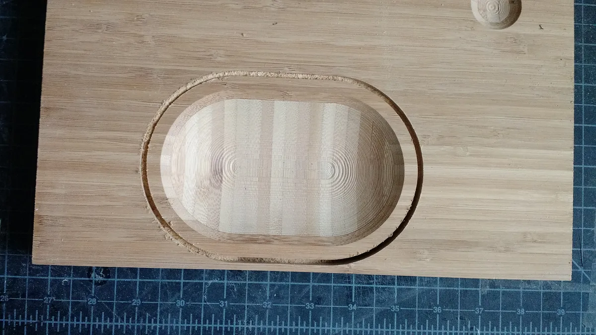

Cut dish profile
Change bits to a square endmill and cut out the shape of the dish.
This piece looks nice on its own and would make a nice finished dish.
Use this EASEL "link":http://easel.inventables.com/projects/NG3BkHotVxY-wdDIGAD-Ag
Mill pocket into base
Use a square endmill bit to cut a recessed pocket into the base piece. This is to hold the cork pad.
Use this EASEL "link":http://easel.inventables.com/projects/4k_visZZfJhuc7Disr1-iw
Mill fillet onto base
Change the bit back to a ballnose and run this file to carve a round onto the base
Use this EASEL "link":http://easel.inventables.com/projects/JA4p19-w148EUUE4WH-kaQ

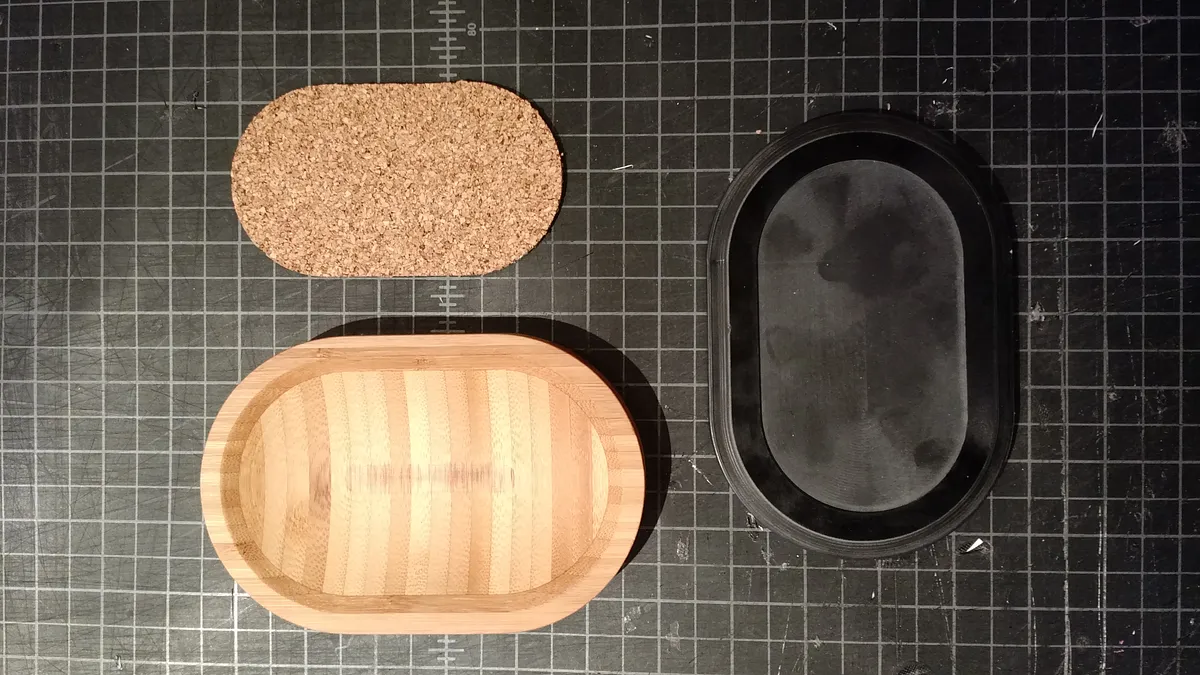

Mill Cork inlay
Cut out a cork pad to attach to the base
Use this EASEL "link":http://easel.inventables.com/projects/OVGeokn2wdeKBNhkwt2iRg

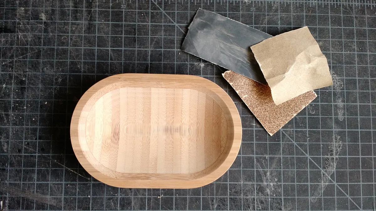

Finish and Assembly
Sand the Bamboo dish for a smooth finish, apply your preferred oil or finish, and glue parts together.
