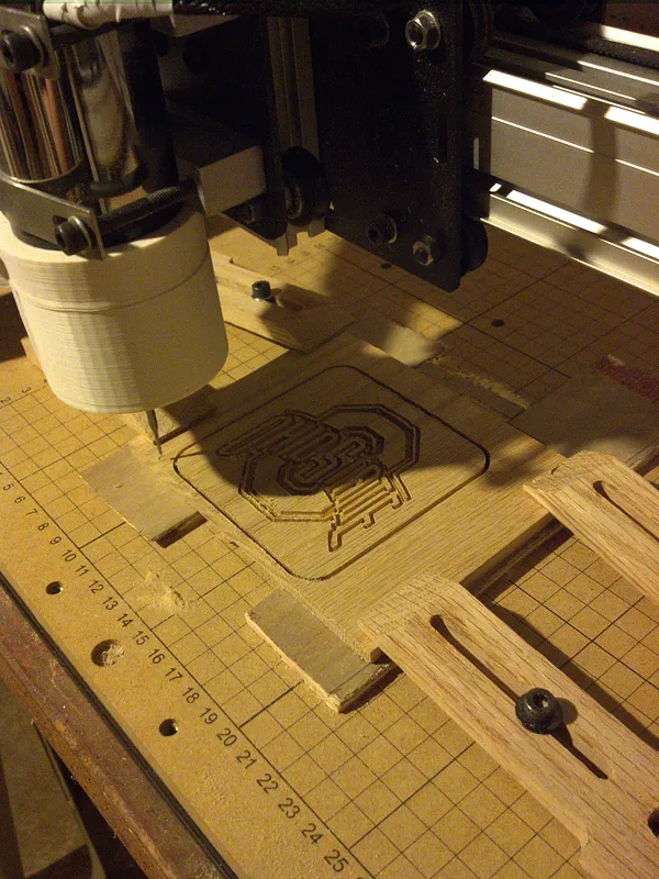

It's just 1/4" thick oak panel. I got it from Home Depot in their "hobby wood" section. You could probably get it cheaper from a local lumber yard or mill
I used a 1/16" generic dremel-type bit to get the detail on the interior. You could probably use a 1/8" for the outline. If the edges chip, you could switch to a downcut but I didn't need to.
I imported the SVG from the thing referenced on the thingiverse link. You could probably use the experimental image->vector tool in Easel to bring in whatever you want.
Unless you’re mass producing them, the NCAA isn’t going to waste their time pursuing using the logo. I make rustic coolers with logos made into the sides of universities & NFL teams all the time. Done so for years & never once heard from either organization.
In Easel, the material is listed as 12.7mm which is 1/2", but you said in an earlier comment that it was 1/4"? It looks like 1/2" in the pic but I was just looking for some clarification.
Where did you get the material from?

What Bit did you use to carve this if i may ask please?
Paul Kinlaw · May 16, 2015
