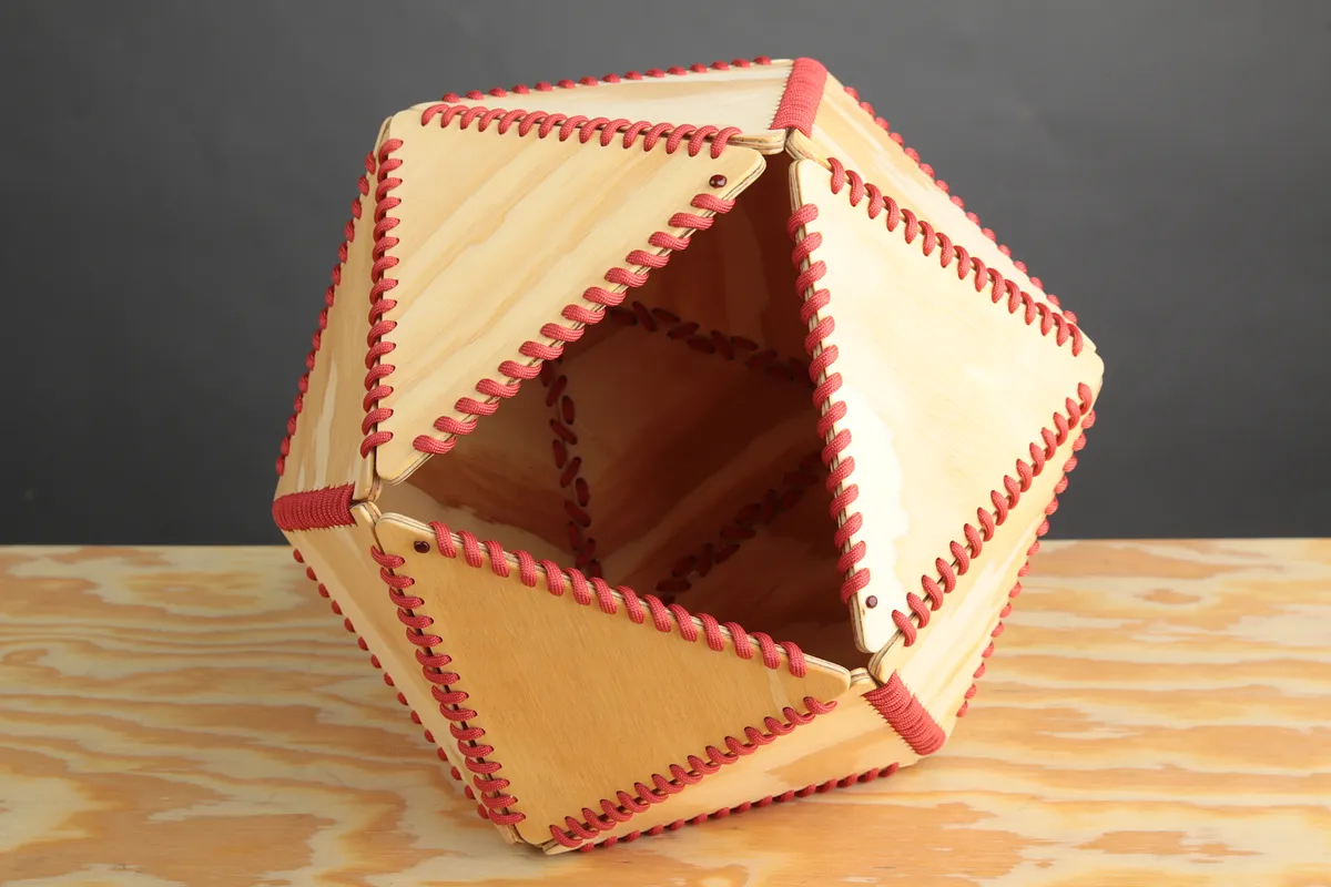

Make it with an X-Carve or with WoodWorking Tools. You decide, like a choose your own adventure!
If you are using the X-Carve simply scale the Stitched Wood Icosahedron up or down to fit your needs. A few of the Ideas I had were christmas tree topper, hanging holiday ornaments, bowl, basket, pet cave, lamp shade, lamp base, decorative vase.

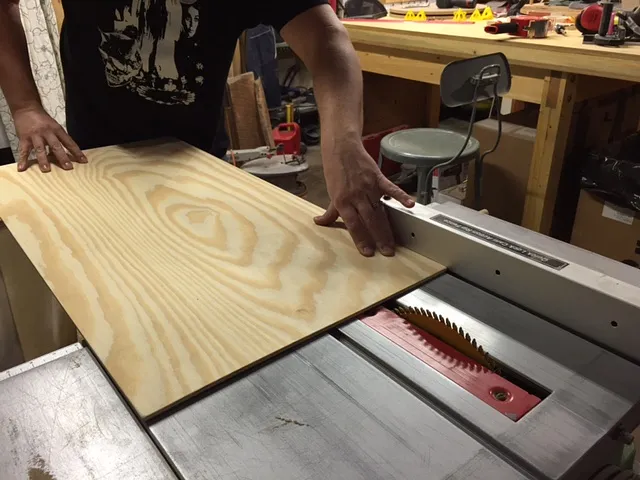

Table Saw

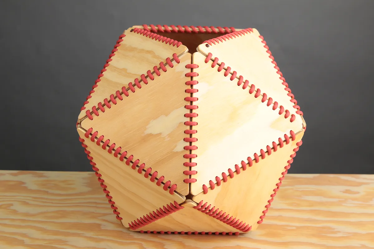

I used my table saw to rip lengths of 1/4" BC Sanded Plywood down to 6" wide strips.
Estimated time: 2 minutes

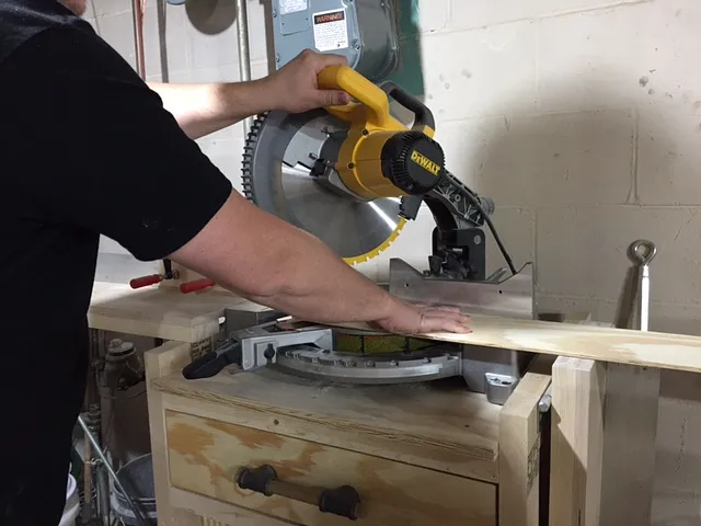

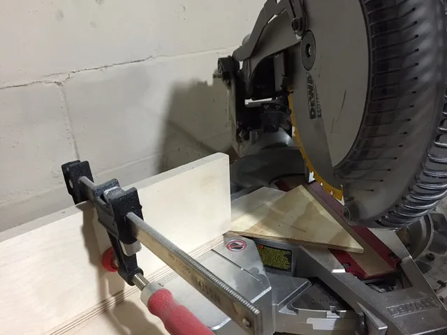

Miter Saw
I set up the miter saw to cut 60 degree angles, I also attached a stop block. This set-up allows me to make a cut, flip the board over, cut, flip, cut, flip, cut... you get the point. What you left with is a bunch of triangles. You will need 20 in total for a full Icosahedron.

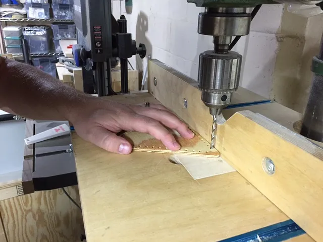

Drill Press, Drill 900 Holes!
First off you will need to mark locations for the drill holes. Each triangle has 15 holes on each of its sides for a total of 45. These holes are spaced 3/8" apart, and sit 1/4"oc from the edge of the triangle. Then I set up my drill Press with a 5/16" Drill Bit. Set the Fence and started drilling. ...nine hundred holes...

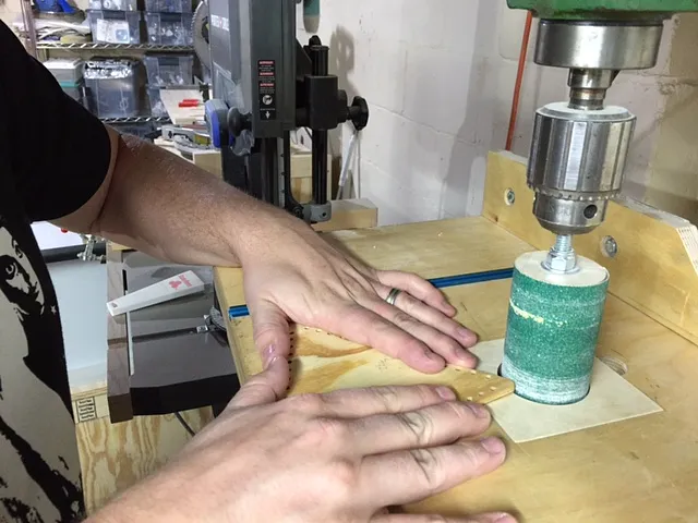

Drill Press, Drum Sander
I switched out my drill bit for my drill press drum sander. I used a metal washer and traced a curve to round out the pointy triangle, angles. Then with the drum sander I rounded them out by following the line I had just traced.

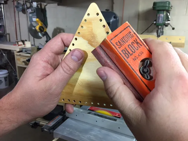

Sand it Smooth
I took my sanding block and sanded the edges smooth.

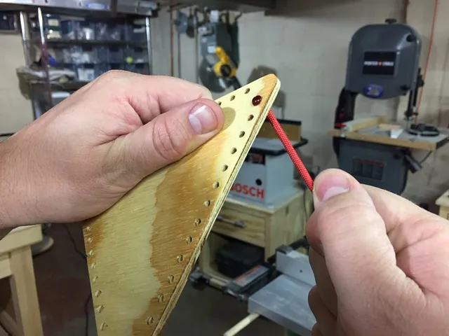

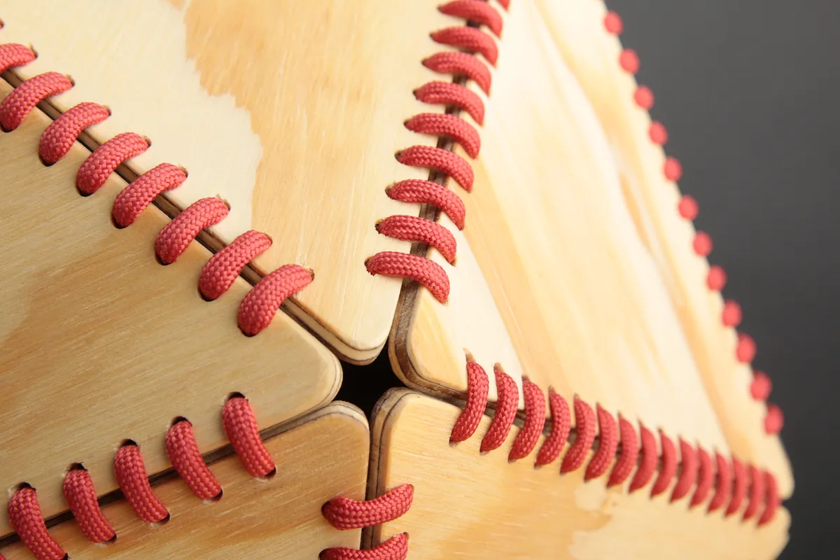

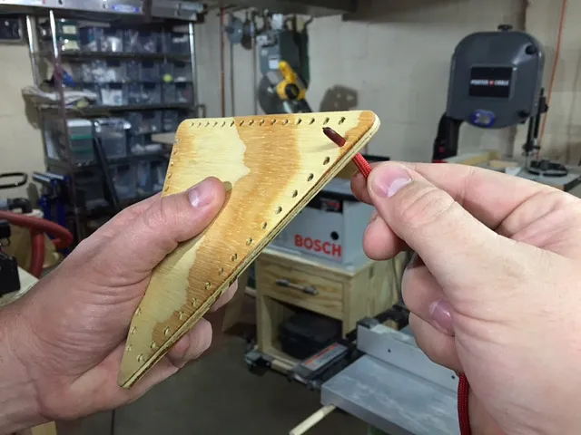

Stitch it Up

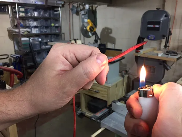

I used paracord to stitch this Icosahedron together, but you can use anything of similar diameter. Bailing twine or Zip-Ties could be cool. I melted the ends of the paracord. For one end I melted it and pulled it into a point, this allows me to thread it in the holes really easily. The other the I melted into a mushroom shape with helps it hold inside a hole, good for keeping the ends of the rope in place. There are no rules for the style of stitch you use, so go nuts.
Estimated time: 120 minutes

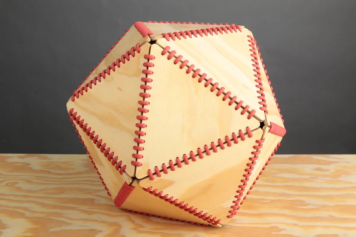

You Did It!
By this point you should have a finished Icosahedron, and you are probably thinking:
