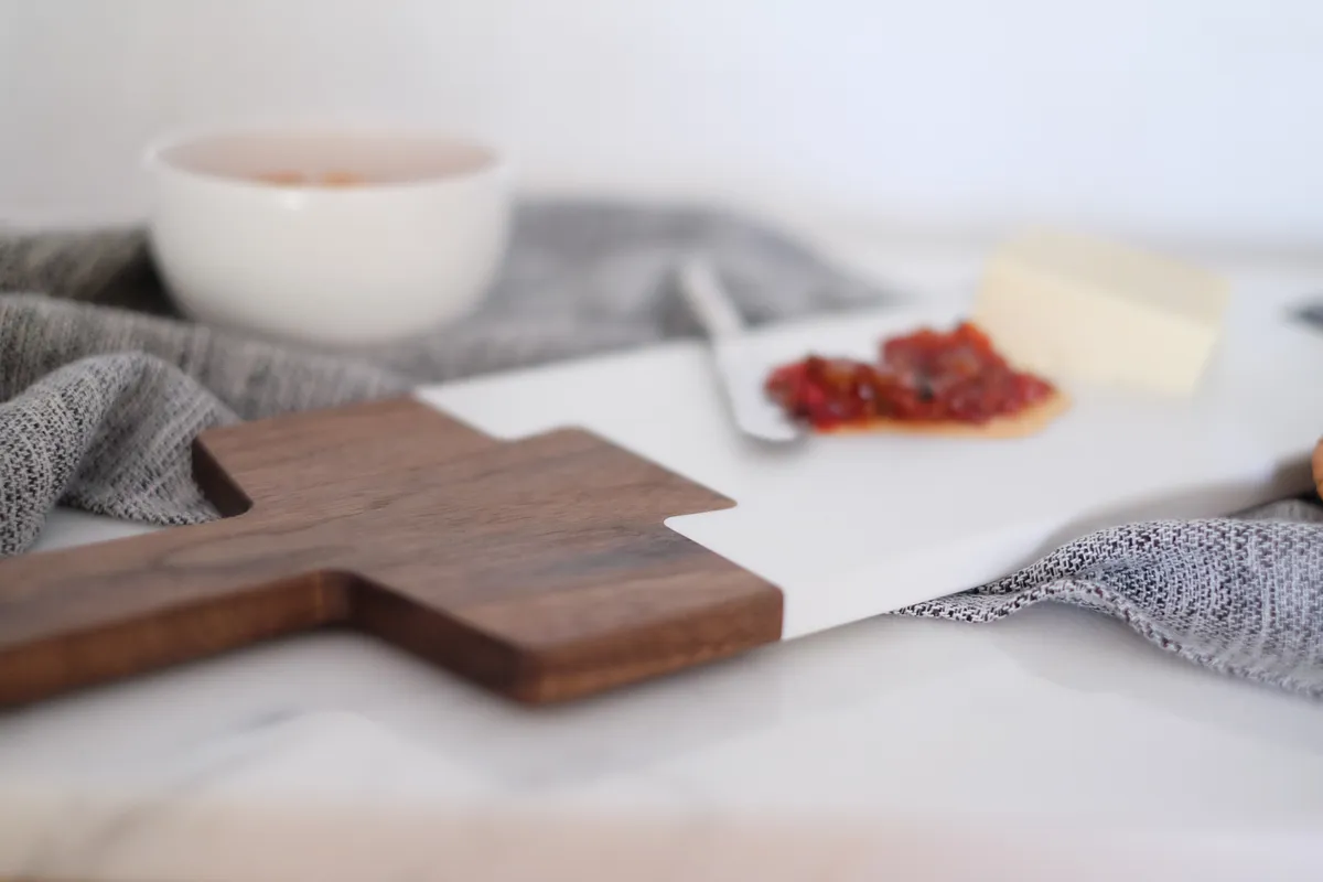

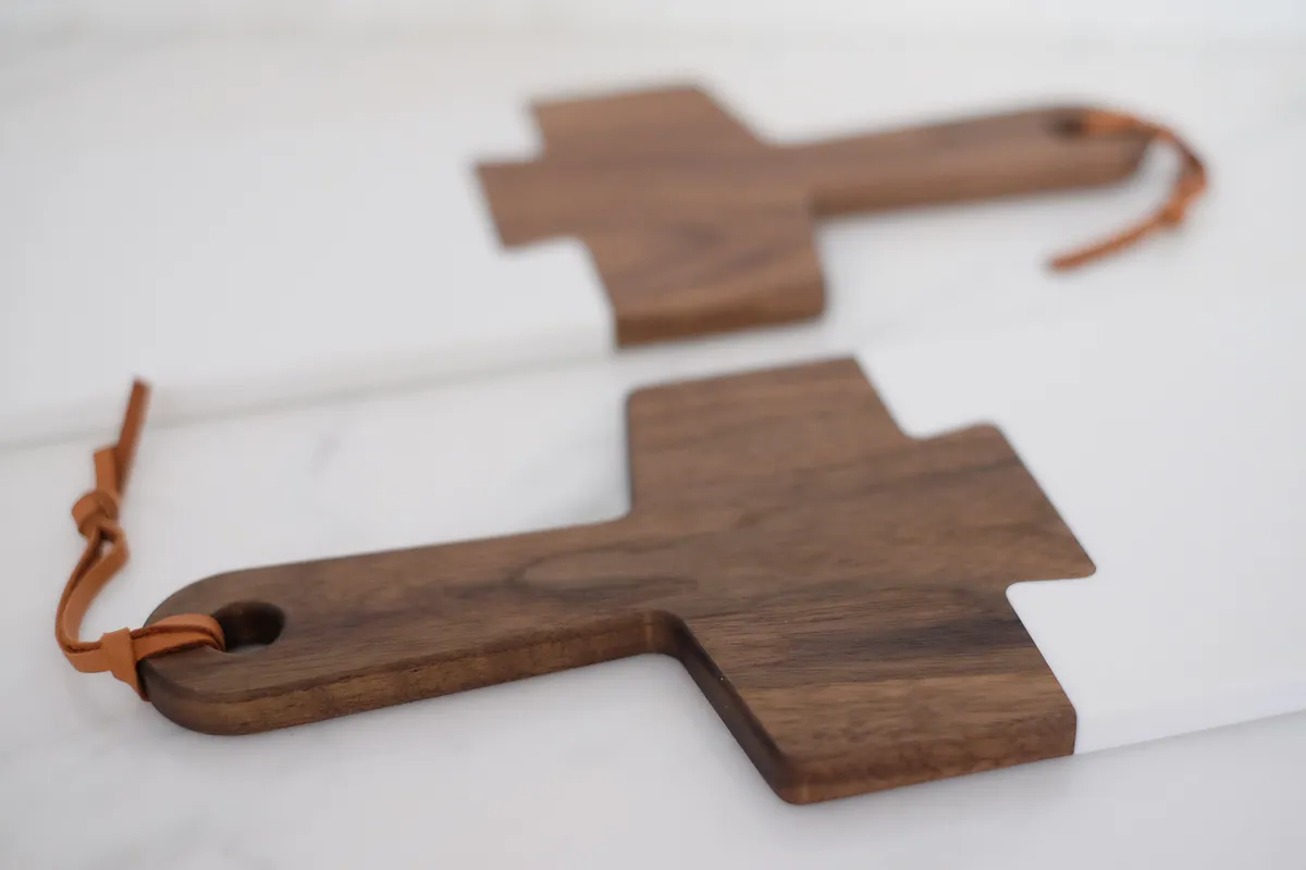

I like the joinery. Did you use glue?
John McWhirterPro · January 12, 2018
Thanks! Yup, and the half aspect of the joint has a large surface for the glue to work on instead of just a butt joint :)
