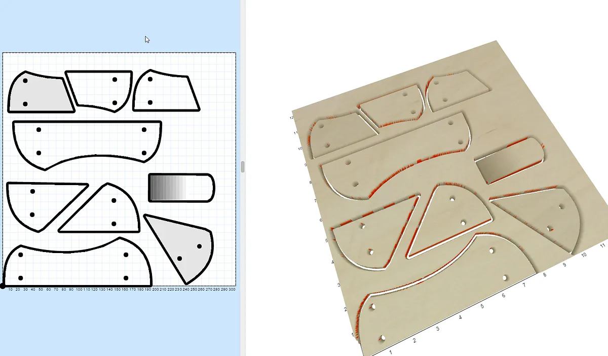

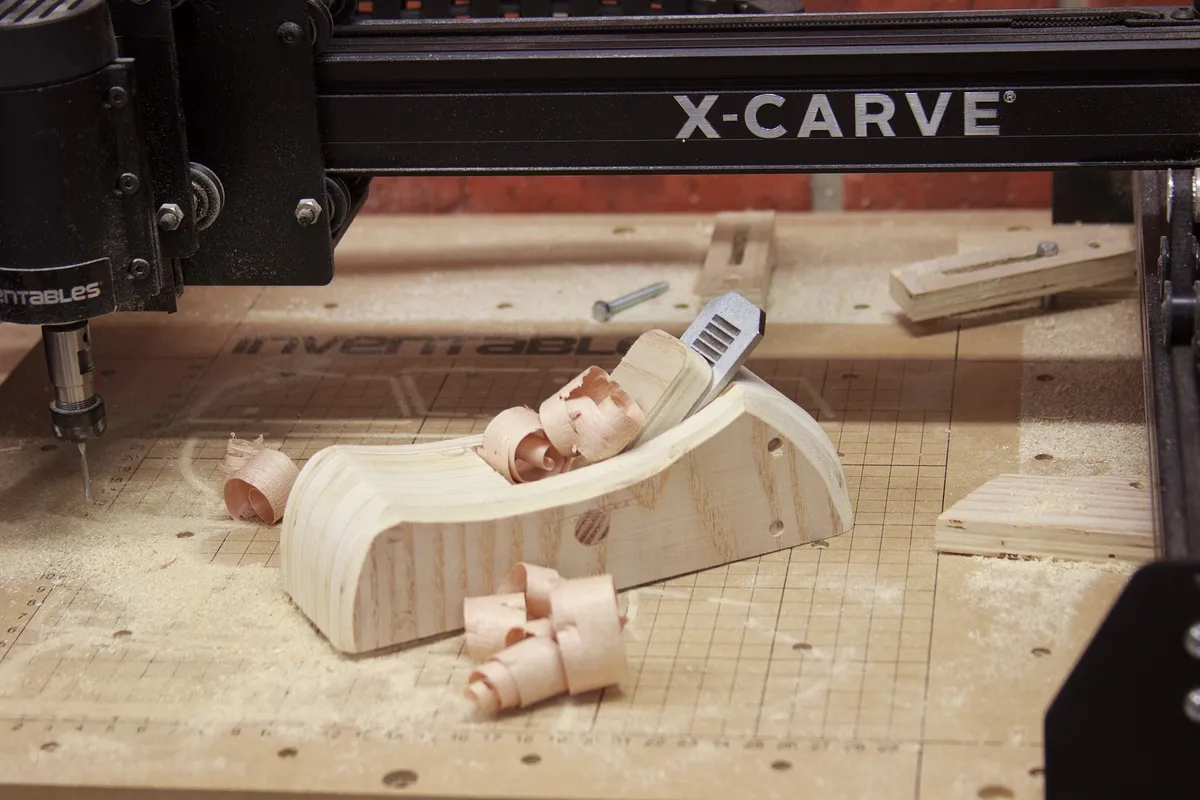

Open the Project in Easel
Open the project in Easel. Depending on the thickness of your ply and the thickness of your plane blade, you may need to adjust how many layers you need, or if you need a layer to be thinned down.
There are two outside pieces and six (two of each side) inside pieces - adjust the grey inside pieces to compensate for your blade width.
ie Blade width is 34mm, using 12.7mm ply = 38.1mm. Reduce one inside layer by 4.1mm
Set up your material and secure it tightly to the wasteboard.
Estimated time: 5 minutes

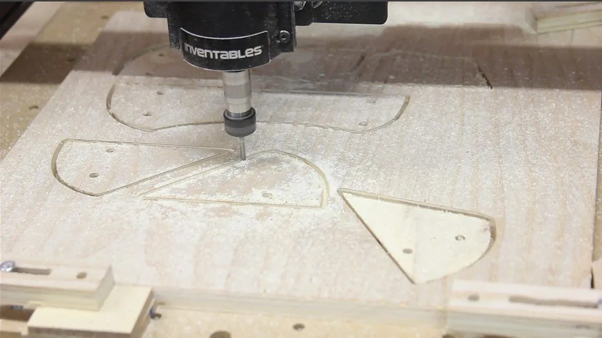

Carve
I used a 1/8" straight flute, sit back and.. wait.
Estimated time: 60 minutes

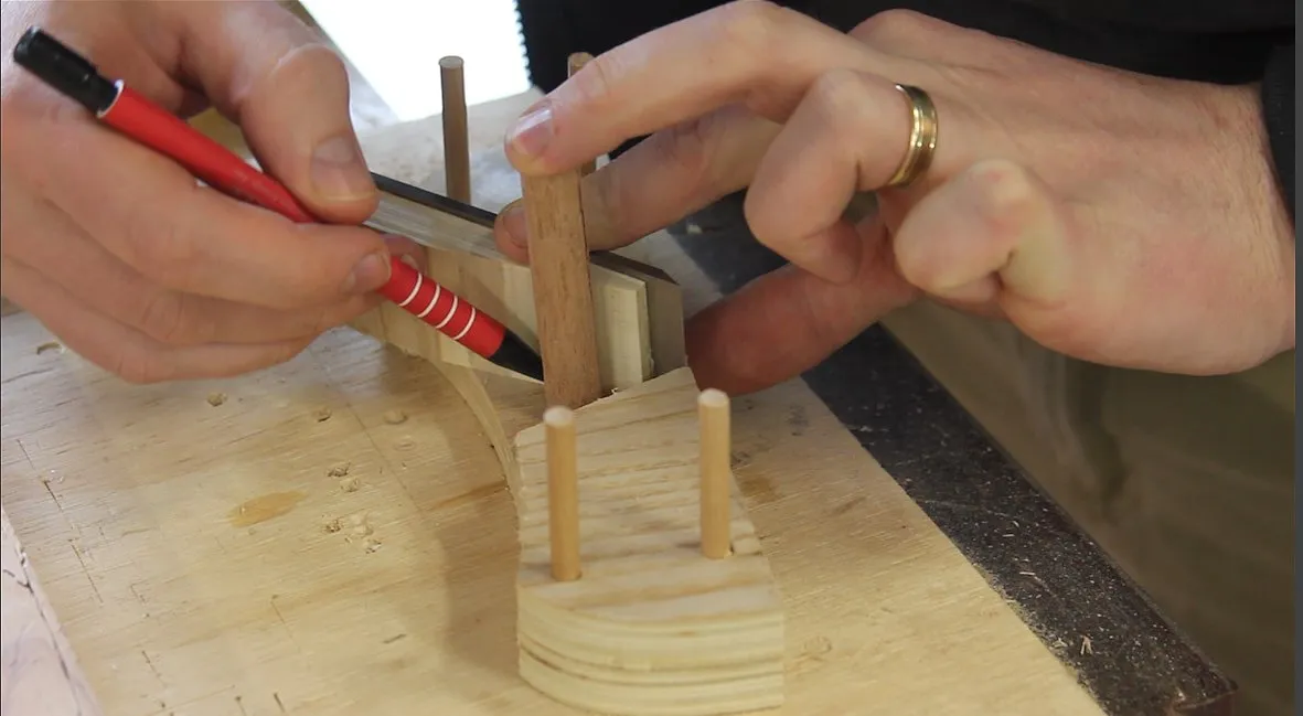

Drill cross pin
- Dry fit one outside piece with one inside layer (both pieces).
- Place your blade and wedge on the ramp, and mark where to drill for the cross pin. This should be far enough up to allow the wedge to slide and tighten on it
- Disassemble, reassemble both outside pieces and hold together with the dowels.
- Drill out for the 1/2" cross pin

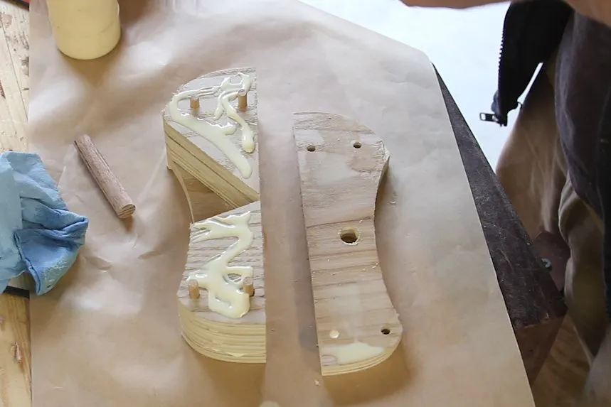

Glue
Apply glue to the inside layers (both sides) only - try to avoid getting any glue in the ramp area.
Estimated time: 30 minutes

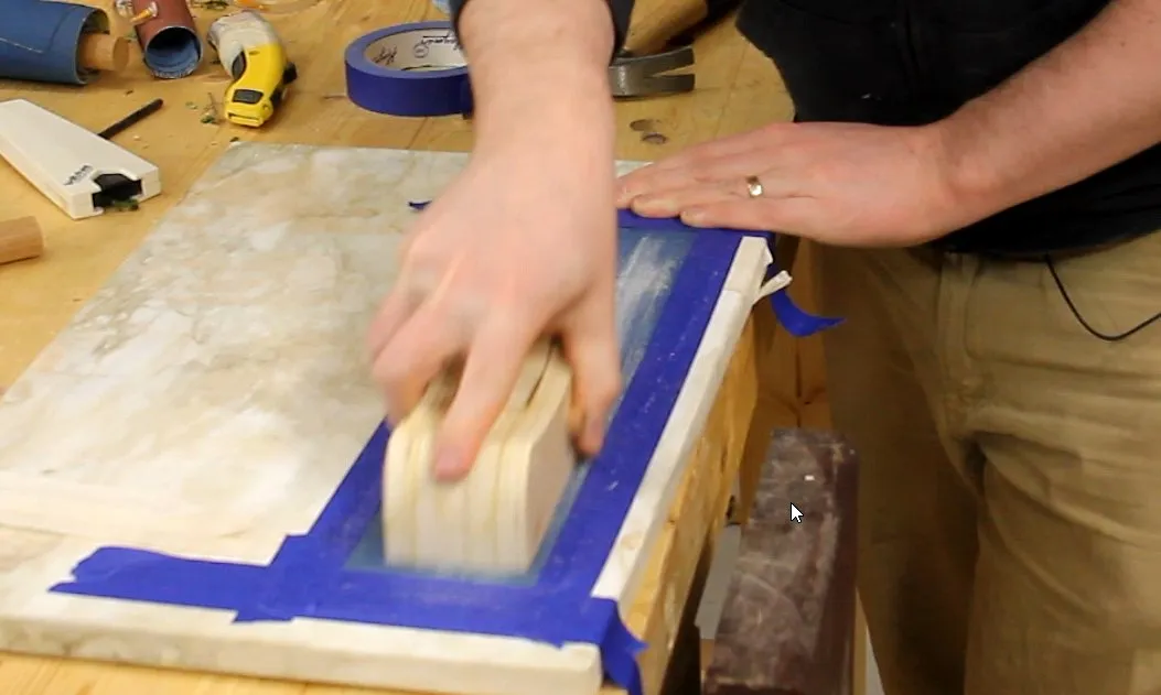

Sand
Install the blade and wedge. The blade currently should not poke through, but retract it a little bit back up the plane.
Tape some 80grit sandpaper to a flat surface (a table saws cast iron surface, a block of marble, etc), and sand until the mouth opening is wide enough that you can get the blade through and the sole of the plane is flat.

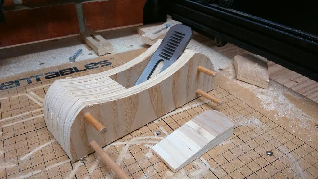

Make shavings
Vrooooooooooooooom! Your new hand plane should be ready to go! If you want, use sandpaper or a rasp/file to provide additional smoothing to the edges, and finish it with boiled linseed oil
