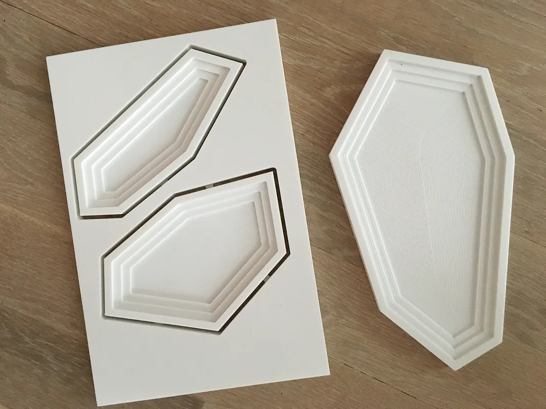

First, I obviously came from YouTube :), just here to find out the size of the bit (diameter) and the thickness of the material as I want to do a Mortise and Tennon joint in the project
Conal · August 10, 2017
I have a question: I'm assuming you needed to carve both sides of the corian. How did you do this? Did you just turn the Corian over?
Sophia Goehner · August 10, 2017
Hi Sophia if you want to do two sided carves you flip the material. In order to flip and center your work you need to have a way to align or register the work. If you make 2 holes that are symmetrical to the design and carve them into the wasteboard then use two pins to line it up on both sides.
Zach KaplanPro · August 12, 2017
Hi Conal, Looks like Ben used a 1/8" bit 1/2" Corian material. inventables.com/technologies/white-corian

can i have a diagram re flipping the corian to carve both sides i cannot get my head around Zac;s explanation thanks
eddie hall · January 09, 2019
1.On the first side of the project you need to design a pair of "hold handles" on the top and bottom of the shape, They will guide the alignment when you flip the project. 2.design the cut to remove the alignment handles on the back side cut or use a saw to remove them when everything is done.
