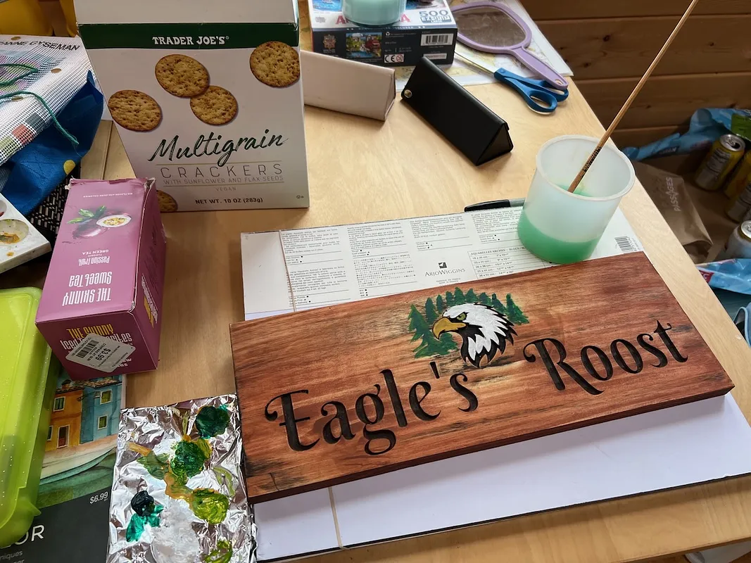

FINISHING
After carving:
• Break sharp edges with a sanding block or 1/8" roundover bit.
• Sand lightly to remove fuzz from the V-carving.
• Paint the carved lettering and artwork. It is OK for paint to extend slightly onto the surrounding surface.
• After the paint dries, sand the face of the sign to remove excess paint and expose clean wood.
• Apply stain and/or your preferred protective finish.

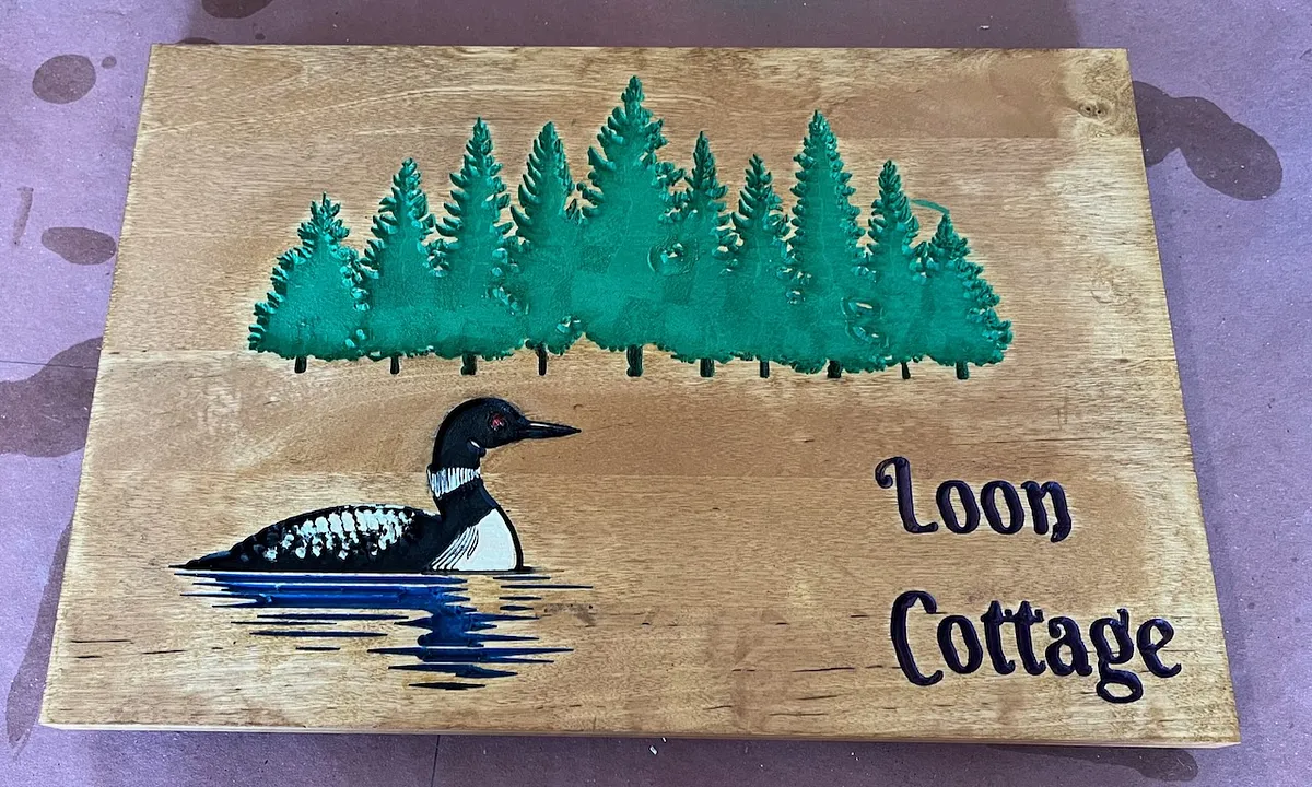

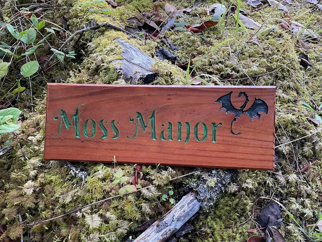

CUSTOMIZING THE DESIGNS
These workpieces are intended to be starting points.
• Duplicate a workpiece before modifying it.
• Change the text to your cabin, cottage, ranch, or family name.
• Replace or reposition the artwork as desired.
• Adjust font size and spacing to fit the new wording.
• Verify all cut depths and toolpaths after making changes.
NOTES
• Standard 1 x 6 lumber is particularly convenient for these designs because its actual width is approximately 5.5".
• Poplar engraves very cleanly and is inexpensive.
• Maple and cherry make particularly attractive signs when the natural wood grain will remain visible.
• Cedar and redwood are good choices for a more rustic appearance.
• The individual workpieces are examples rather than fixed designs. Experiment with names, fonts, artwork, wood species, paint, and finish to make each sign unique.

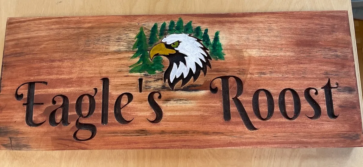

Thank you David. Three of these signs adorn three properties up north. The "Eagle's Roost" cabin owner is actually an artist, and she finished that one. But I'm proud of my other signs, but also find the finishing step challenging, and have tried a lot of different techniques.
