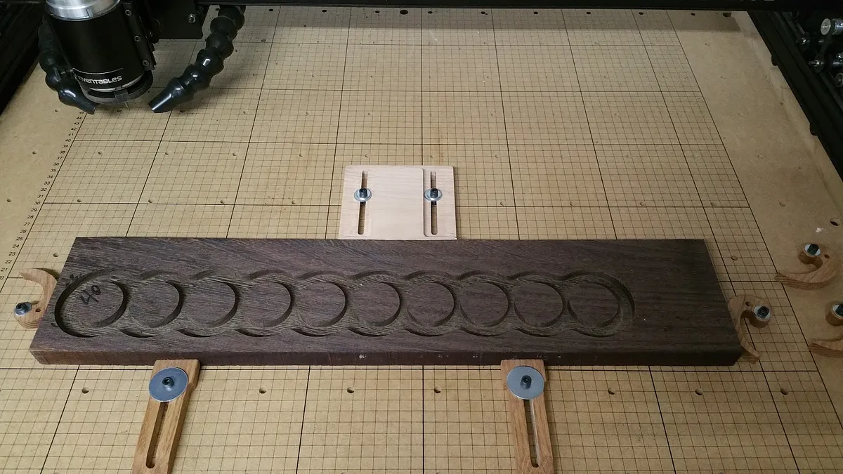

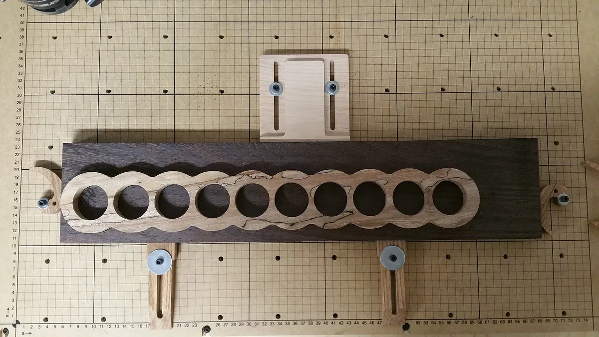

Cut the design out in easle, one part cut out with a fill cut and the other with an outside cut.

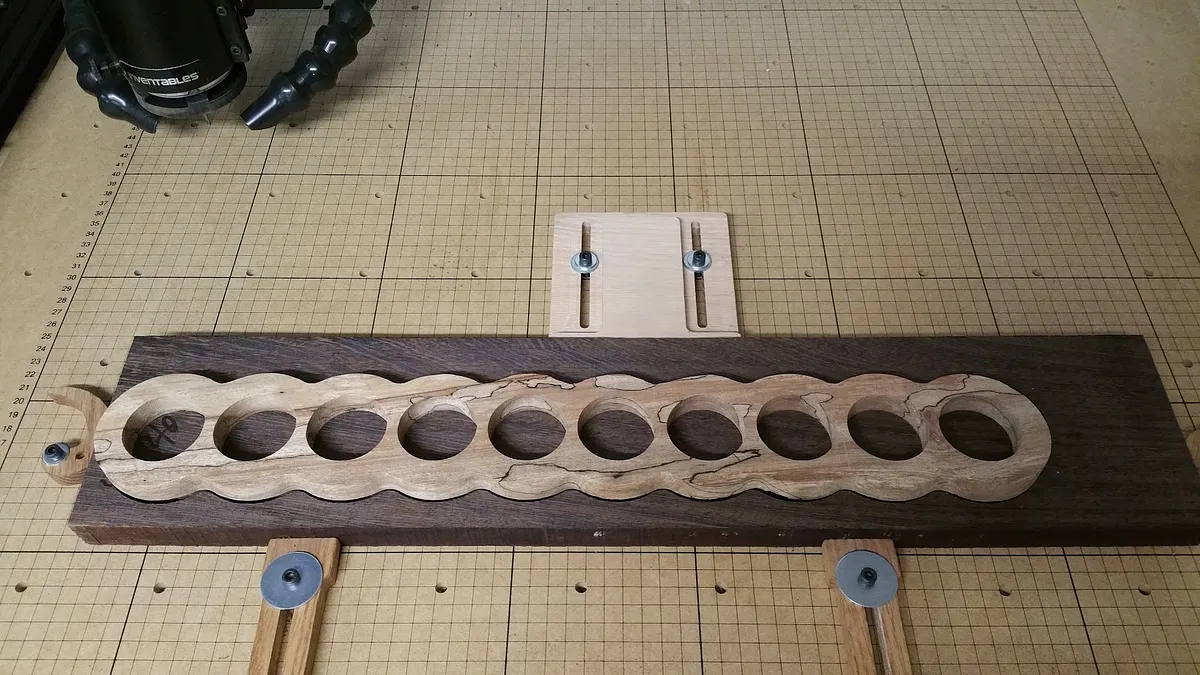

Glue up
Glue the two parts together and then use a planer or sand to get the two wood cuts level.

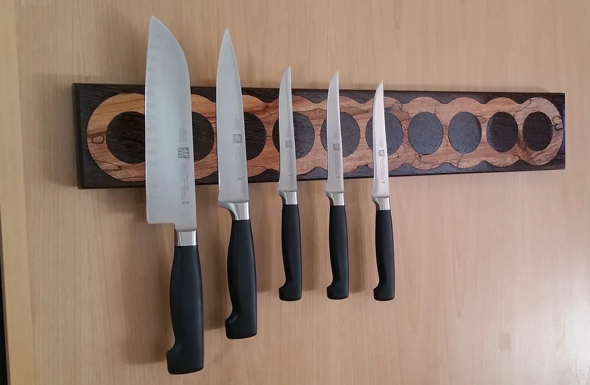

Add magnets
Use a forstner bit or easel to cut out holes in the back of the board to place the magnets. Then glue them in place.

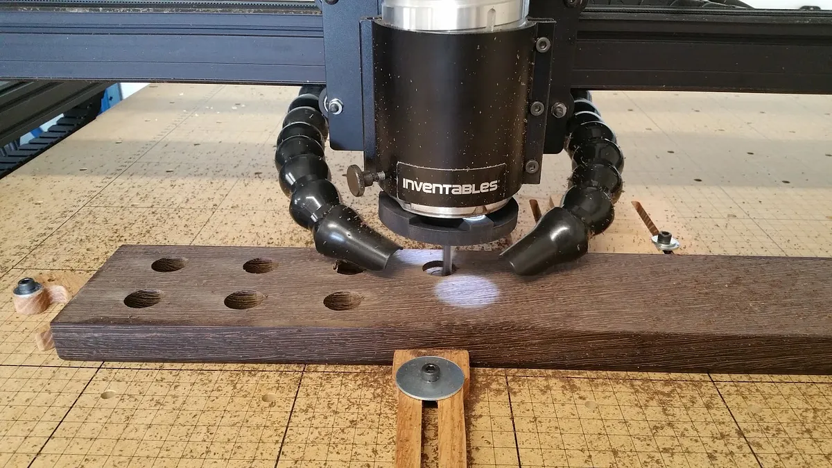

Very creative! Any chance you could add a pix showing details of your vacuuming system? I'm planning on using a Makita router and these "lock line" tubes, but, the devil is in the details of mounting and connecting to a vac. Thanks!

What kind of magnets did you need to use to hold the knives?

For magnets, there are 20, 3/4 x 1/8 inch disc magnets from K&J Magnetics. I wrote up a project for the Loc-line here: inventables.com/projects/line-loc-pipe-clamp

Looks great. I second Gary Linn, what is that vacuum system you are working with?
Chase Bean · February 25, 2016
did you sand down the second part cause it looks much bigger
