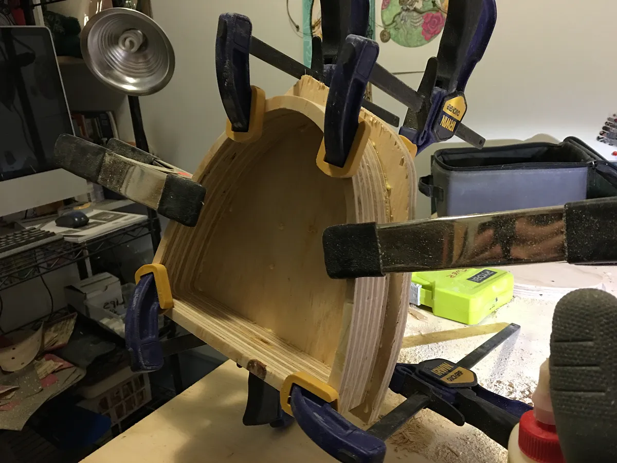

Cathedral Build

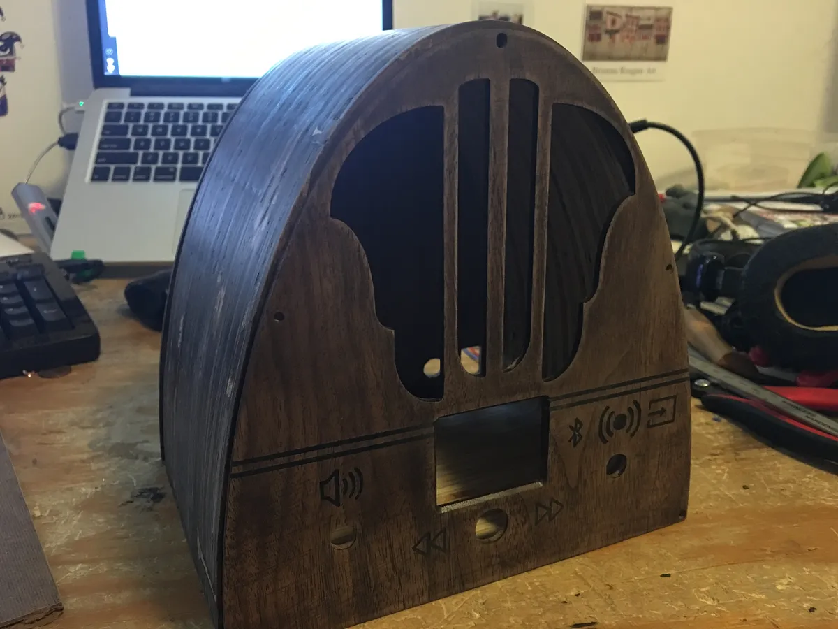

- Cut out one cathedral rib and use that as a template with a hand router. (I found this cut down on the cnc time significantly)
- Cut out the front panel (I used several different sized bits for this)
Cut out the back panel
Glue the ribs together to give it about 5" of depth
Sand/stain the entire thing

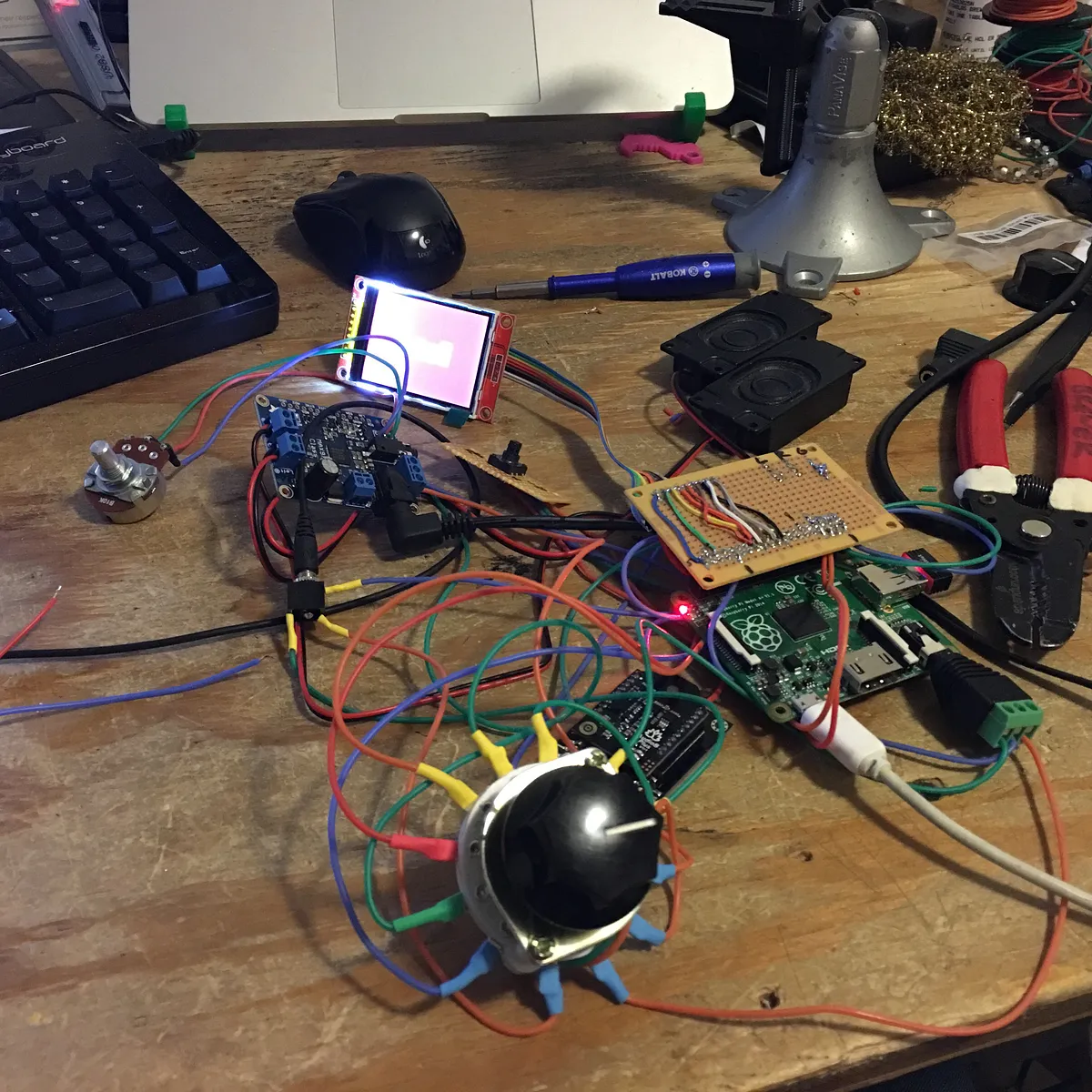

Electronics Build
This is really going to depend on how you set up your system.
The biggest tip I can give is that I used the 3 pole switch this way... each audio source is broken into Left/Right/Ground. These all go into the switch, so each position represents one source. All the outputs are fed through the switch to the amp.

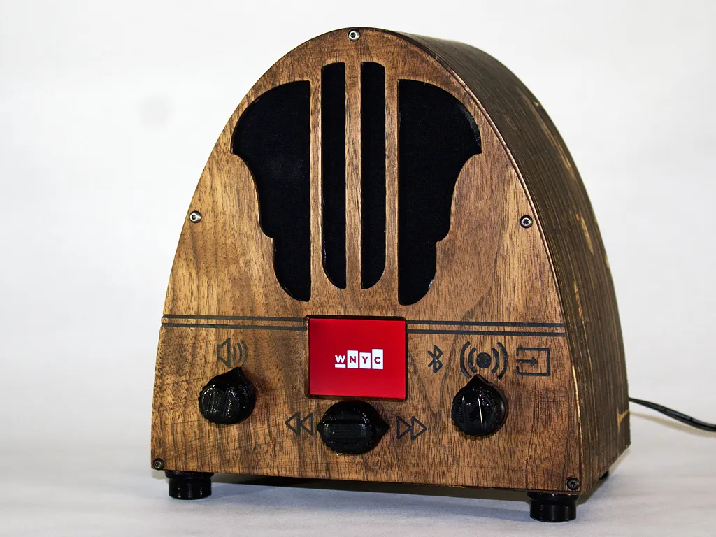

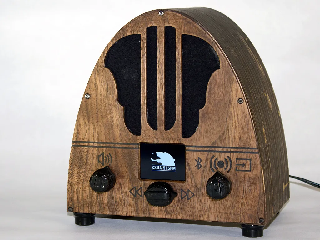

Finished!
It's not an incredibly difficult build, but is a great way to help hone your making skills.
