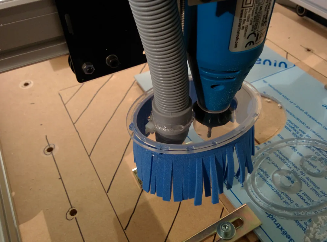

Dust Extraction Cap
dust extraction cap for use with standard Shapeoko2 Spindel and a 25mm hose adaptor.
Cap is made out of 3mm acrilyc, the brush is made from a soft 2mm rubber sheet.
Awesome! I've been looking for something like this. Where did you get the hose adapter / hose? What kind of vac?
Paul Kaplan · January 14, 2015
Hi Paul, I've used a dish washer drain extension hose :-) And a standard, but compact, dry/wet vac. The 2 hoses fitted nicely into eachother. The blue rubber sheet material came from a hobbystore near me. Hope this helps! Best Regards!
Michel Delvaux · January 15, 2015
ebay.com/itm/Washing-Machine-Dishwasher-DRAIN-Was… ebay.com/itm/Ridgid-6-Gallon-Wet-Dry-Rolling-Shop…
No, I didn't notice any difference in performance ;-)
Michel Delvaux · May 28, 2015
One thing I notices in making my dust boot was to keep the brush short. Because as you cut the mill gets lower and lower. At some point the brush can get caught in the tool. The only way I know to deal with this is to make the dust boot larger, or be sure the brush cant touch the tool. ;-)
