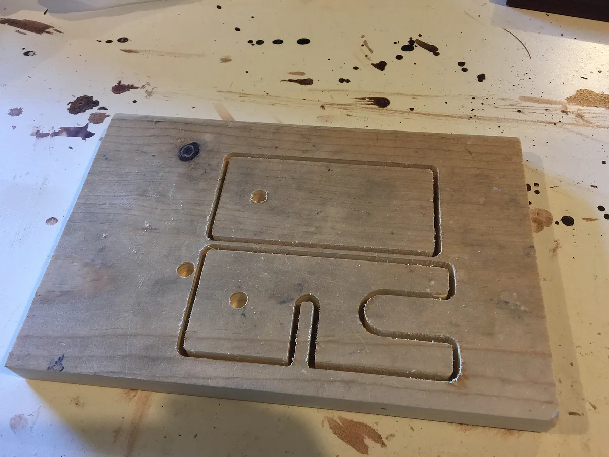

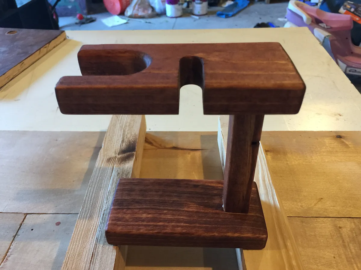

Carve the base, top, and post out. I chose to just cut the post on the table saw.
Estimated time: 19 minutes
Sand and route edges!

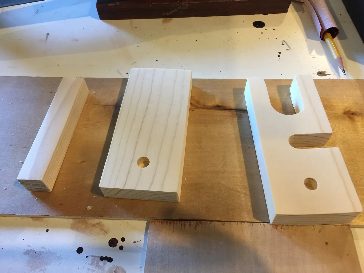

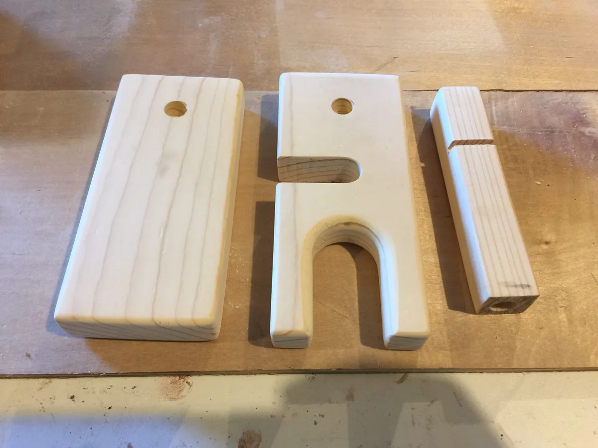

Sand all the pieces. I only have a mini CNC machine, so it took a while to cut out and the edges were pretty rough. I started with 120 grit and finished with 220 grit. I then used a 1/8 inch round over bit on the router to break all the edges. Then used a 1/4 inch round over on the inner brush holder. This fit the contoured handle of the brush nicely. I also used the table saw to cut the notch in the post. I used a drill press to make the holes in the post, but a regular drill would do just as well. I used 3/8 inch diameter dowels, but you can use whatever you have, just make sure you adjust them in the base and top as well.
Estimated time: 20 minutes
Assemble and finish!

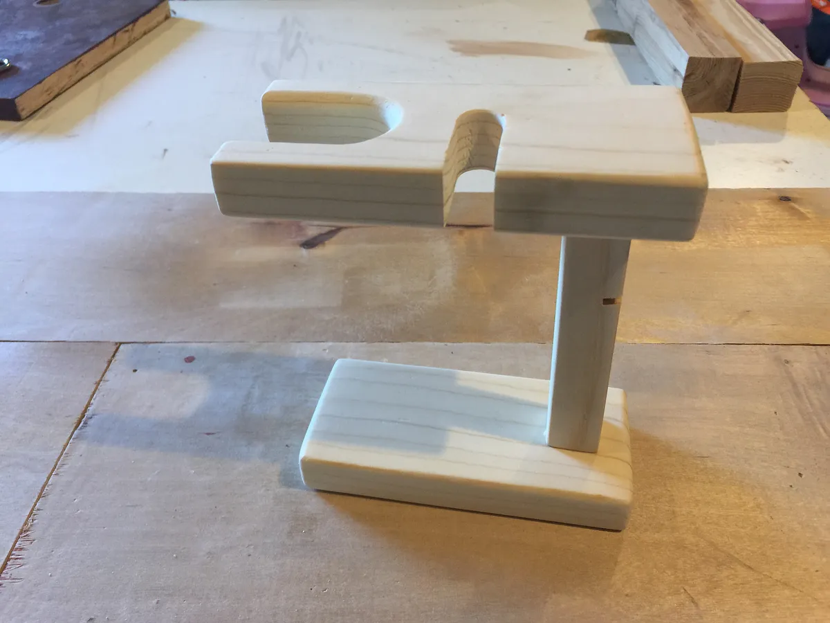

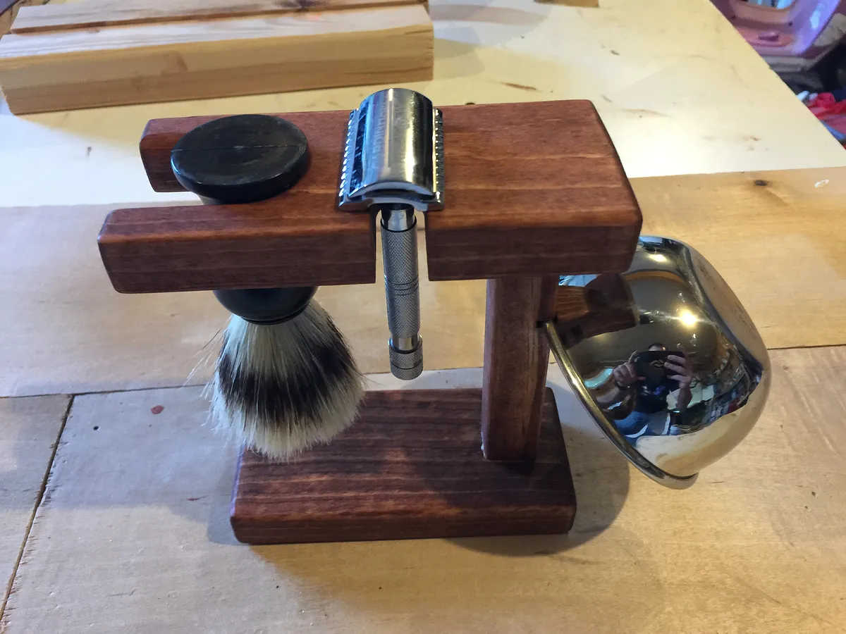

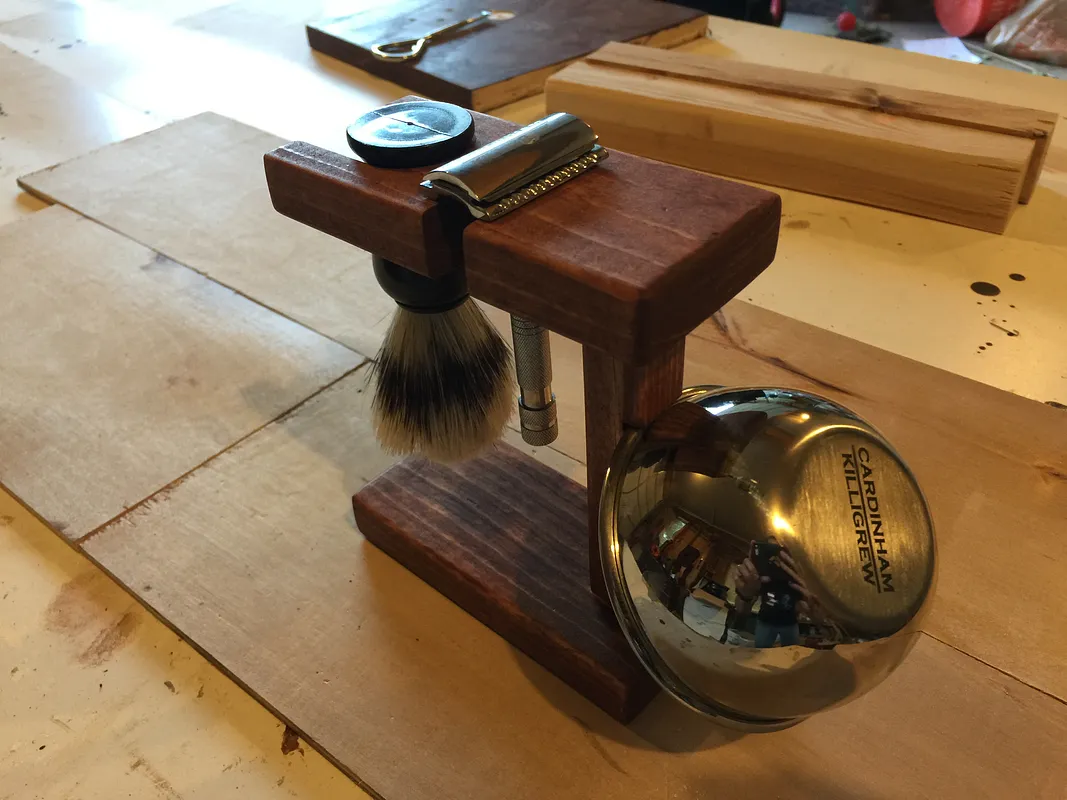

Assemble the stand with dowels and glue. Let the glue dry enough then you can begin finishing the stand. I used a nice dark stain. Then finished it with some clear coat to protect the wood from water.
Enjoy!
Enjoy your stand!
