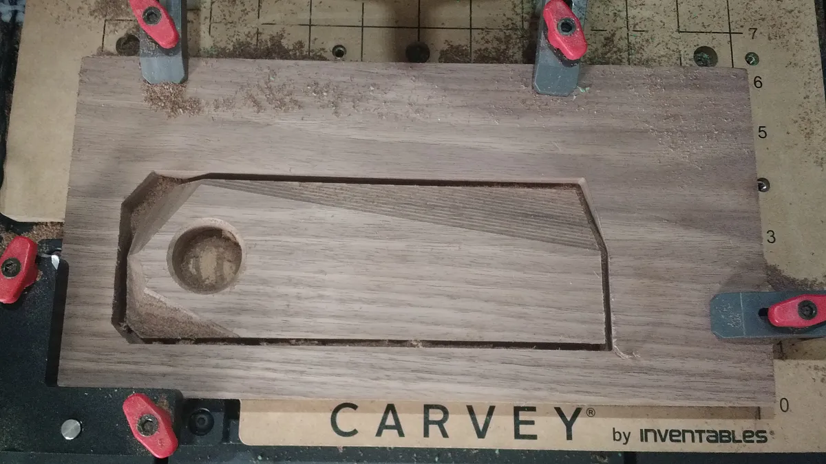

Mill 3D form
For this cut you will need to use double sided tape to secure the 3/4" material to the platform as the gcode was set up without any tabs. Use an 1/8" ballnose endmill for the best surface finish.
Use this EASEL "link":http://easel.inventables.com/projects/nYxigRskjzJNUhu4kxdwwQ
Mill any logo or customization
Before removing the design from the platform you can change to an engraving bit and inscribe your own logo or name onto the top flat surface. I would recommend aligning it to the bottom right corner for a nice balanced aesthetic.

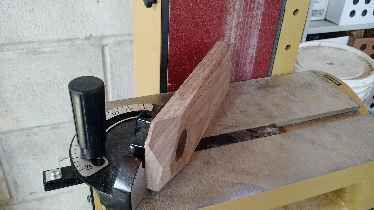

Sand angle for balance
For this design getting the angle perfect is everything. Instead of milling the angle I took it over to our belt sander. This let me set the angle and make minor adjustments to tune in the perfect balance. I found that 42 degrees worked really well.

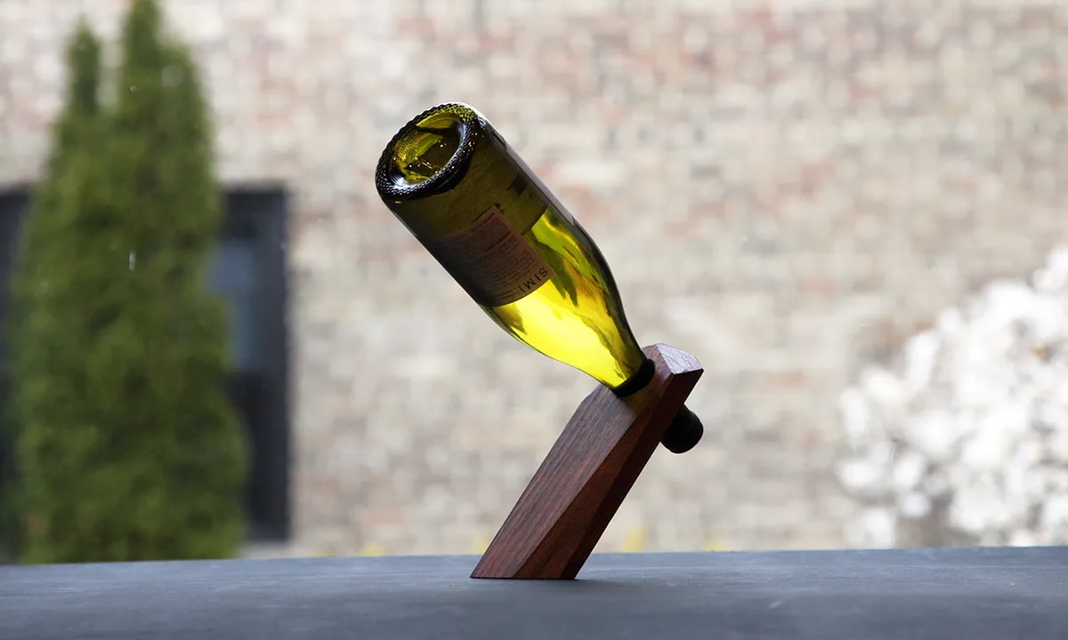

These can be made in all shapes: The trick that I have found is that the base should be cut at 45 degrees and the hole 7 inches from the base
