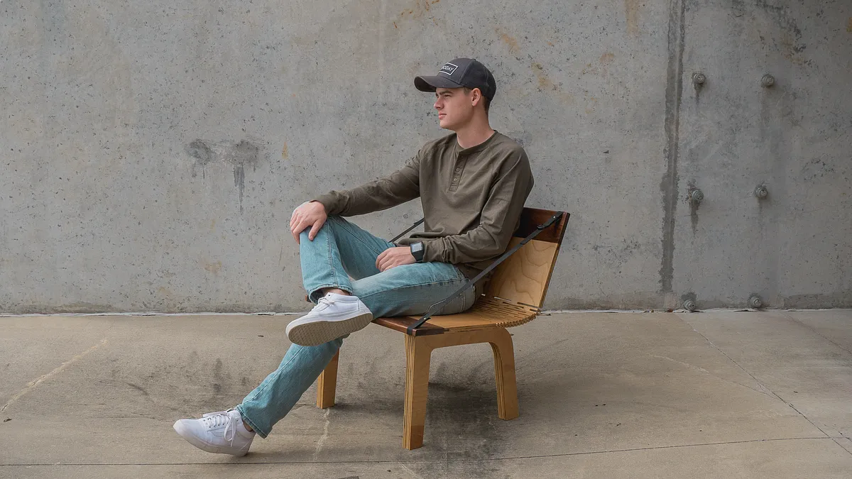

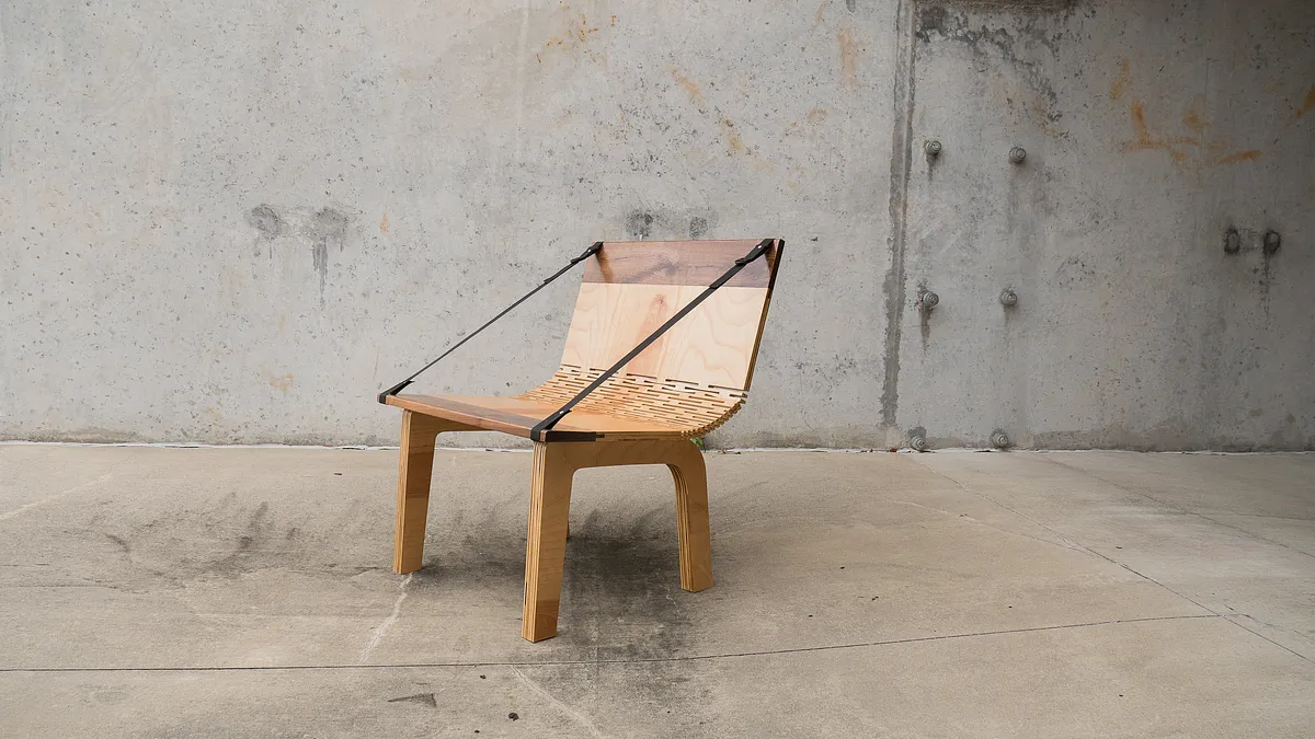

This week, we decided to put our design and engineering skills to the test by building a wooden live hinge lounge chair. The chair is made from 3/4" plywood and has walnut end caps. We used a technique called live hinge, where you take out material in a uniform pattern, which allows the plywood to compress and then bend.

-------Products Used------- • Half a sheet of 3/4" Birch plywood • (2) 1 x 6 x 24 Walnut • Waterlox Finish: https://goo.gl/JE5VHB

very cool. What bit is it that you used? 1/4" single upcut spiral

I have been a woodworker for many years but admittedly I have never cut a living hinge from plywood. Am I missing something here? There seems to be no symmetry whatsoever, other than the Y coordinate. Not all of the rectangles are the same size. The pattern just looks off.
