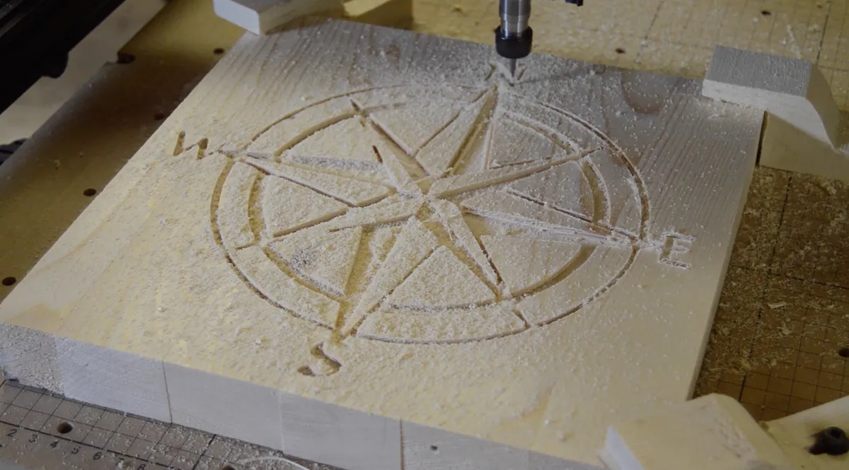

Now set it up at the X-carve to carve whatever design you want your stool to have. If you want your top to be round, you can either program the CNC to do that or use a bandsaw. I chose a 10 1/2" diameter for my stool.

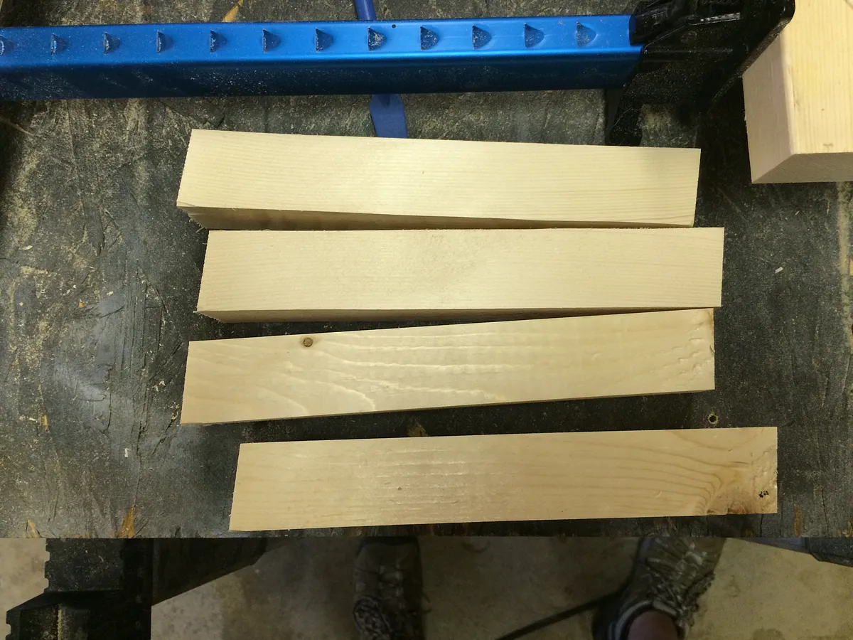

Now cut the stretchers that will support the legs. I cut four for the top and four for the bottom. The four near the top are 4" and 5" with a 7 degree angle cut on both ends (I used the miter saw for this). The bottom four stretchers are 6 1/4" and 5 1/4".

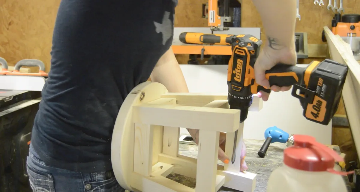

Attach Everything
Start off by attaching the (what will be) top stretchers to the legs. Be sure to use wood glue on all these joints.
Once all four are attached now you can use the pocket holes in the legs to attach the assembly to the stool top. Next, add the bottom stretchers, staggering them slightly so the screws don't run into each other. I just eye balled the placement of these, but they are roughly 1 1/2" and 2 1/2" up from the bottom.
Simple Step Stool — Attach Everything
Simple Step Stool — Attach Everything (image 2)

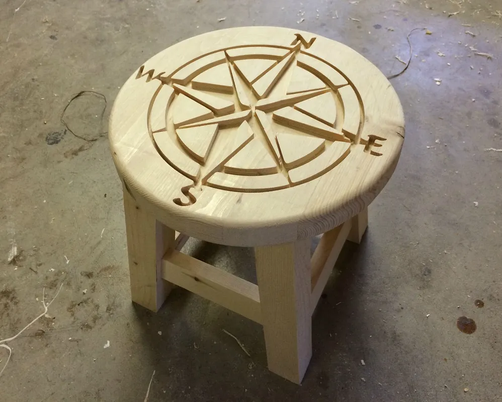

I'm using this step stool for standing on, not sitting, so I'm not worried about leaving imprints on butts/legs. However, if you want to use this for a small sitting stool, then consider either using the X-Carve to also cut perfect inlays or adding epoxy to fill in the design.
Apply whatever finish you would like. I decided to use a darker stain called Carrington by Varathane.
