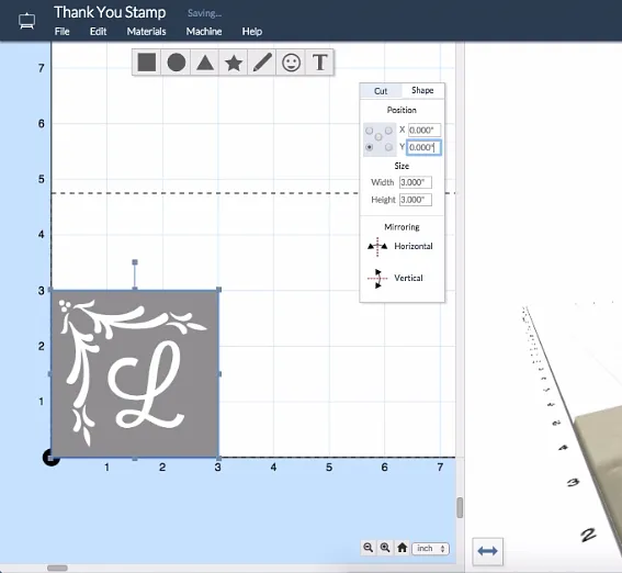

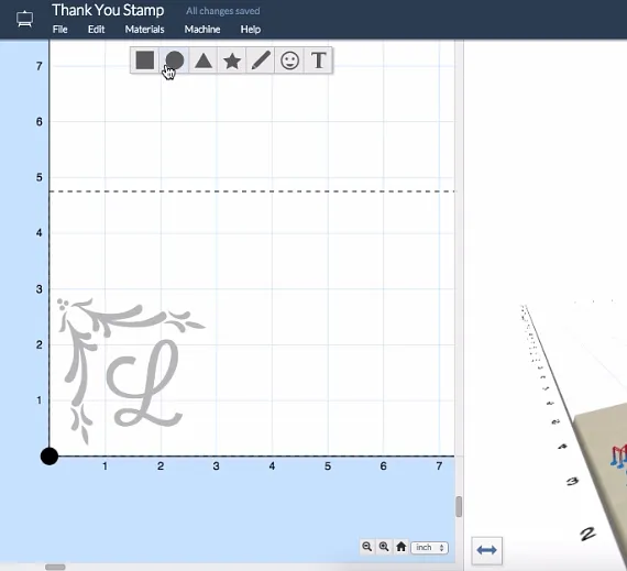

Add your design to Easel
Import a .SVG or create a design using the built in design elements and text.
Estimated time: 5 minutes
Creating the Backing
Add a shape element that fully encompasses the size of your design or the total size you would like the stamp to be.
Next you'll need to select and send this shape to the furthest back layer possible by using the menu system: Edit; Send Backward, or you can use keyboard shortcuts: cmmd + [

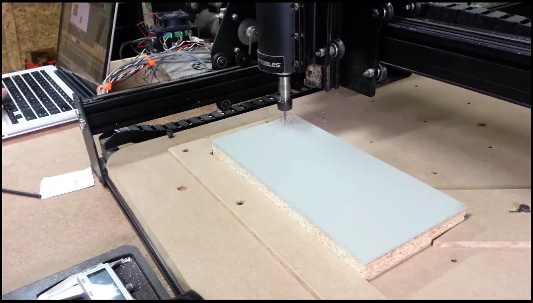

Carve!
Before caving quickly check your toolpaths to ensure all the details will be present after carving, once your pleased with the design get to carving!

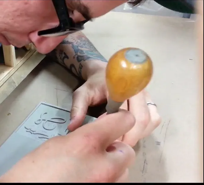

Clean Up
Once the carve is complete you may need to go over the stamp quickly with an awl or a nail to clear out the linoleum chips from tight corners and detailed areas.

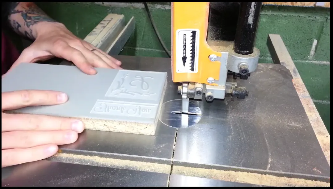

Cut the Stamp to final size.
This can be done using the machine but I encourage you to carve out the stamps on a larger piece of linoleum and cut them to final size once carving is completed using a bandsaw, table saw ect...

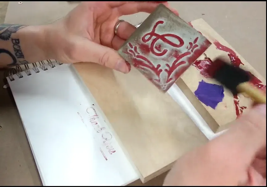

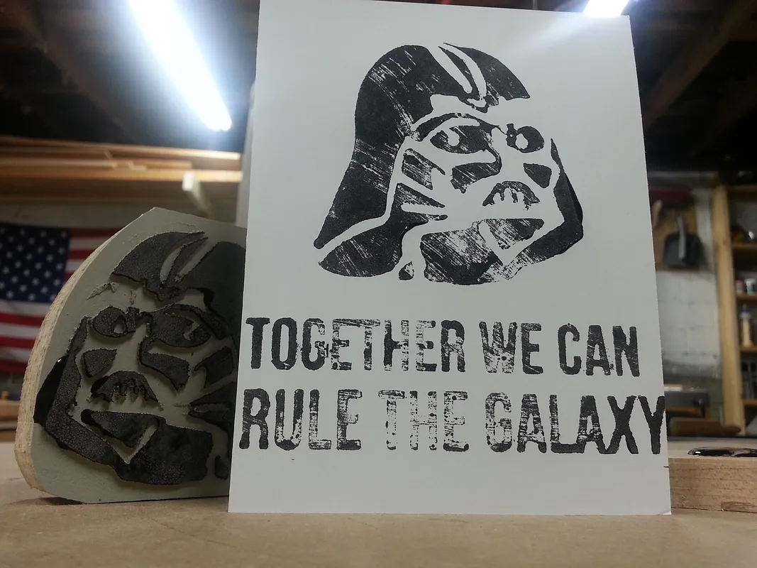

Get to stamping!

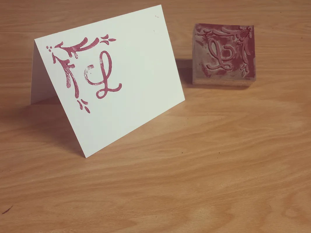

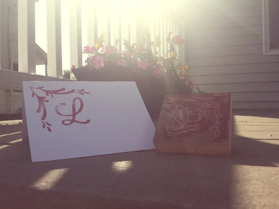

Now comes the really fun part, Stamping! There are several different brands and colors of stamp pads out on the market. I tried using pigment stamp pads but was a little unimpressed with the final result so I decided to give Acrylic craft paints a try and was far more pleased with the results as well as how many different sub straights it transfers to.

What kind of craft paint did you use that worked better than the ink pad?
Zach KaplanPro · June 22, 2015
Zach, I tried using a pigment ink pad and it worked but with images that were slightly more faded that I expected so I instead used Acrylic Craft Paint. The brand I used was Anita's, I'm sure any Acrylic paints would work fine though.
Travis Lucia · June 22, 2015
I do this and use speedball block printing ink.

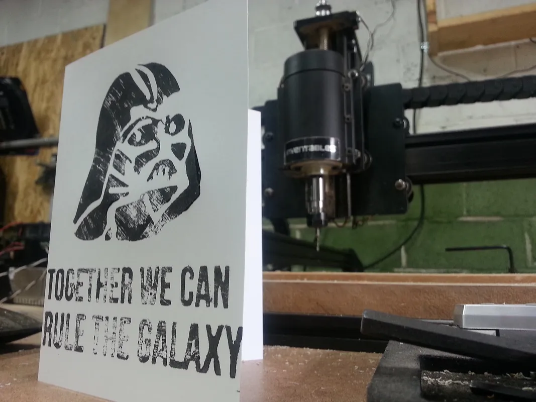

Awesome Job what did you use X Carve or Carvey
