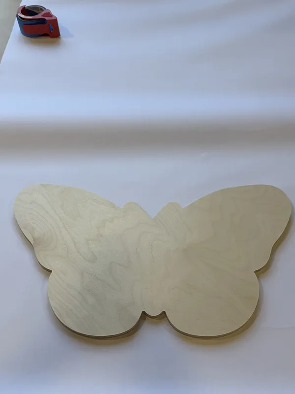

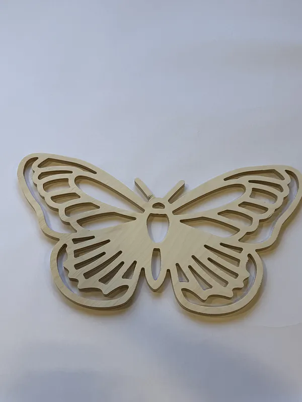

Layered Butterfly

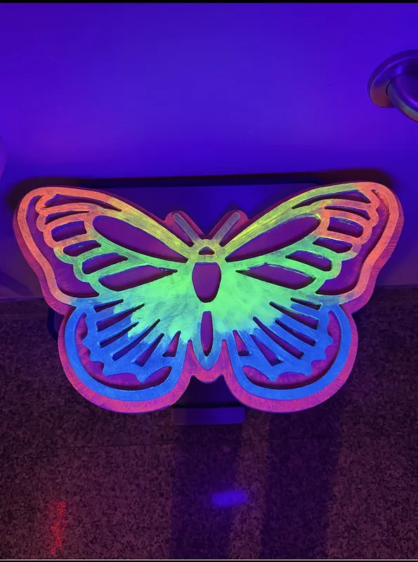

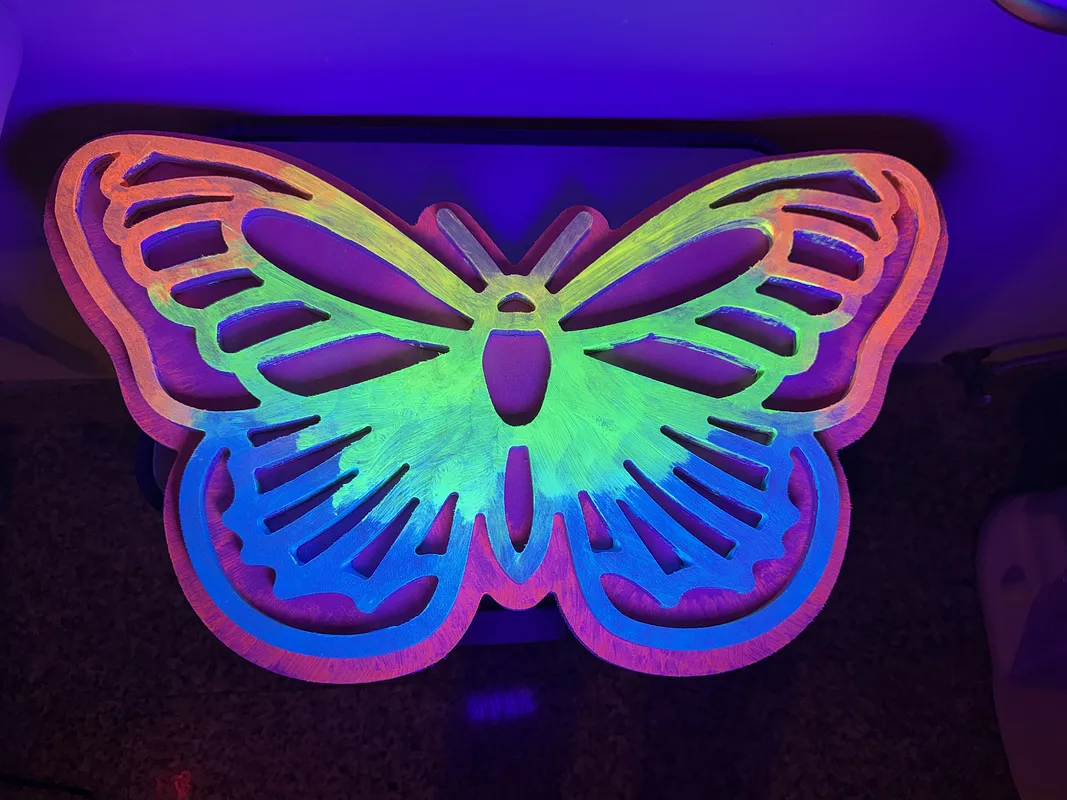

This layered butterfly was made to be one of many in a field. The butterflies will be mounted on black poles and painted differently with UV reactive paint. The perimeter of the field will have black light LED panels. The wings will be mounted at different angles to look like they are flying.

I want to make a field of these that are mounted on black poles. The idea is that each butterfly will be painted differently and have their wings at a different angle. Does anyone have any ideas for how to 1. Make it easy for people to cut wings that mount at different angles easily and 2. Mount the butterfly to a pole that can be easily bought at a big box store like Home Depot or Lowes or on Amazon?

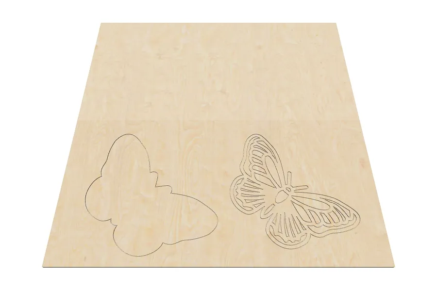

OK here's a 3 part version. Are you thinking the wire goes in the side thickness so maybe I have 2 on each side? easel.com/projects/xwWhB_7lCr3l2WiK5uF5-w
