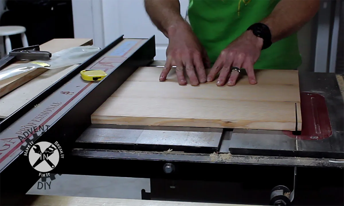

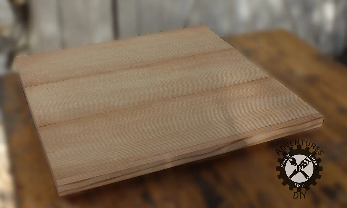

Gluing and Cutting the Board The final dimensions for this project will be 16"x16". You're going to * Cut and trim your boards for gluing up. Make sure you cut them larger than the final size. * Glue up the boards and let them dry overnight. * Cut the glued up boards to the final dimension of 16"x16" or whatever size you want.

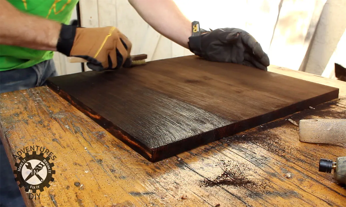

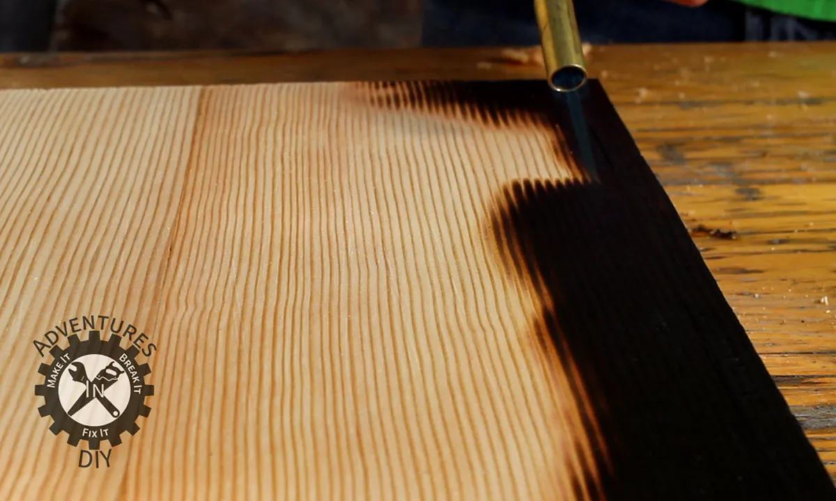

Burn the Wood You'll use one of those inexpensive propane torches to burn the wood. Don't be shy with this part. The idea is to burn the softer wood in-between the rings.

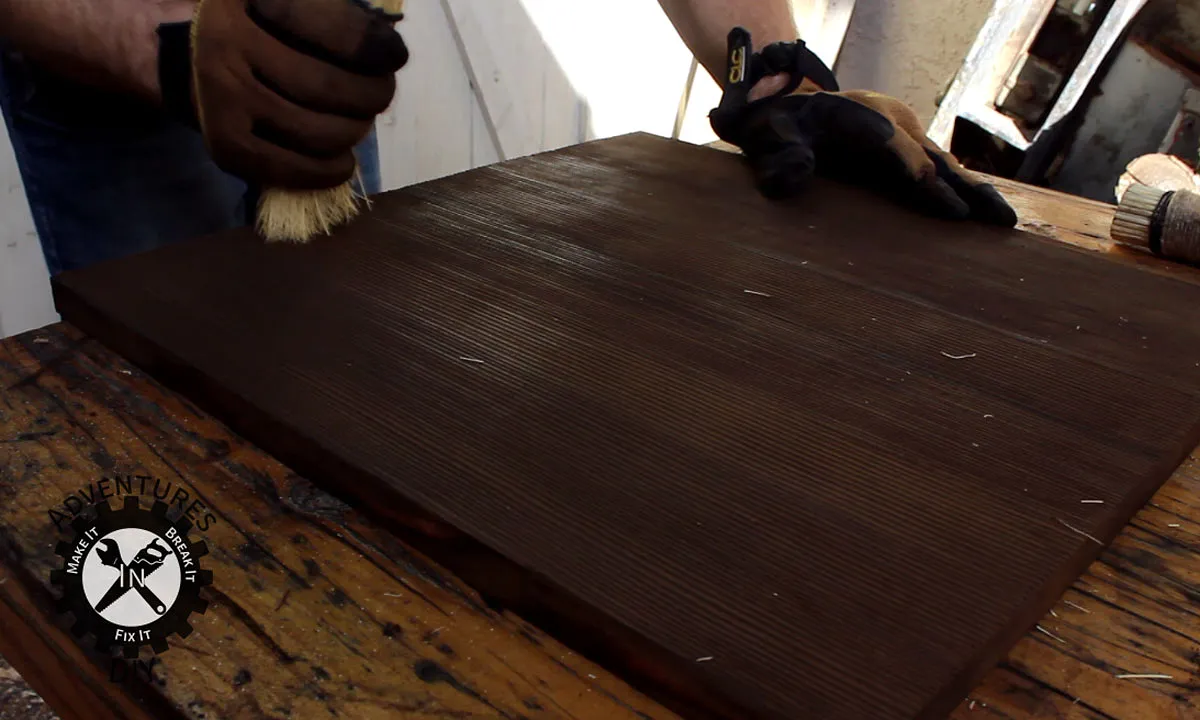

Brass Brush Time Moving with the grain, use a brass brush to remove the burnt areas. You should see raised areas as you remove the softer burnt parts.
Tip: When you're trying to figure out how much to remove, just remember that the wood will be about 2 shades darker when you apply finish.
Softer Brush Use a whisk brush or something similar to help get out the burnt dust.

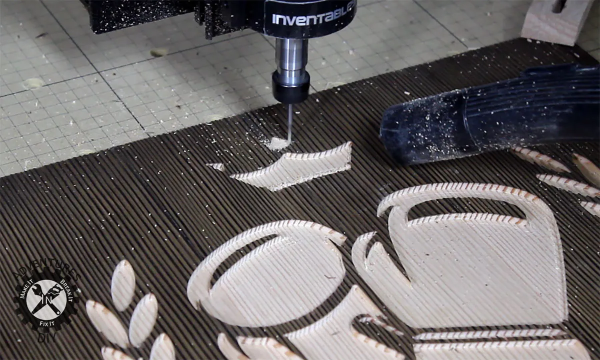

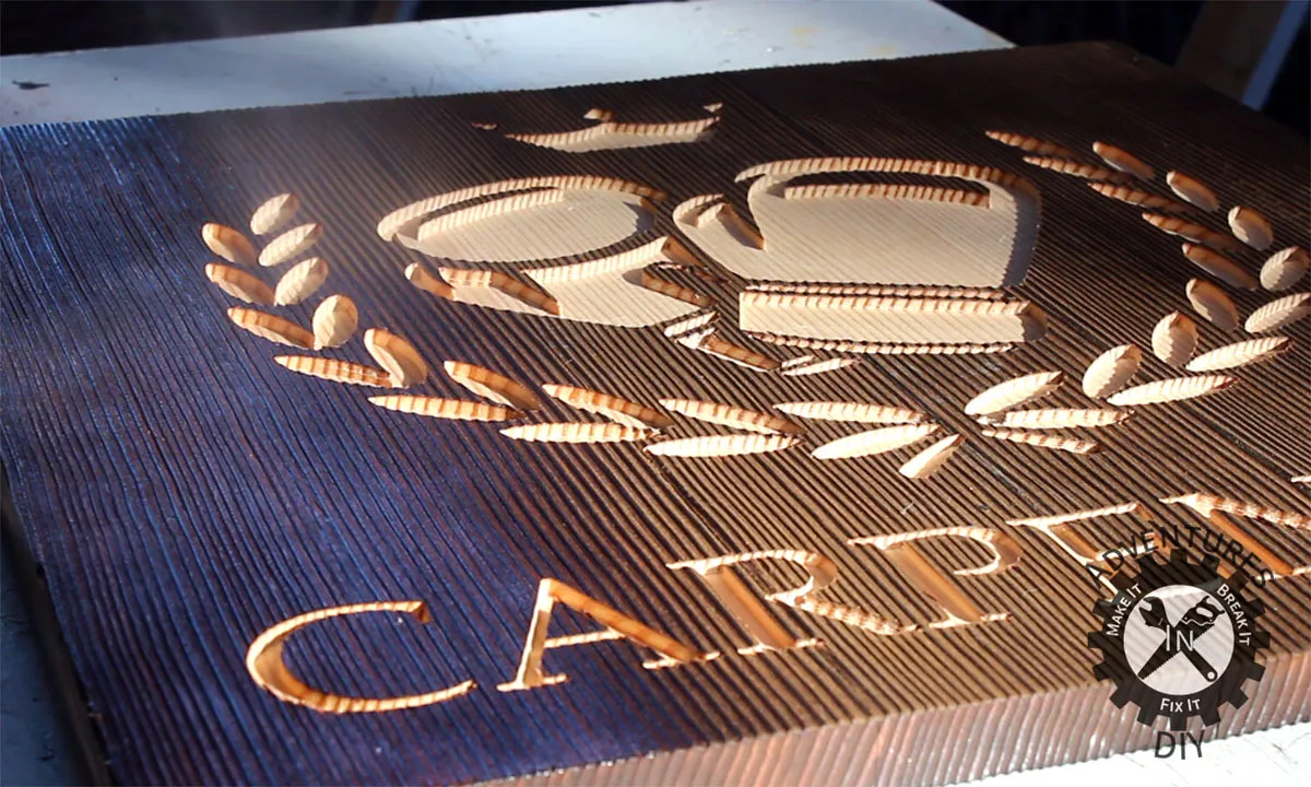

Carving

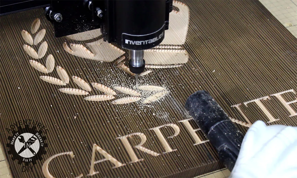

Settings * Material - Event though the wood is softer I used the default rate for Birch * 1/16" 1F Spiral Upcutting Bit * 1/8" Depth
Note: You can mess with the feed settings and depth per pass but remember Douglas Fir is a brittle wood and will chip out a lot if you are really aggressive. It's best to create a couple of test samples instead of guessing on your final board.

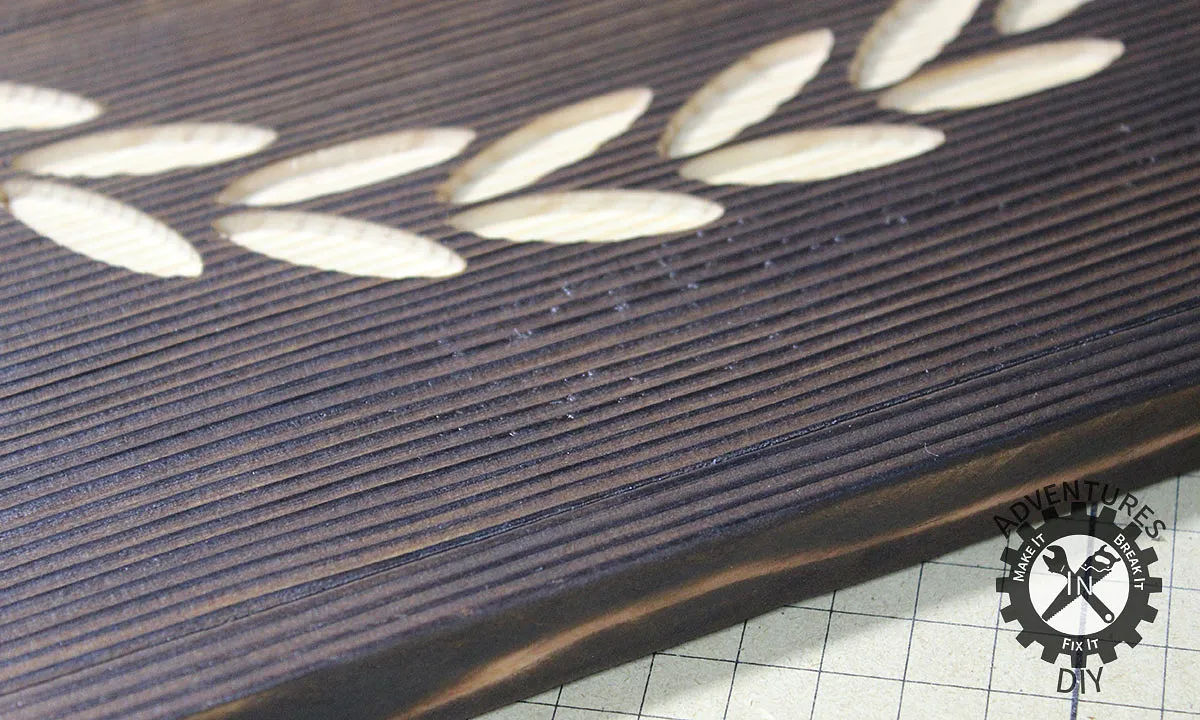

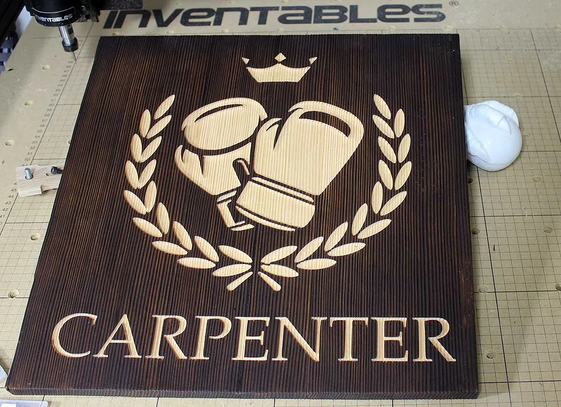

Protective Finish
In my project I used some spray water based satin polyurethane. This sprays on a milky white color and dries clear.
Just be aware if you use the oil based polyurethane it will add a yellowish color to the project and darken it more than the water based stuff.
Once the finish dries just add some hanging hardware and you're good to go!
