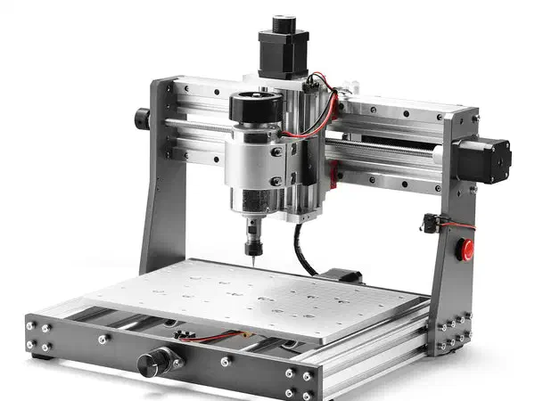

SainSmart Genmitsu 3020-PRO MAX machine photo
About the Machine
SainSmart no longer sells this model, but it remains fully supported in Easel. The Genmitsu 3020-PRO MAX has a 300 x 200 x 72 mm working area, a 300W spindle (12,000 RPM), and steppers rated 1.5 A (X/Y) and 1.8 A (Z).

Quick Specs
Cuttable Area
300 x 200 x 72 mm (11.8 x 7.9 x 2.8 in)
Spindle Power
Stepper Motors
XY 1.5 A, Z 1.8 A
Drive System
Linear rail guides on all axes; lead-screw (T-nut) drive
Controller
GRBL 1.1f (A4988 stepper drivers)
