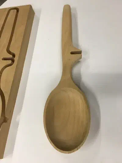

The spoon has a carved bowl, the tongs have two flexible arms, and the cake knife uses separate handle pieces. Pick the job you want the wooden tool to do.

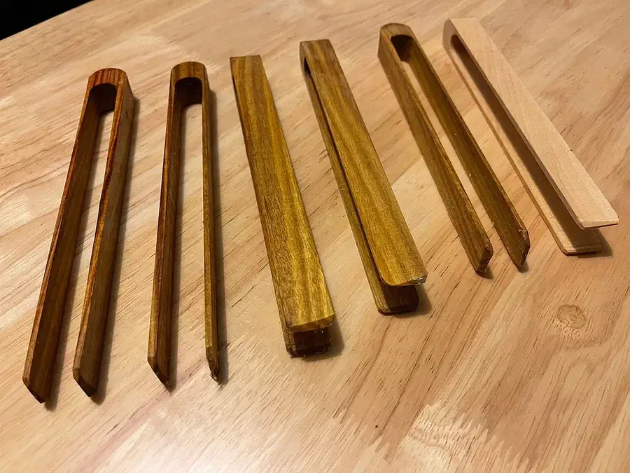

Keep the tong blank intact and choose the handle detail
The gallery comments are open to read. Sign in to discuss the tong cut order or cake-knife assembly with the community.

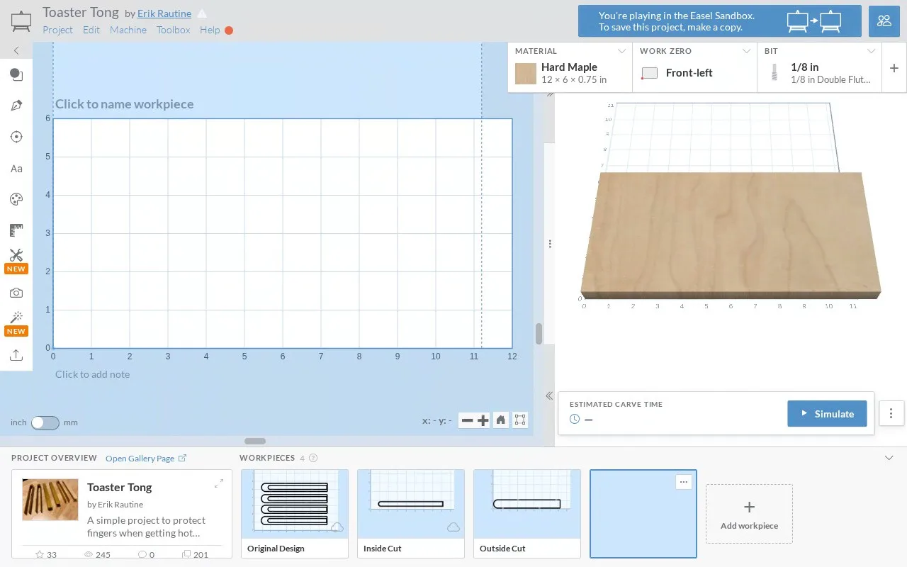

Cut the inside before releasing the tongs
For a two-pass carve, Erik cuts the inner opening first and the outside second, keeping the same XY zero. That order keeps the blank intact while the narrow opening is cut. Use his separate Inside Cut and Outside Cut workpieces for that approach.

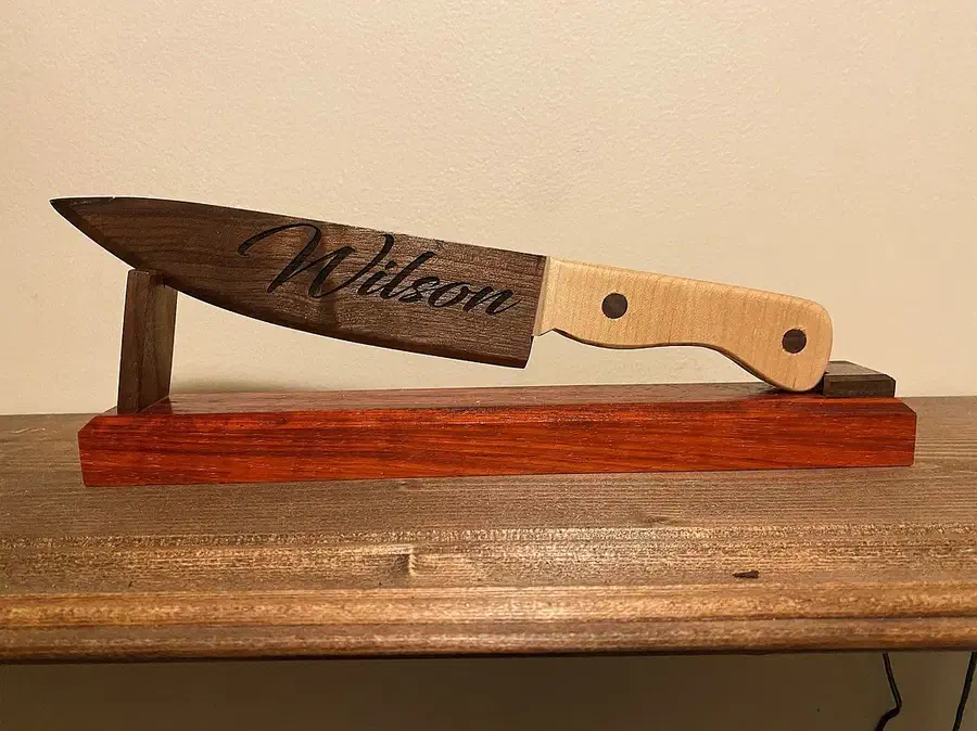

Use dowels for the handle detail you want
Johnathan says doweling the handle is optional; he adds it because he likes the look. His sequence is to cut, glue and shape the wooden parts. You can keep the handle plain or include that visible dowel detail when you assemble it.
