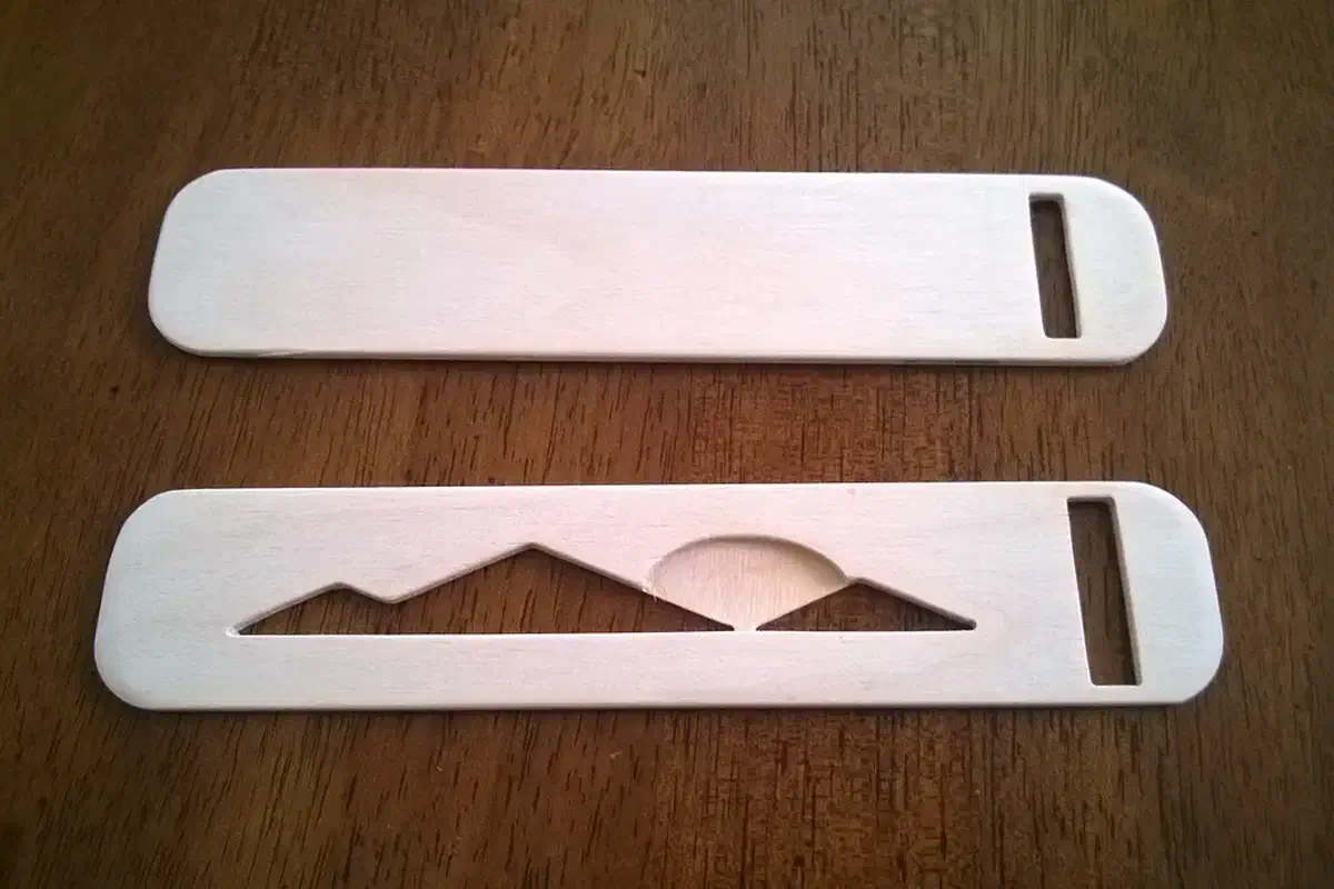

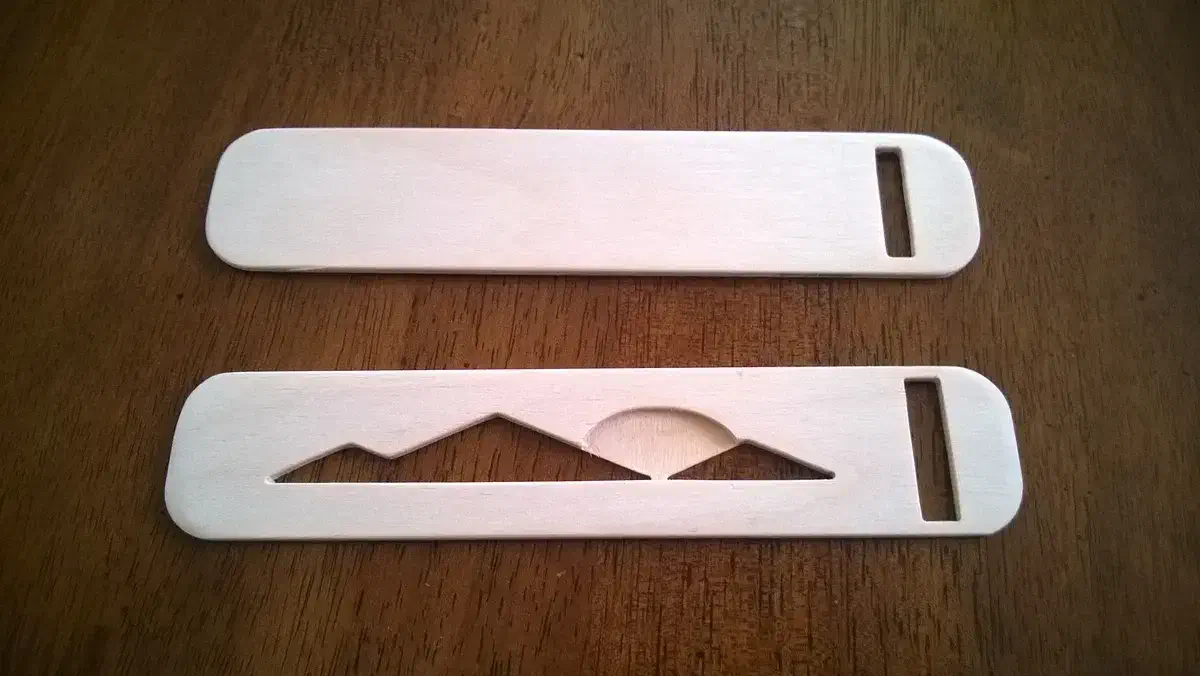

Make a thin plywood bookmark that can hold a book closed with a separately sewn elastic loop. Brian Wharton’s plywood-and-elastic project is the construction reference; the recording draws the wooden part in Easel, not the elastic.
Recorded in the Easel editor, playing at 1× real speed.
First add a square in Easel, unlock its proportions and resize it to a 1½ × 6-inch bookmark. Round the corners to 0.2 inches and choose an outside cut through the example’s ⅛-inch birch plywood.
Next add a 1⅛ × ¼-inch rectangular slot near the top, leaving wood around every side. Choose an inside cut through the plywood and turn tabs off for the slot; keep holding tabs on the outer outline.
After cutting, remove the outer tabs and slot offcut, then sand the edges. Thread separate elastic through the slot and sew it into a loop around your book, as Brian describes. Match the slot to your elastic first: these example dimensions are not a tested strap fit or a ready-to-carve workholding setup.

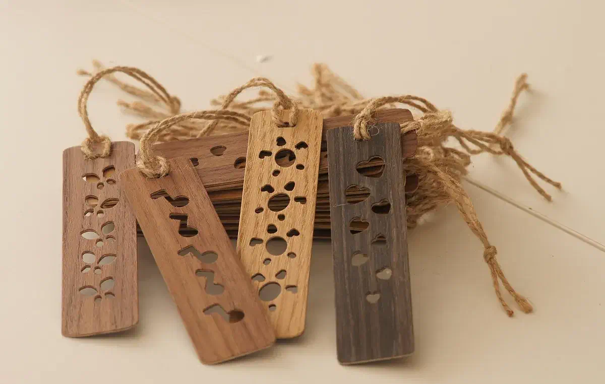

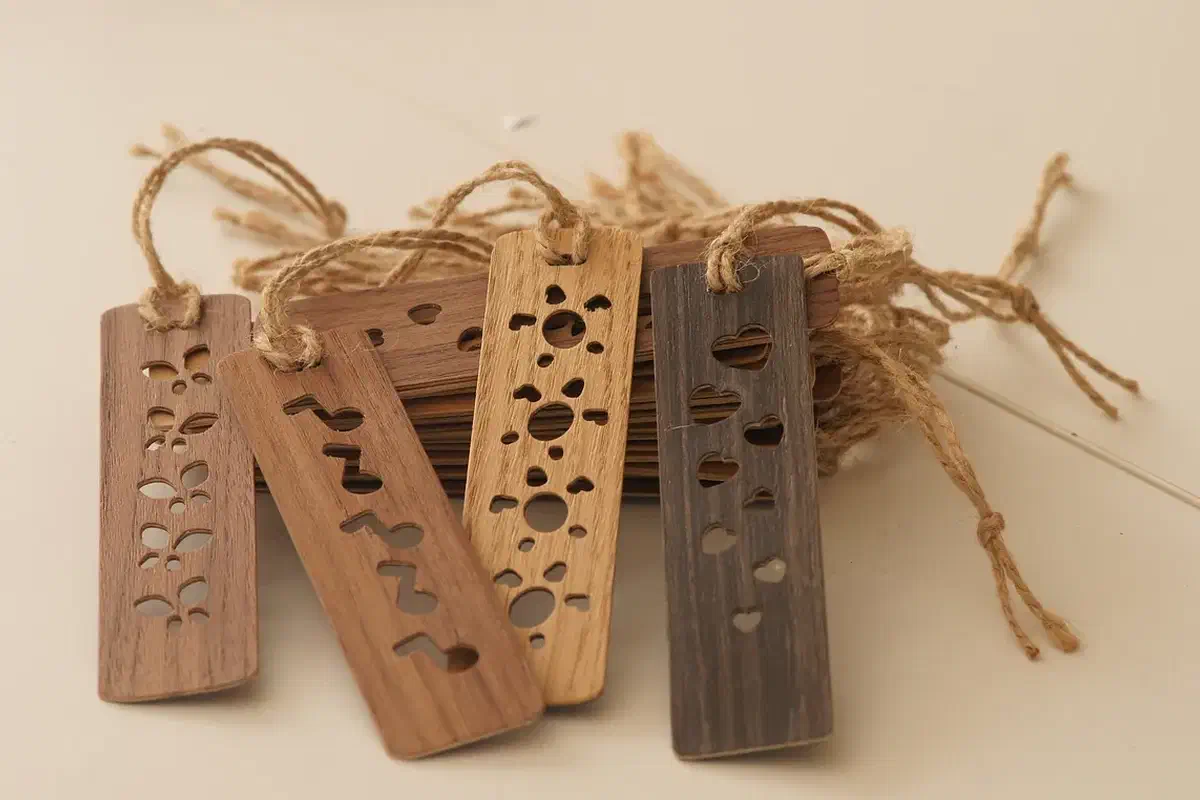

Brian’s slot accepts a sewn elastic loop that wraps around a closed book. Antonello’s veneer bookmarks sit between pages and use a small top opening for a separate cord tassel. Choose the closure for carrying a book, or the layered pattern for a simple page marker.

From Brian’s cutting instructions
Hold the outline, not the slot offcut
Brian’s project discussion can be read publicly; log in to post a comment.
Put tabs on the bookmark edge only
In “Cut out the bookmark,” Brian Wharton says to use tabs on the outer outline but not in the slot for the elastic. He describes cutting a plain marker and another with his company’s logo from ⅛-inch craft-store plywood.
