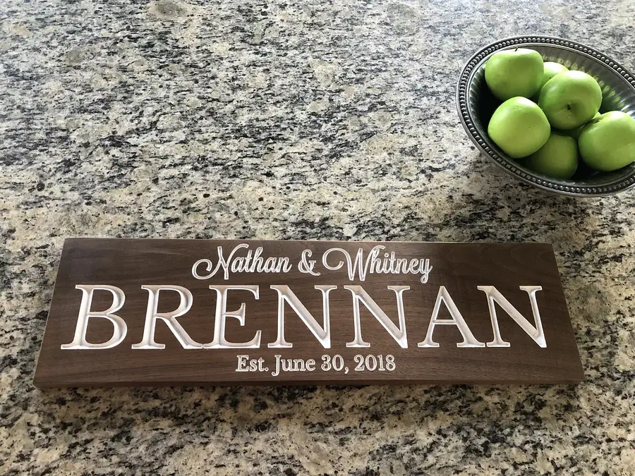

V-carved lettering can hold fine strokes, but the angle and depth change how wide each cut becomes. Check the thinnest letter and border detail, then carve a scrap sample before using the final board.

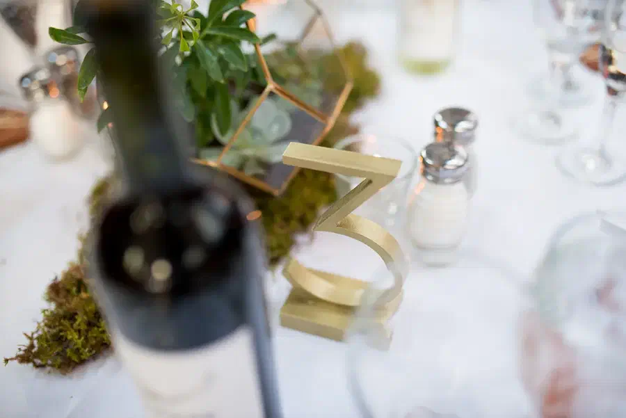

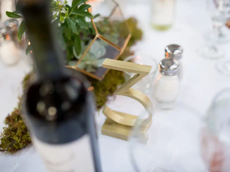

Sheet goods rarely match their labeled thickness exactly. For standing numbers, measure the MDF or plywood with calipers and adjust the base slot in the Easel project before cutting a full set.

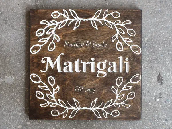

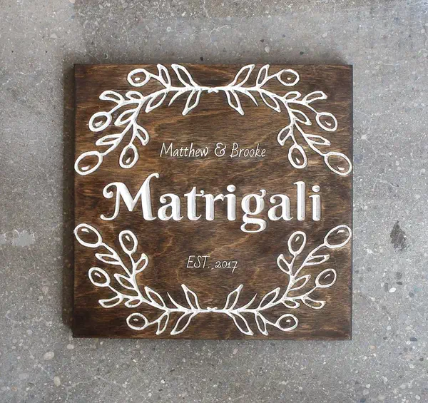

The sign makers sealed the surface before adding paint, then sanded the face to remove the excess. Test the sealer, paint, stain, sanding sequence, and clear coat together on scrap so the lettering stays crisp and the wood keeps the color you want.
