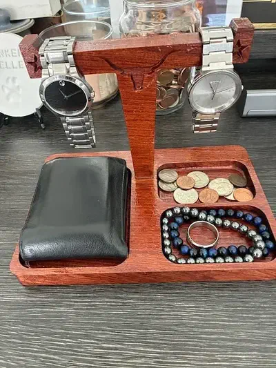

A reddish wooden watch stand with two metal-band watches, a wallet and coins in the base tray Longhorn watch caddyby Ex31:3 Workmanship
A longhorn detail sits under the crossbar of this tabletop caddy, beside pockets for a wallet, coins and jewelry. The shared file has numbered carving steps for the tray and hanger, plus a detail option without the longhorn. Follow the numbered steps for the parts; two sketch tabs are reference layouts rather than cutting steps. The decorative longhorn pass uses V-carving, which requires Easel Pro.

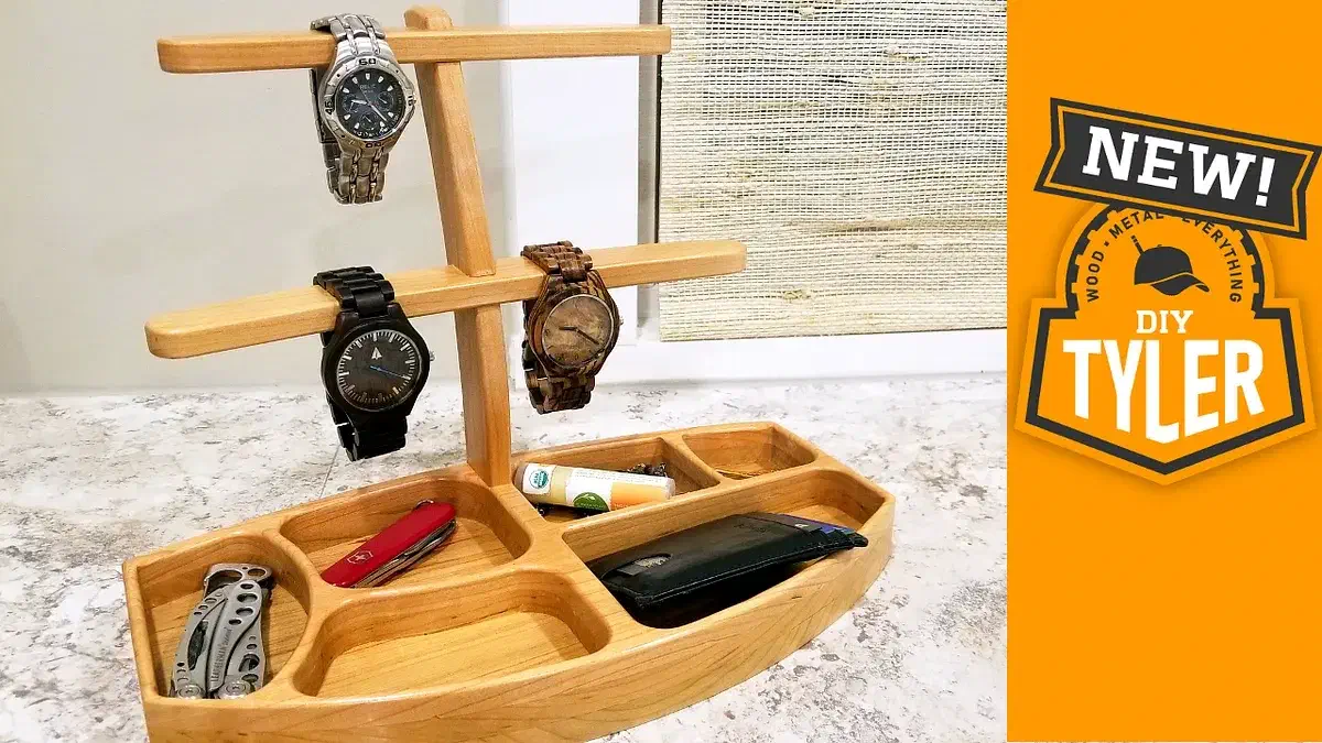

Sand a tray’s layers before joining them
Keep the solid bottom and pocket layer separate until their inside edges are smooth. On DIYTyler’s display, this gives you access to the divided tray before assembly. Sand those surfaces while you can still reach them, then join the layers.

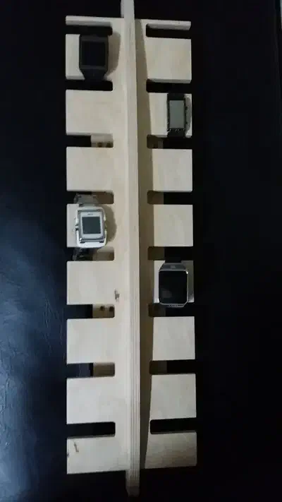

Countersink the rack’s assembly screws
Antonio Santiago countersinks the screw holes in both plywood pieces, then slides the notched pieces together and attaches the wall-hanging piece. Recessing the screw heads keeps them from projecting above the wood. His photos show where the pieces meet, so use the illustrated sequence alongside the shared layout.

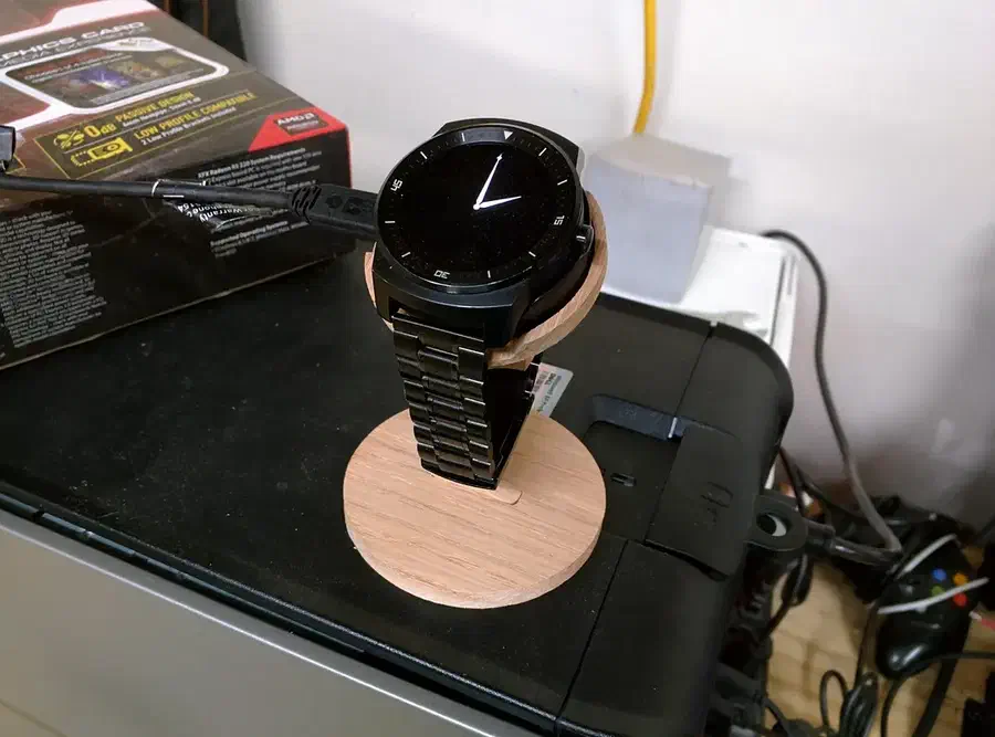

Test the cradle before cutting every part
Kalvin Daniels notes that his watch cradle is a little loose. Cut a small fit sample around the watch or charging puck before making the rest of a model-specific stand. Adjust the opening after that test, then cut the matching upright and base.
