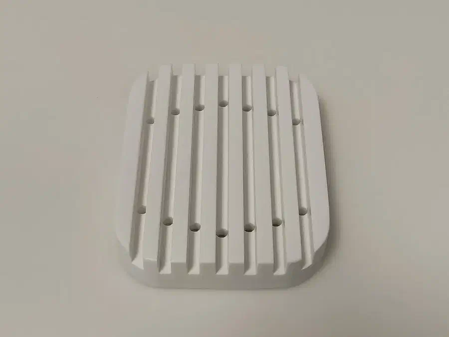

Locate both faces from the same reference
Steve Gale uses markers or a jig to put the Corian blank back in exactly the same position after flipping it. He sets the work origin at the center, carves the underside first, then turns the blank over for the top. Keep the locating reference fixed for both faces.
Project notes by Steve Gale: read the source.
From Corian Soap Dish by Steve Gale.

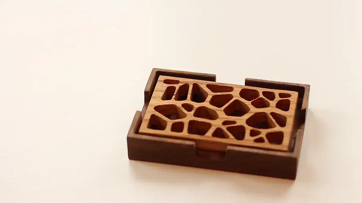

Find the tray beneath the patterned insert
Thomas Quinn keeps the recessed base on a second workpiece tab. After looking at the open insert, select the next tab at the bottom of Easel to see the matching tray. The two pieces are carved separately, so choose the wood for each before starting.
Comment by Thomas Quinn: read the source.
From Wood Soap Dish by Thomas Quinn.

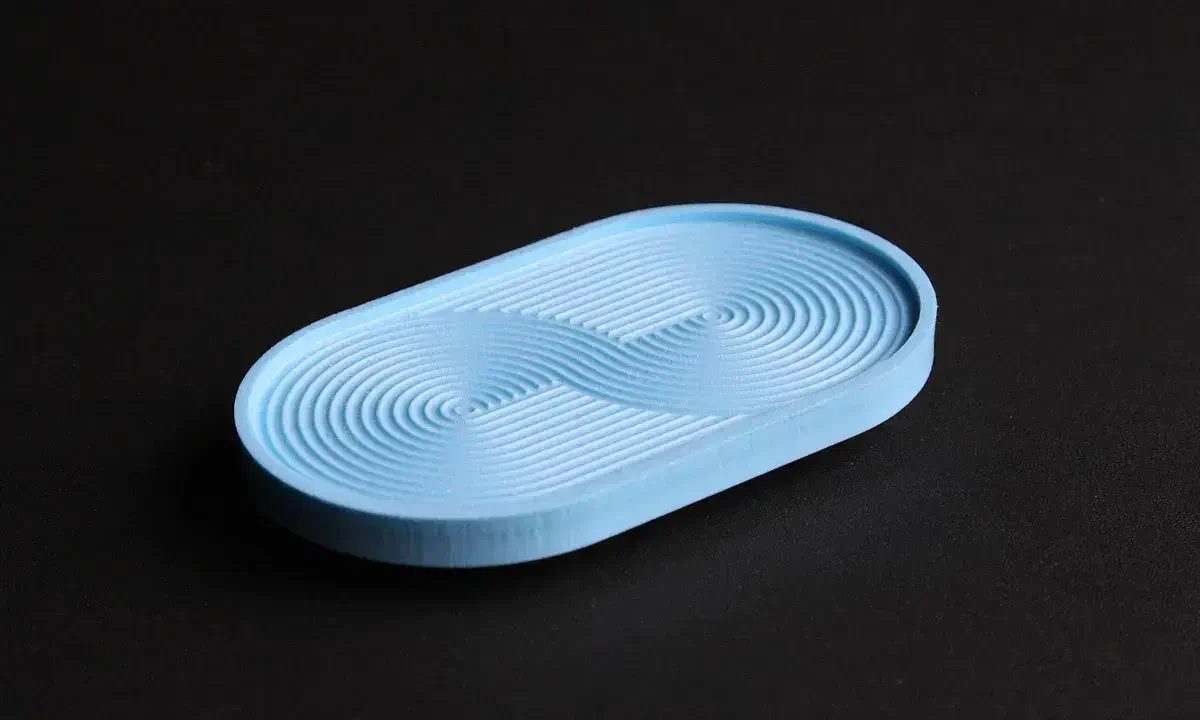

Choose channel depth before carving the pattern
Beyond Design uses a 1/8-inch ball-nose cutter for the curved channels. The maker’s notes explain that a shallow cut can leave gaps between grooves, while a deeper cut makes taller, brittle edges. Check the channel depth against the cutter and material before running that stage.
Project notes by Beyond Design: read the source.
From Soap Dish by Beyond Design.
